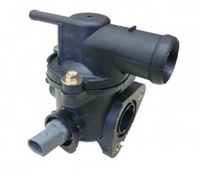

Replace the ECT sensor as well as the the thermostat.

No, a faulty ECT sensor will affect the car starting when cold too.
The part number for the full thermostat housing complete with thermostat and sensor is 047121111S

Replace with part number 047121111S and then see if the problem goes away. If not you can look further but the ECT sensors do tend to fail.

Now I was checking prices of thermostat (whole) in my country original part (mede in Czech republic) costs 26.55 euros (so 24.5 pounds) and that isn't so bad

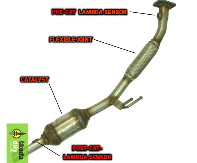

There is only one catalytic converter but two lambda sensors.

Ok my bad. One lambda probe have been changed (1,2 years ago I don't really remeber) however the other one not. Could it be it ? But probably not because lambda probe starts it function when the engine is (at least a bit) warm and not right at the start. Am I right ? In Monday car is being sent to service - thermostat finally came so it is going to be replaced (whole thermostat body) so I will tell you how it went,
