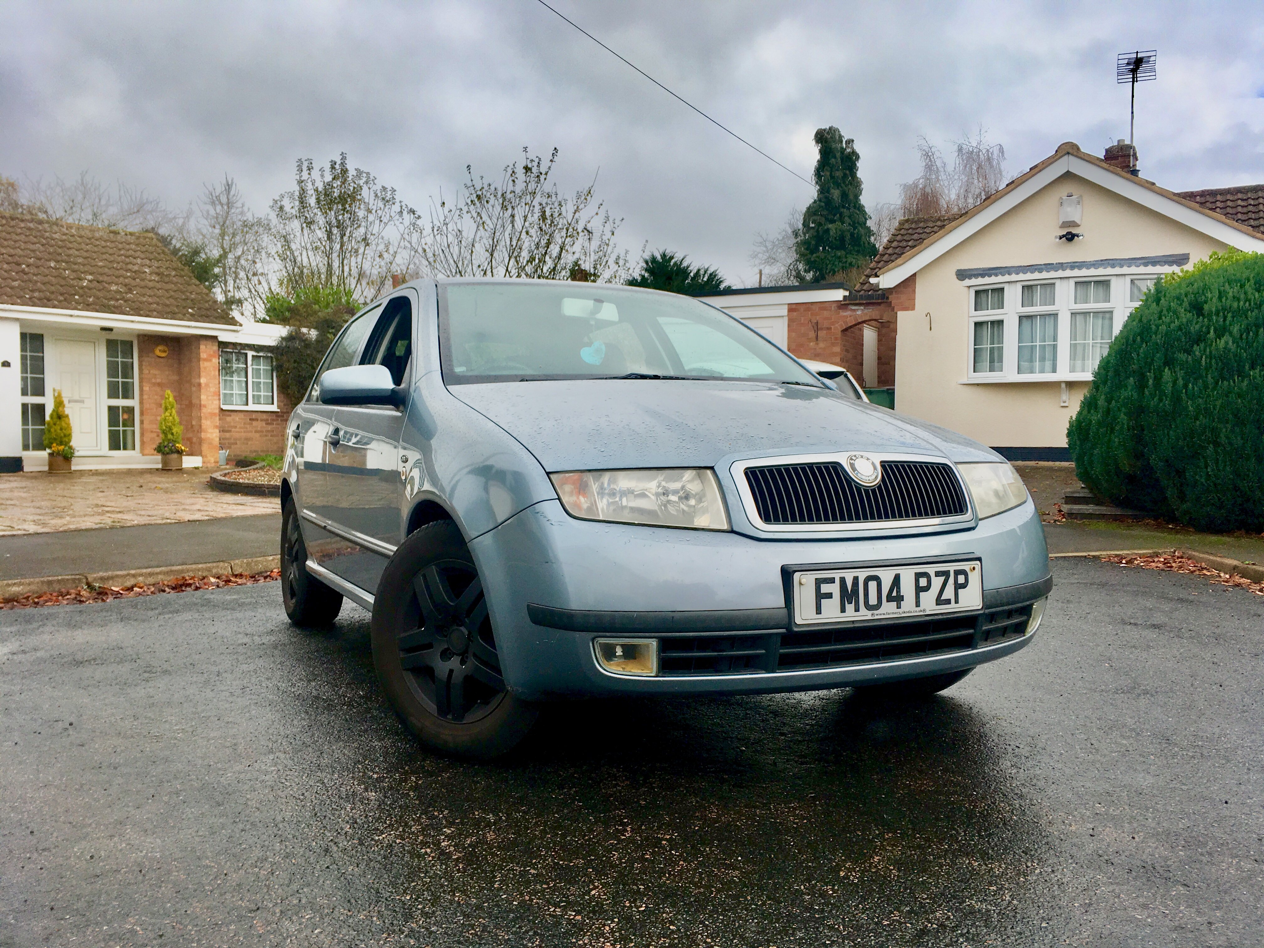

Anyway, I have a few questions regarding a Fabia I just picked up. One thing stood out during the inspection. I was looking around, checking the tyres and all that but when it came to the brakes I noticed that there are discs on the rear. Now, I don't often see MK1s with rear discs. Could this have been a previous conversion? Also the wheels are seemingly aftermarket. Now I'm not exactly bothered by them but given the tyres (Pirelli and Contis) I can only imagine that the previous owners seemed to quite enjoy driving a little 'spritedly' (as do I) and am wondering if anyone knows which alloys they may be. They're painted as on one of the wheels it's coming off. Also, the front passenger door will not unlock and as such will not open. It has previously been worked on and I've had the door card off including the metal shielding to try and find the issue. Looks like I'm going to have to inspect a bit further though as there's no physical 'poppy' lock. Does anyone know if this is a common problem with these cars? It is an ATD 1.9 TDi PD100 if that helps - and yes I'm fairly sure it's had a remap or something as it's a bit quicker than my '08 1.9 TDi PD105 MK2.

Thanks everyone. Still wondering about the wheels though as I'm not sure if they're worth keeping.
Oh yeah, I have a feeling it's been remapped as it is a slight bit quicker than the remapped PD105 I'm used to, and you can really feel that difference.
I can have no opinion about your wheels, the link is broken so I've no idea what they look like.
Crap. Here ya go.
