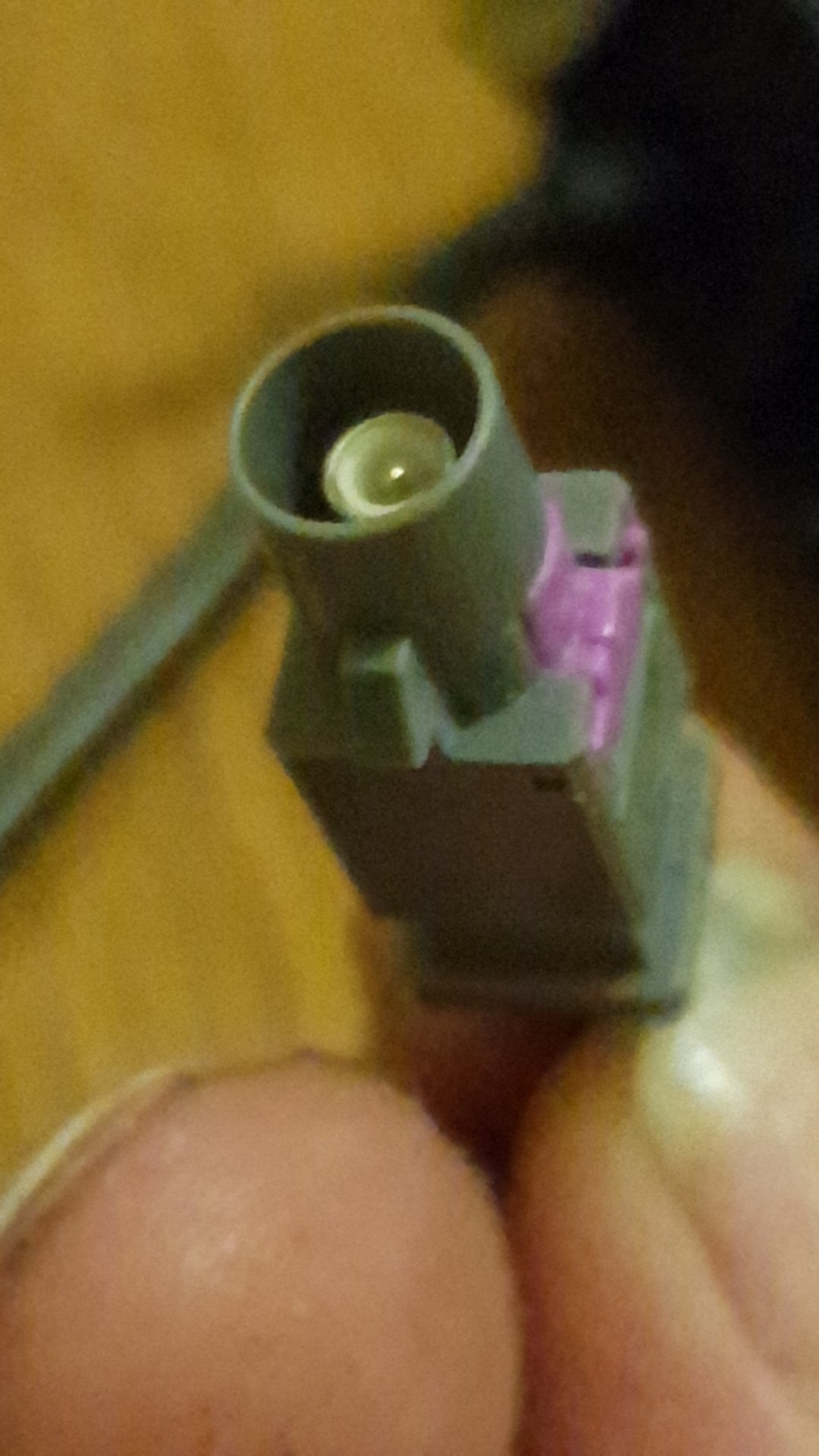

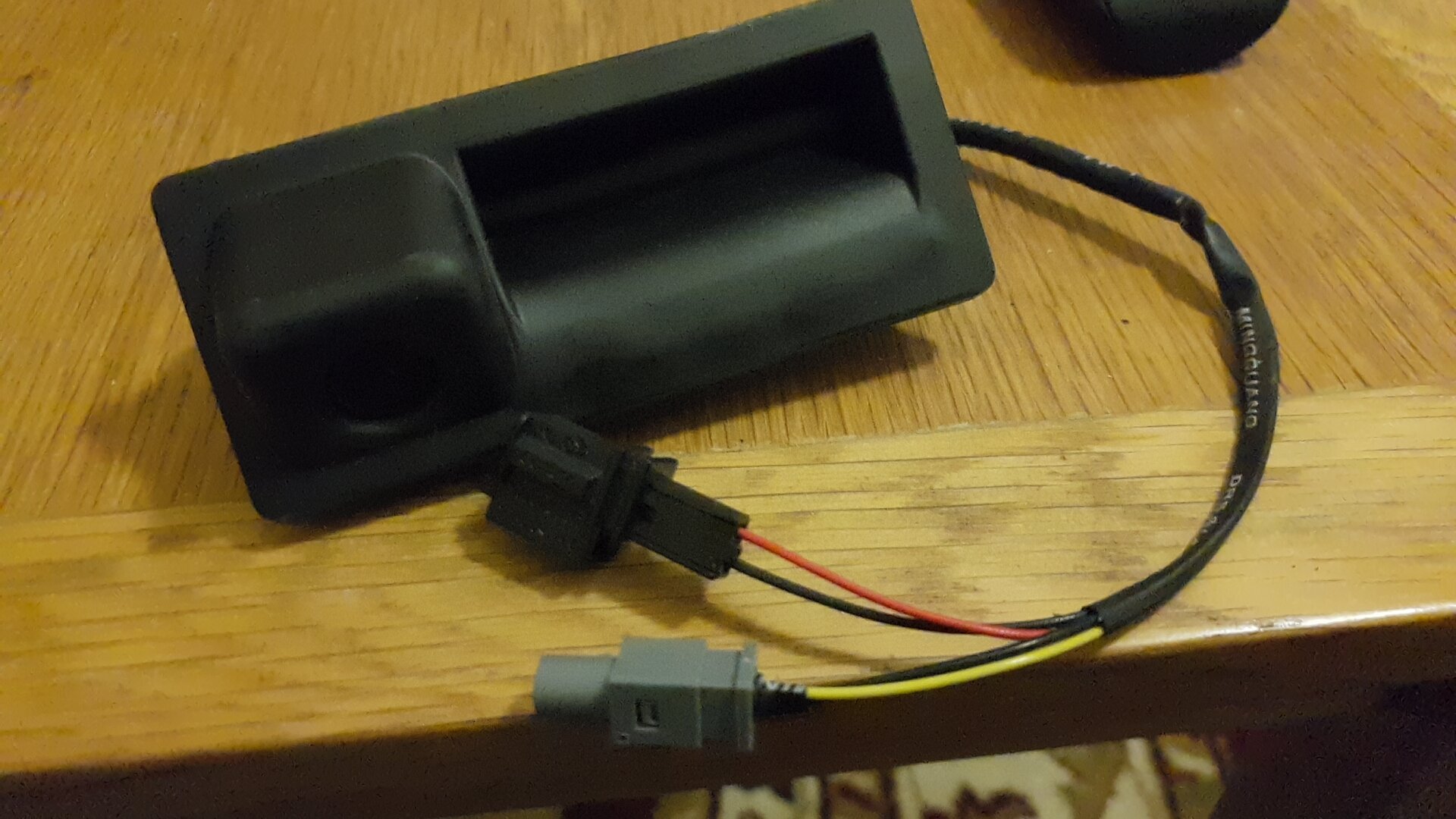

cananyone tell what this conection is called, i.e fakra ect
The camera and boot trigger are off a vw tiguan

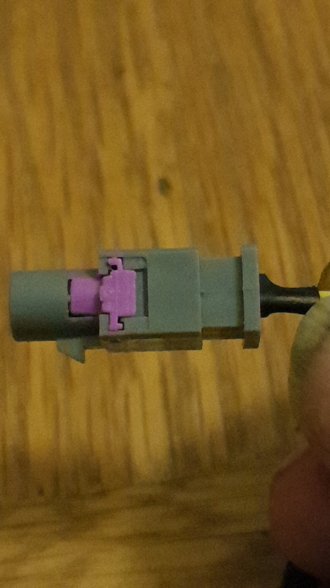

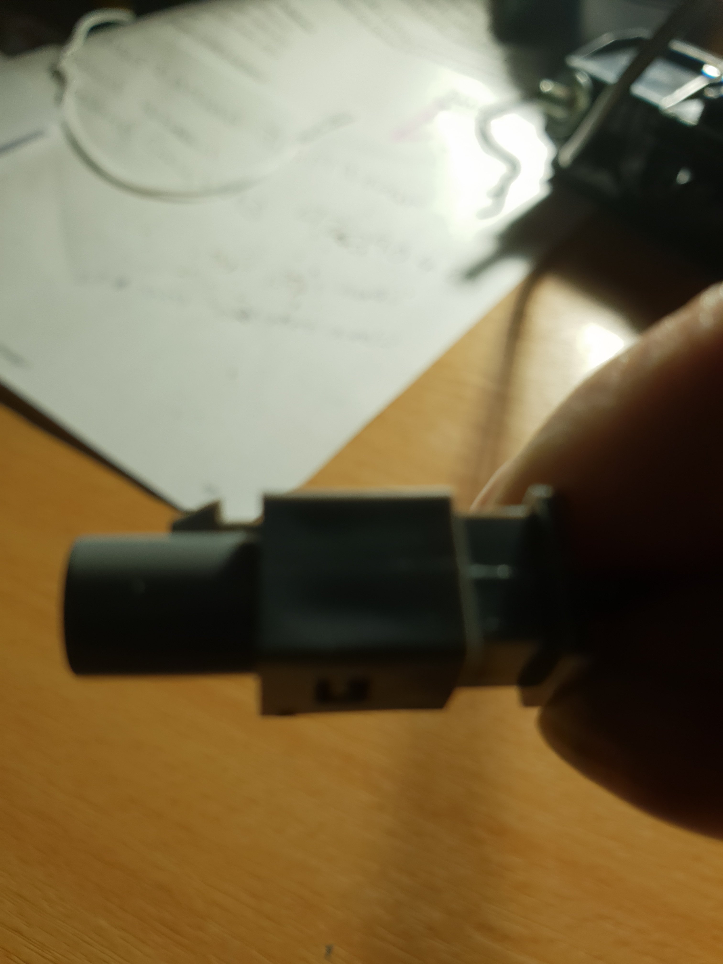

Does it have any markings or a part number to identify it?
will have a look:thumbup:
Nothing like asking a question and completely changing the picture ;)
Yes, that's a fakra connector. A guess, it'll be a 'Z' keyed version as I can't see any lugs on it...

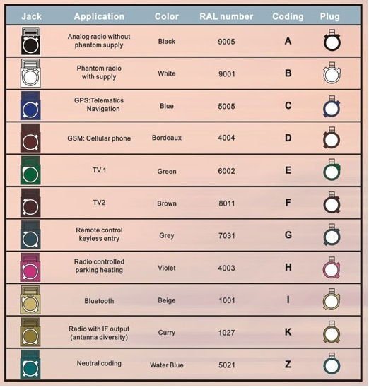

The parts you need are in this guide :
And this shows the Fakra connections.
