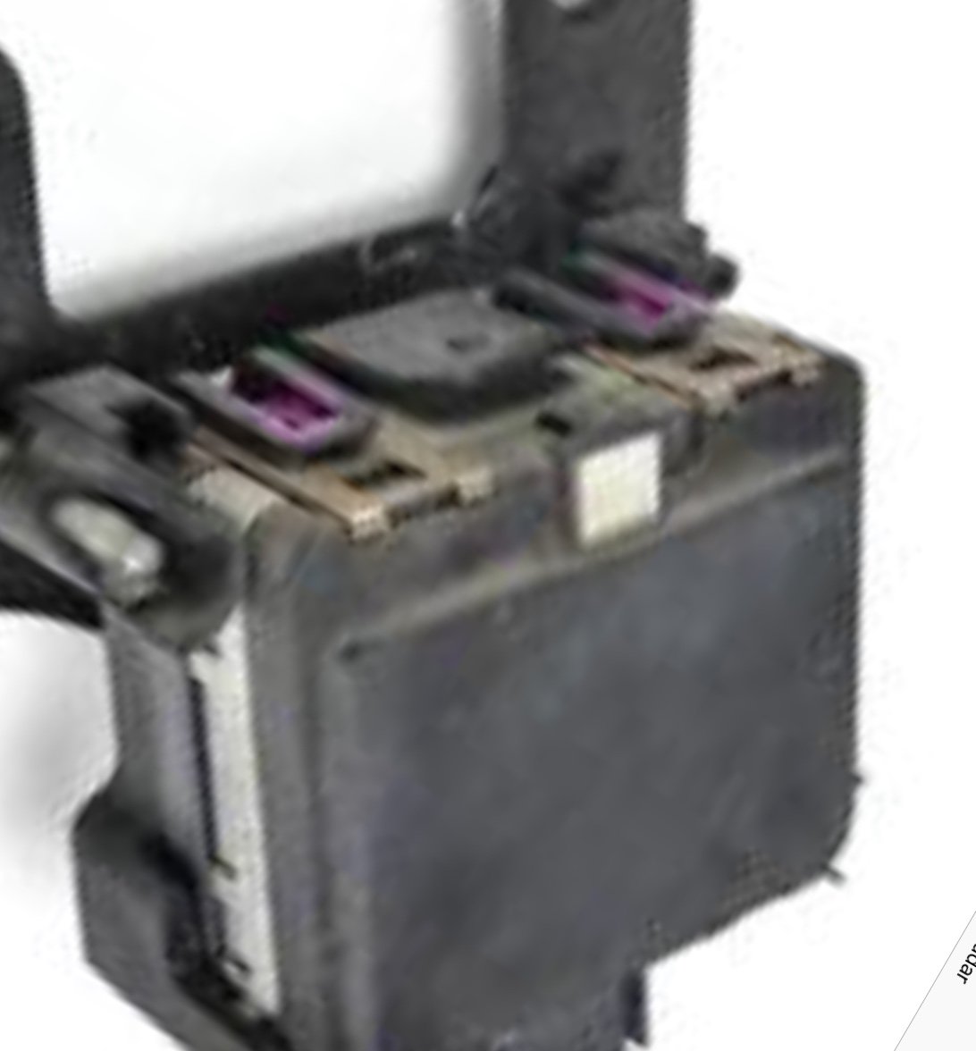

The radar sensor is behind a cover that needs to be removed to calibrate it, as you have to measure the distance from the face of the sensor to the reflective "target" placed a set distance in front.
I'll be calibrating mine tomorrow all being well as I'm gong to see some new to the UK aftermarket kit.  If they have the right parts to do Skoda I'll do mine and get pictures so that you can see what happens.

its a tiny 5 mm square piece of glass mirror at the top of the sensor, you have to lay down flat and look up to see it, mine had a crack in it rendering my acc and cruise control lane assist dead.

The white square at top of sensor on mine is made of a glass type mirror, not covered in any way.

The little mirror has nothing to do with the functionality of the sensor, it is just there for alignment during the calibration process (you can buy replacement mirror squares)
