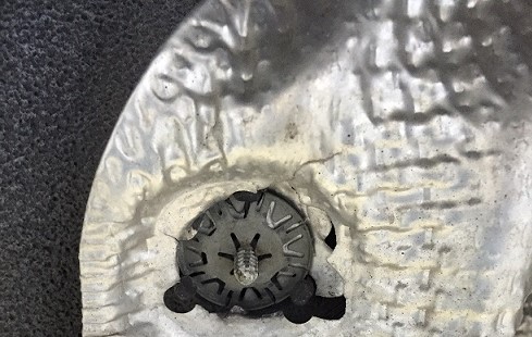

They won’t be big enough anymore, the original “hole” on the shield has corroded so it’s larger that it was
  • Sponsor

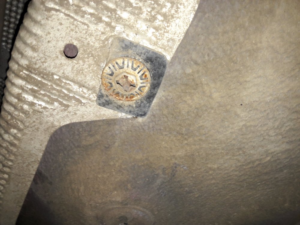

Yes they will. You drill a small hole in your tin lid then trap it up against the heatshield with the normal star nut thingy.
  • Sponsor
Like this: (but my tin lid isn't a tin lid)
