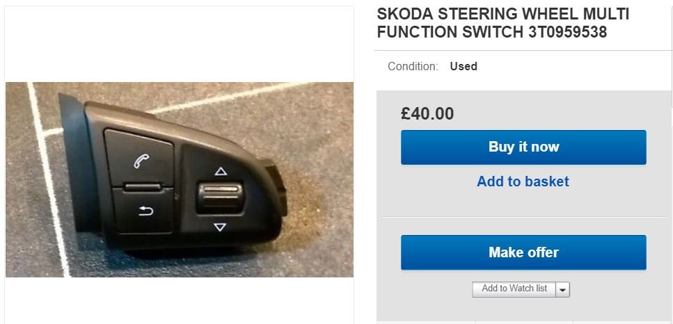

Most obvious would be a faulty button...
Thank you made an offer :biggrin:
The new switch is now on its way! To fit does anyone know if it just pops out and plug in or will the whole steering wheel need to be dismantled?

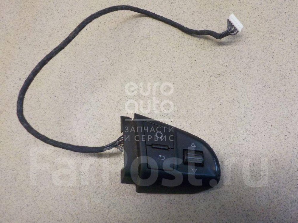

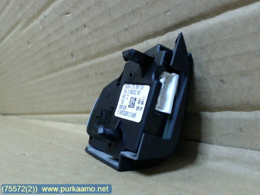

The length of the cable might suggest its a 'wheel off' job...
Unless you can disconnect the cable from off the back of the switch and therefore utilise the existing cable?
Should be possible if these images are accurate...
Edited by silver1011
I think it's just an airbag off job.
That wire is just between the two sets of switches if I recall...
