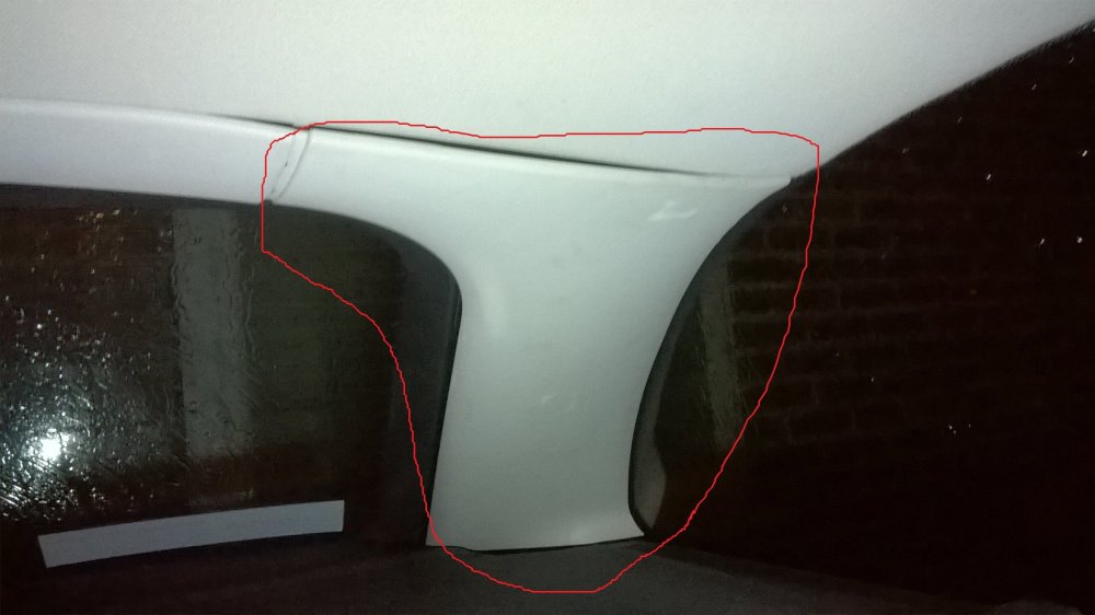

I ended up taking off the rear panel in the tail-lift and couldn't find evidence of either water ingress (as mentioned by some) or loose connections. THEN I started to look at the inside of the main car surround to the boot opening and removed a plastic clip-on panel to the right of the door (looking from the inside the car towards the rear). Lo and behold; there was a wiring loom going from the car, then vanishing through a SHARP EDGED punched out hole to go through the elephants trunk to the lid.
Long story short: Pulled wires clear of the metalwork, secured large felt pad as padding against the sharp edge, put everything back - no trouble since (about a year ago).
