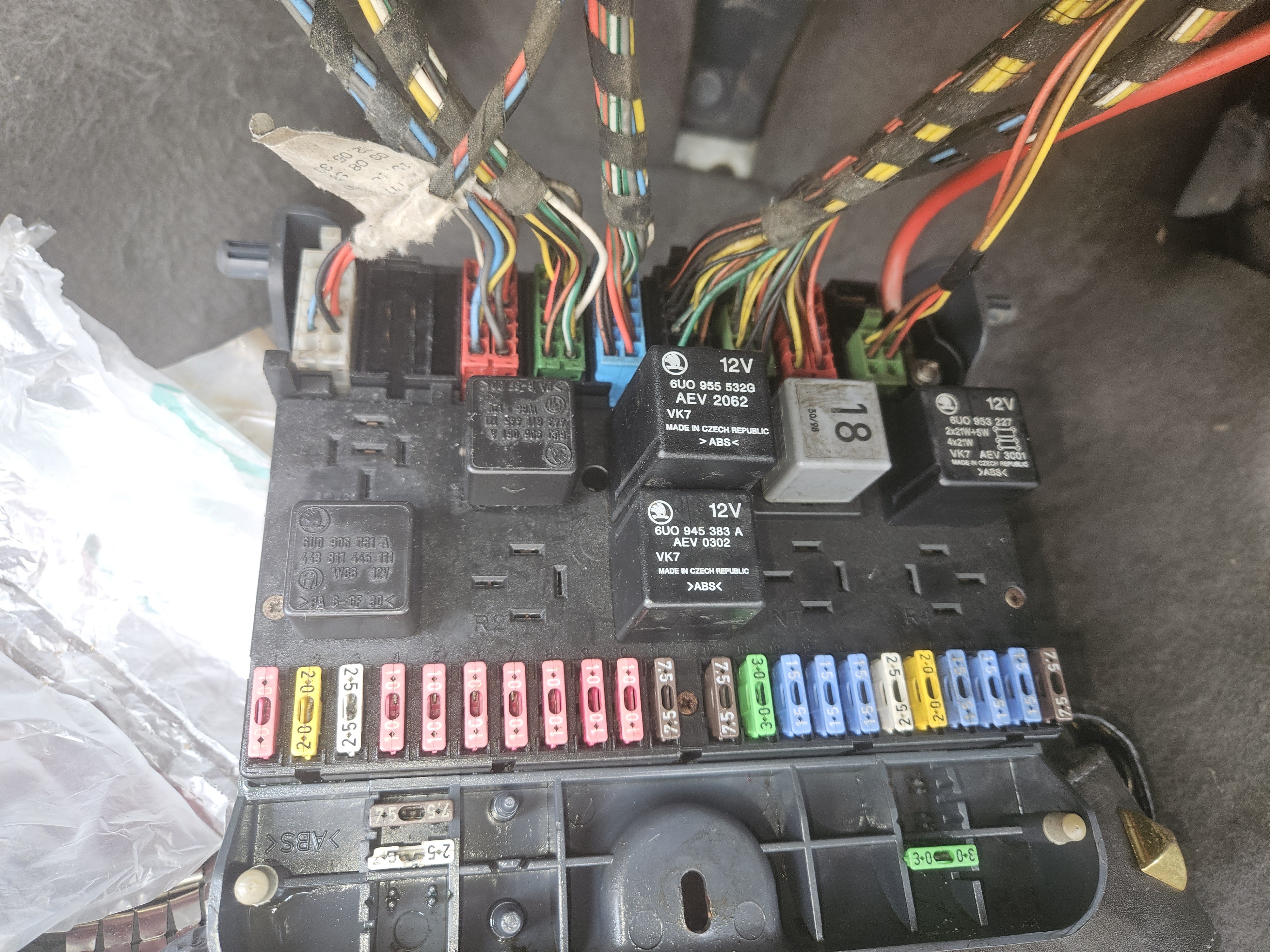

Where is the immobiliser please my petrol 1600 pickup isn't getting power to fuel pump please
You check Fuse? Relay?
I have indeed and all good 👍
More info from other forum, thread, post -
sparticus-84
"I'm new here and so sorry to ask if this is in wrong section please move to correct area again thank you in advance...
I have a t reg skoda felcia pickup 1600 petrol now I have all power everywhere except to the fuel pump wires which I have traced and got back to the board and it's red yellow blue and brown... brown is earth I know ..anyway so have had new relays  and cleaned the copper terminals all down so like new again and all power is going to lights horns etc etc but still no power to the 4 wires to pump even from the cable block on footwell side... so please help and all fuses looked good 👍 please help me"
Is the wiring factory standard, if so you need the wiring diagram, if not has any other non-factory items been fitted or factory items replaced, I'm thinking of a kill switch or re-routing of power supply away from normal immobiliser (if fitted) and/or ignition switch.
Have you done wire checks at connectors for continuity and supply (taken a direct live supply and/or from the battery or off-board 12v battery or tested wires with something like a reasonable sized bulb or diagnostic  tester probe if you have one?
Have used probe light no wiring is messed with it's all standard and have chased it back to where it's on the foot well just beside the fuse board and relays that's all been cleaned up and opened and there is no power going to the pump ? It stops at the fuses that's it ?? I have read 2 doff places for fuse the 5th 1 back from right and the 4th from left ps any help much appreciated I did wonder if inertia switch but can't find 1 ??
Ps to point out there is no power going down the cables to the pump please can someone tell me on the 4 pins what I need to check to know pump is alive thanks

If I was to just put power to fuel pump what do the colours mean ie blue yellow and the red and yellow stripe tracer brown is earth so the 3 other colours at the pump end what are they please or where on the fuse relay board is it in the cables
If it's a diesel, it's highly unlikely to be an immobiliser fault. Most likely the fuel pump relay (feel if it's clicking, if not, tap it with something metal), the wire to the stop valve, or the stop valve itself (whip it out, remove the plunger). D's need the stop valve, SDI's don't really need it, so you can pretty much just leave it with the plunger out if you're not discerning.
