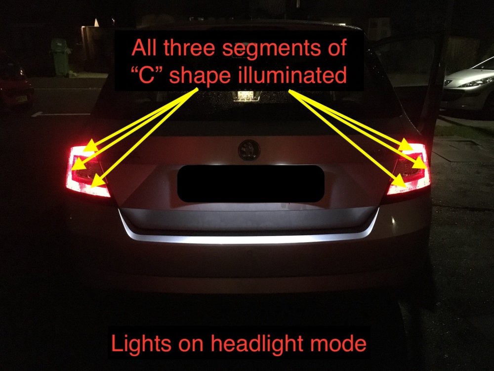

Hi,
I've tested the new options on my Skoda Fabia Mk III 2017 plate (with incandescent DRLs) and can confirm it behaves much more acceptably.  The new options are,
-Use left taillight as daytime running light (step 1 of 2) -> ENABLED
-Use left taillight as daytime running light (step 2 of 2) -> ENABLED
-Use right taillight as daytime running light (step 1 of 2) -> ENABLED
-Use right taillight as daytime running light (step 2 of 2) -> ENABLED
This enables the lower and vertical rear lights when the DRLs are on, the upper rear lights do not illuminate with the DRLs.  Once the light switch is moved into sidelights or headlights the front DRLs extinguish and the upper rear light illuminates as expected.  This is much more as I would expect.  I've passed the information about the two upper lights not illuminating on to Carista and asked them if this is intended behaviour - I'll let you know what I hear back from them.
Kind regards, Alec
