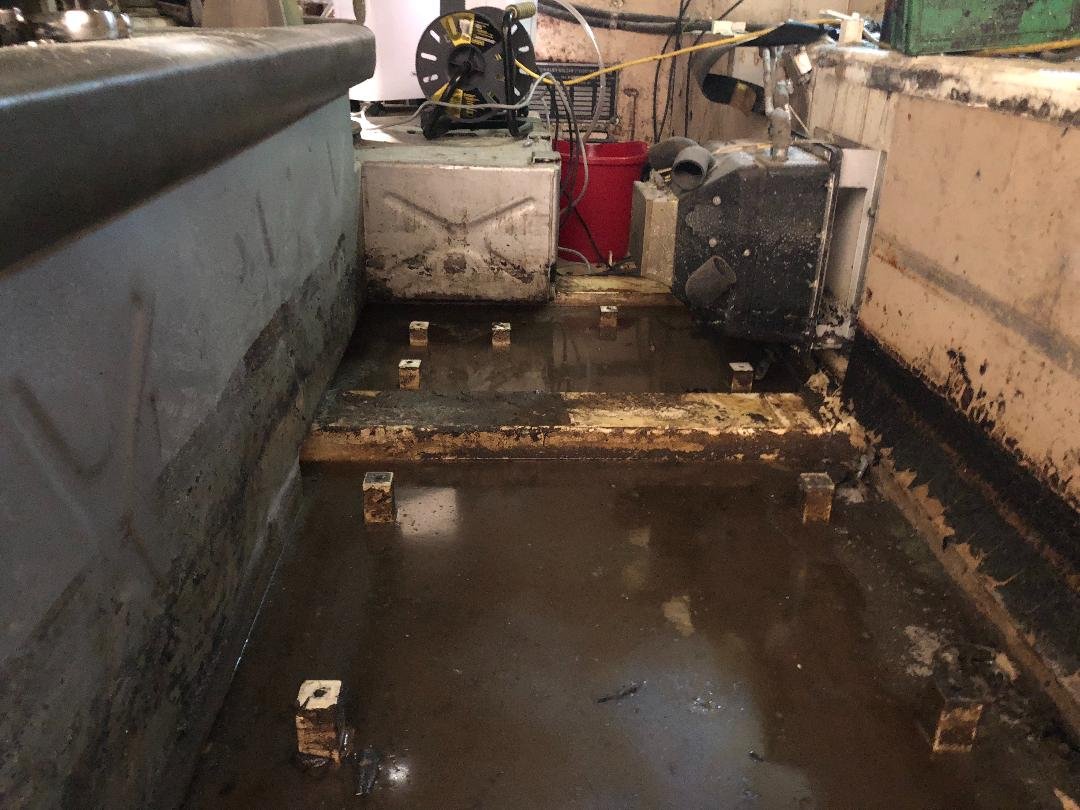

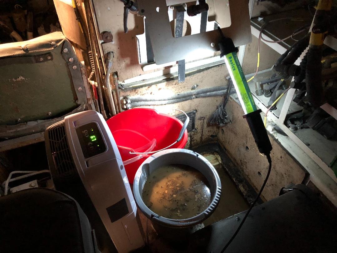

First thing I noticed was a lot of brown sludge sloshing around, fortunately not an issue with a well painted alloy hull.
So I spent a few days mopping it out and cleaning it.
Then I started to strip the back out, and when I could get the checker plate up I found even more gunge.  Must be over around 20 gallons of the stuff now!

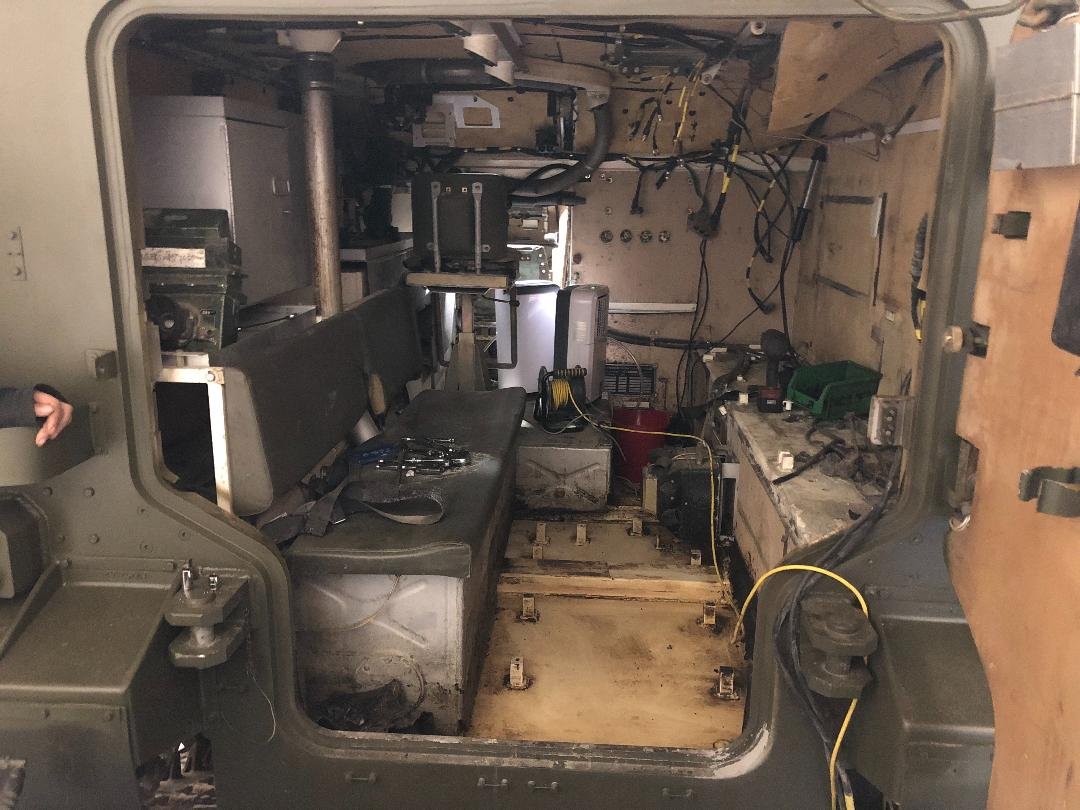

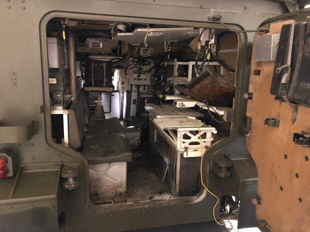

The radio shelving, officers bench was all very heavy and well made, so it's not only cleaner inside it's also more roomy to work in there now.
Leak has been traced to the radio mast (it used to have a 3-4m ariel for it's command and control duties) which has had the hole filled with a bit of wood shoved in there.
Looks like it's been dripping in since it left service around 6 years ago.

Got a couple of dehumidifiers running so it'll soon be nice and try.

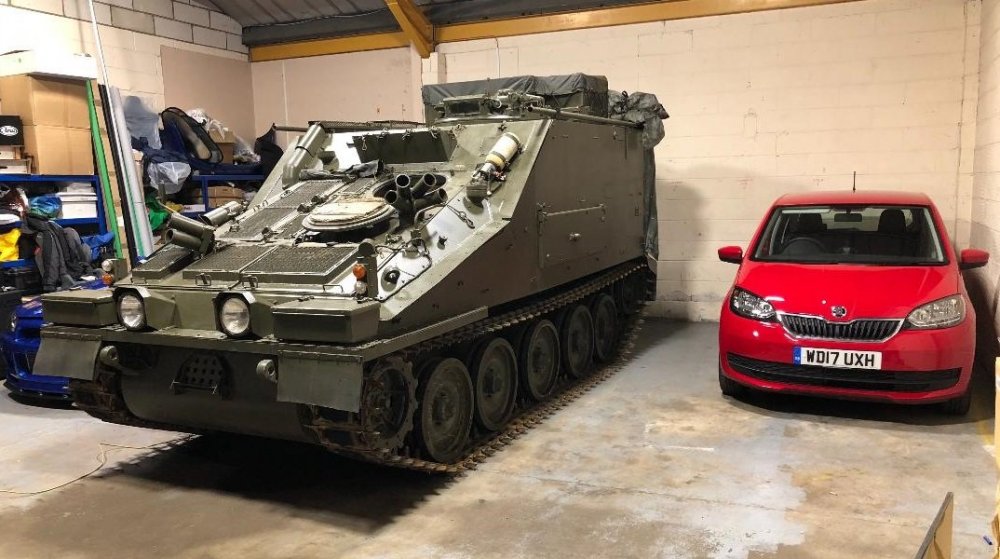

This Sultan was modernised in 1999 including a diesel engine and other upgrades so on a full tank would have a range of around 400 miles or so at an estimated 4-5mpg.

Full battle weight is 8.5t, have stripped it out a fair bit inside so will be weighing it soon to send the DVLA a request for registering and a V5.
