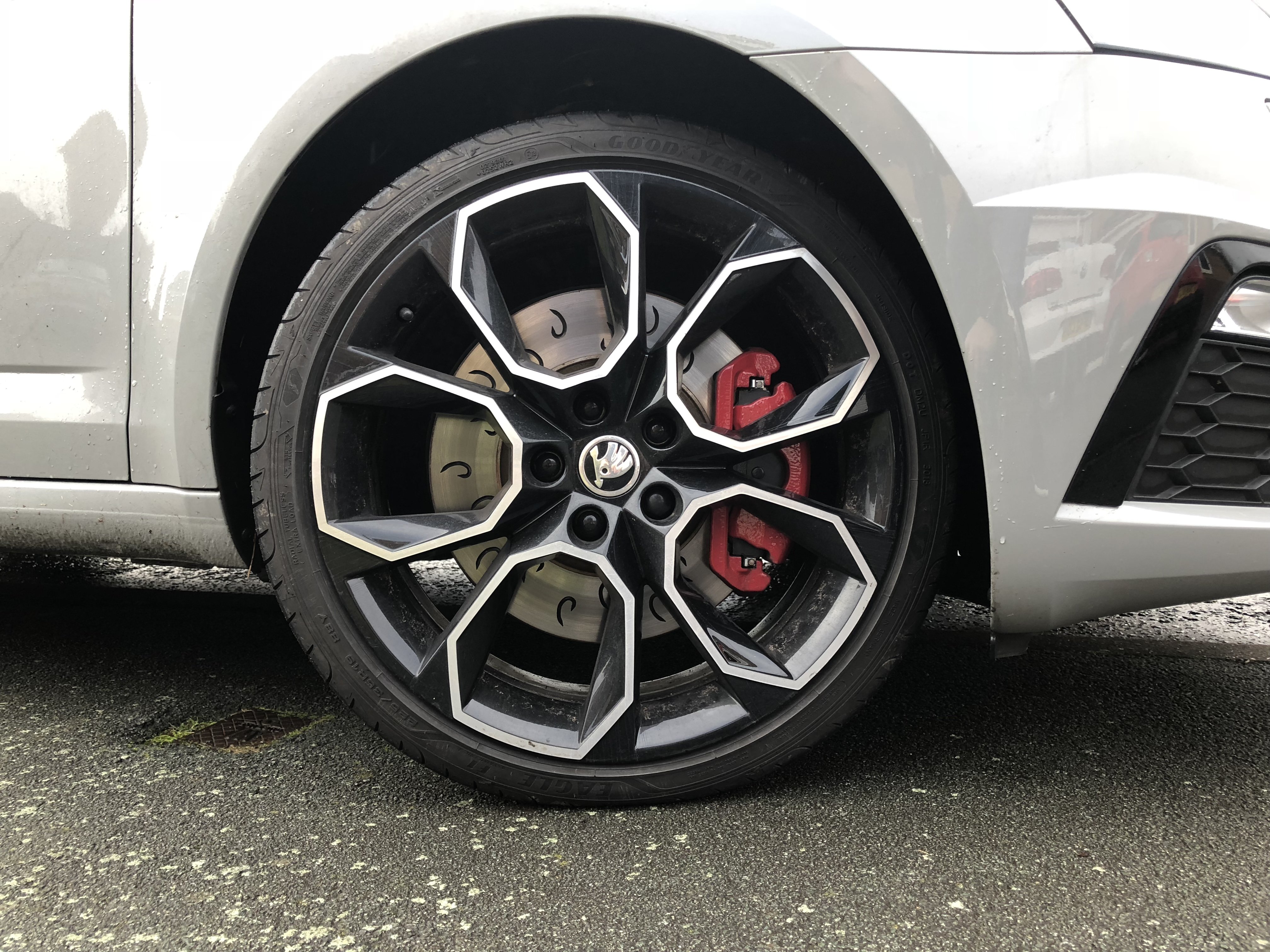

Well, fitted them yesterday will take a while to scrub in before i can say for sure but they definitely have a lot of initial bite

Any pictures behind the wheels? Would also be interested in the noise levels with the c hook design.

No noticeable noise nothing like slotted ones I’ve had in the past.

Are the C hooks directional or do they face the other way on the passenger side?
Yea directional so C is open towards the back on both sides as it passes through the caliper
