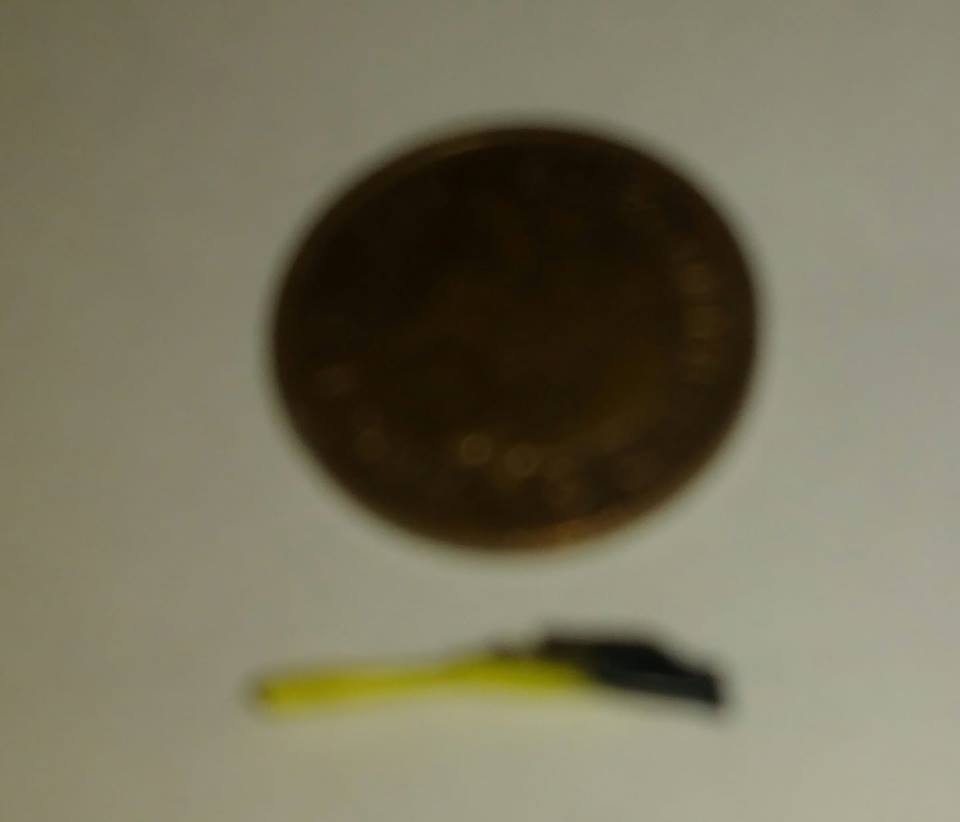

So iv just had it to the auto electrician it took him around 2 hours to sort the problem out the piece of wire was burnt out near the bcm cluster cost me £95 just hope it last longer then a few hours
