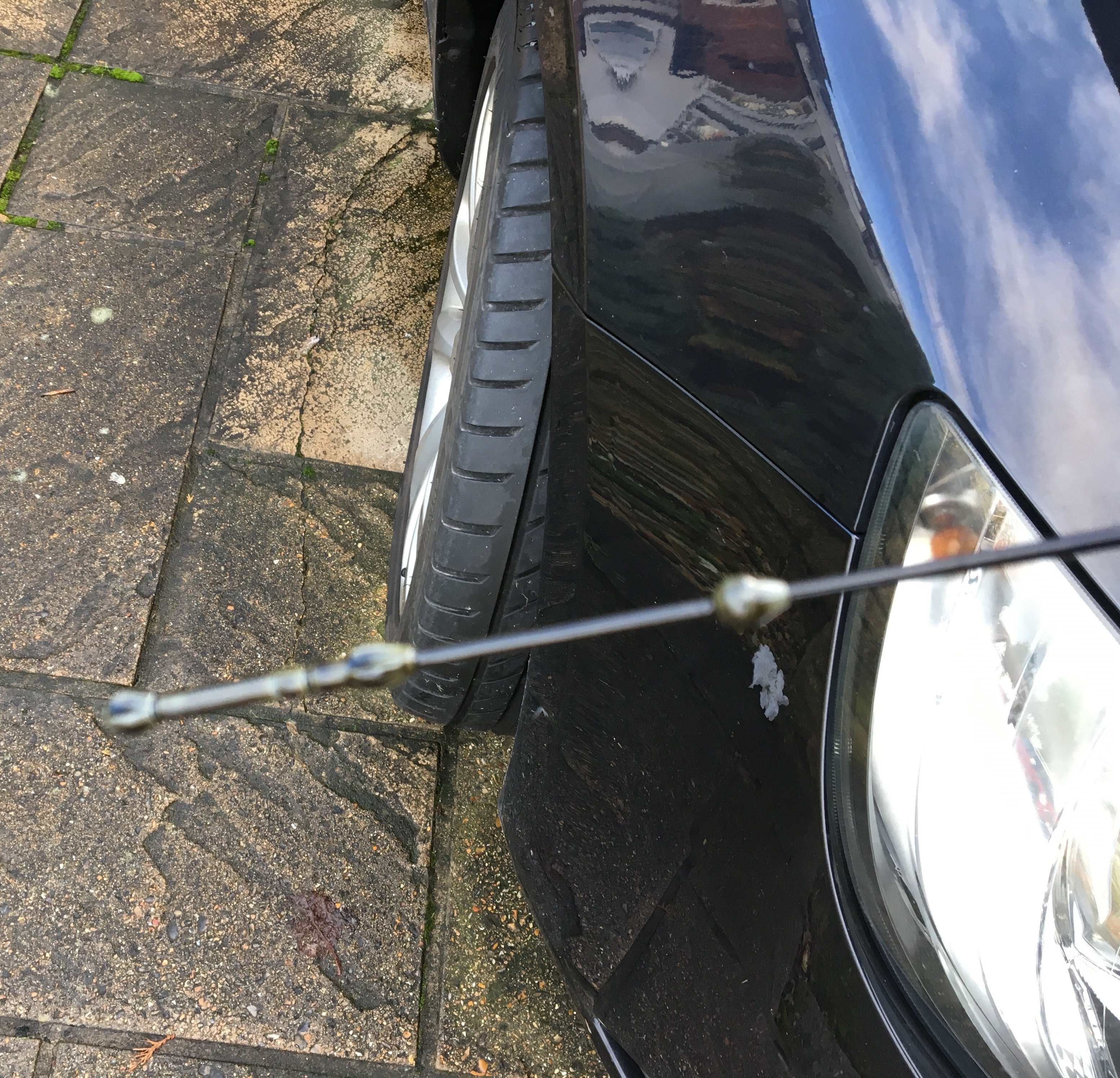

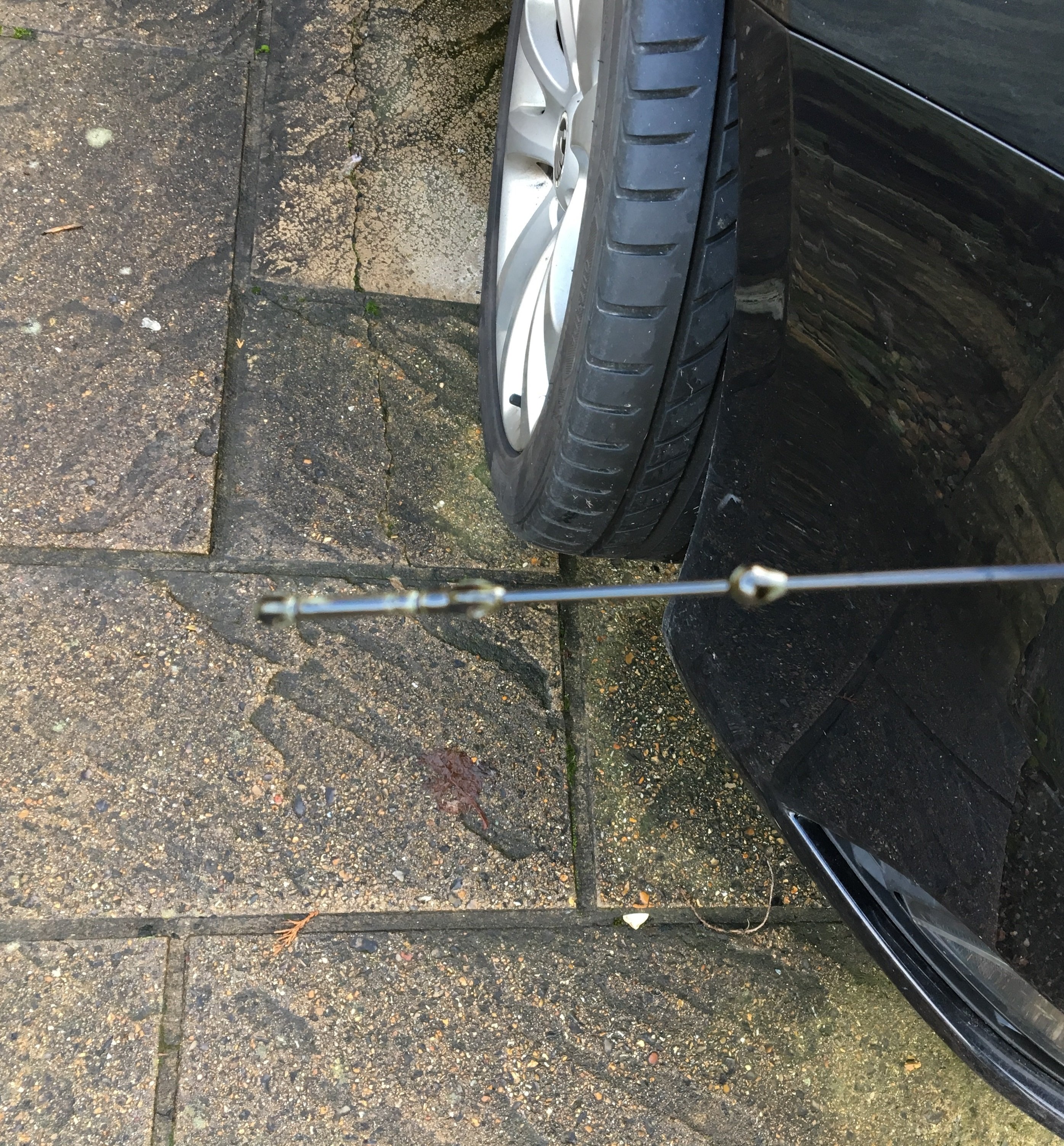

I tried two different ways to read this (both when the engine was cold on a flat surface) & apologies for the really bad quality of photos.
1.       Remove dipstick
2.       Clean dipstick
3.       Reinsert till it ‘clicks’
4.       Take the reading
Here’s the photo:
Edited by nazitf

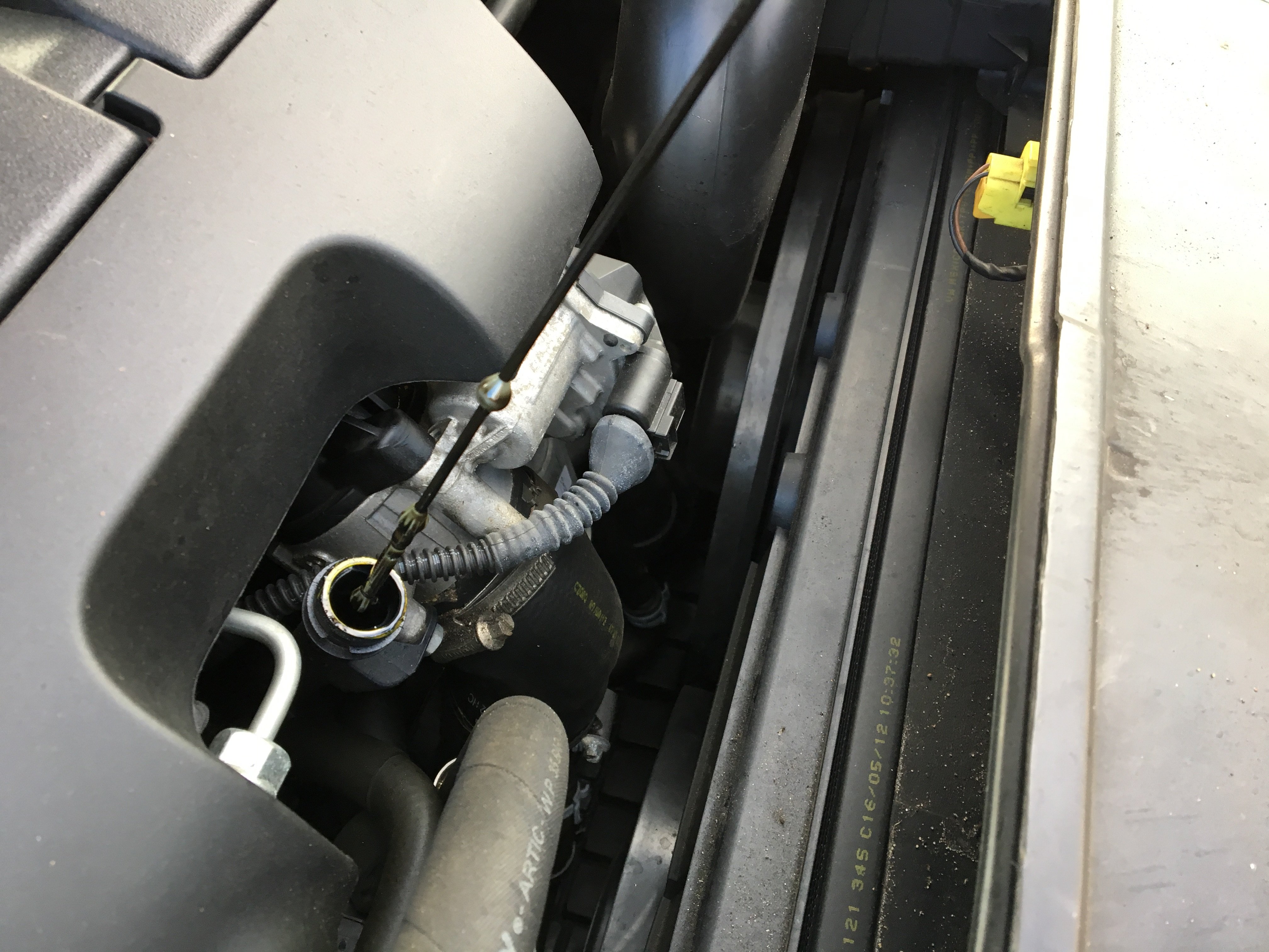

Second approach was
1.       Remove dipstick
2.       Clean dipstick
3.       Reinsert till just before it ‘clicks’
4.       Take the reading
Here’s the photos
If its only slightly over then I’m not worried but since the grey blob on the right hand side is also covered in oil, does this mean its over filled to that level? Its weird that the grey plastic section doesn't extend much above the high level markings since its makes reading an overfill much harder!
Any advice on reading this oil level would be most helpful!

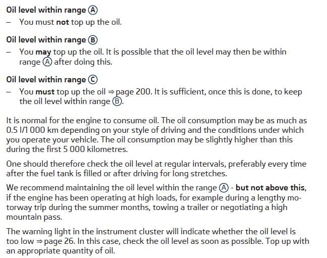

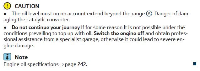

It's all in the manual...

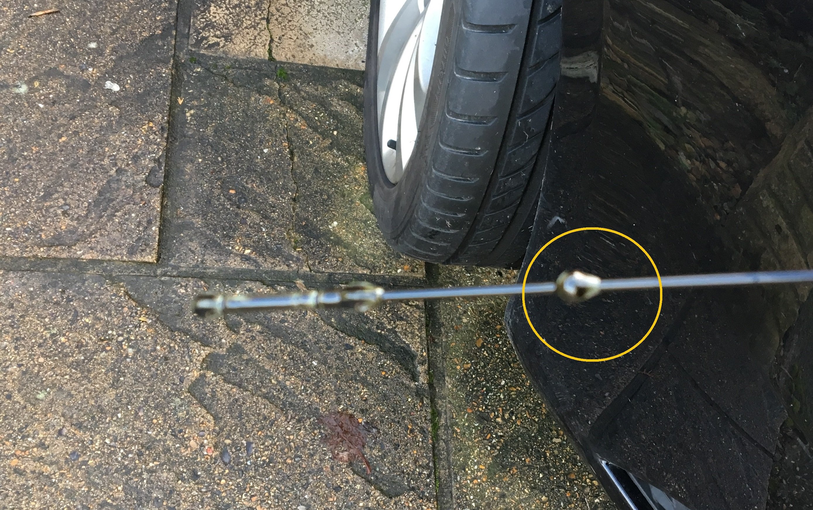

Thanks for all the replies. What’s confusing (for me at least!!) is that there is oil staining on the highlighted part of the dipstick below. Is this normal i.e. when it rubs the inside of the dipstick tube as its pulled out or is it indicative of the oil level in the sump? Note, I fully cleaned the dipstick so that there was no oil on it before reinserting it.
Yes, perfectly normal, mines the same.

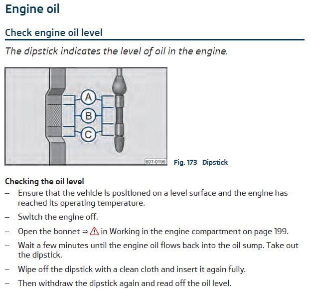

After removing the dipstick, give it a thorough clean, reinsert, wait a second or two and remove again to take the reading.
There's always a bit of oil down the dipstick tube since the engine is churning it around down in the sump. Surface tension and the narrow clearance between the dipstick and the tube will hold some oil up there after shutdown.
Checking Cold on the flat is 'Simply Clever'  as Engines are often 'Cold' before setting off on trips.  You want to know there is oil, and enough oil,. and not stop 10-20 miles later to check.
But VW Advice is 'At operating temperature'  other than 1.2 44 kw engines which are checked when cold.
...apart from the reminder to refit the filler cap  :rolleyes:
