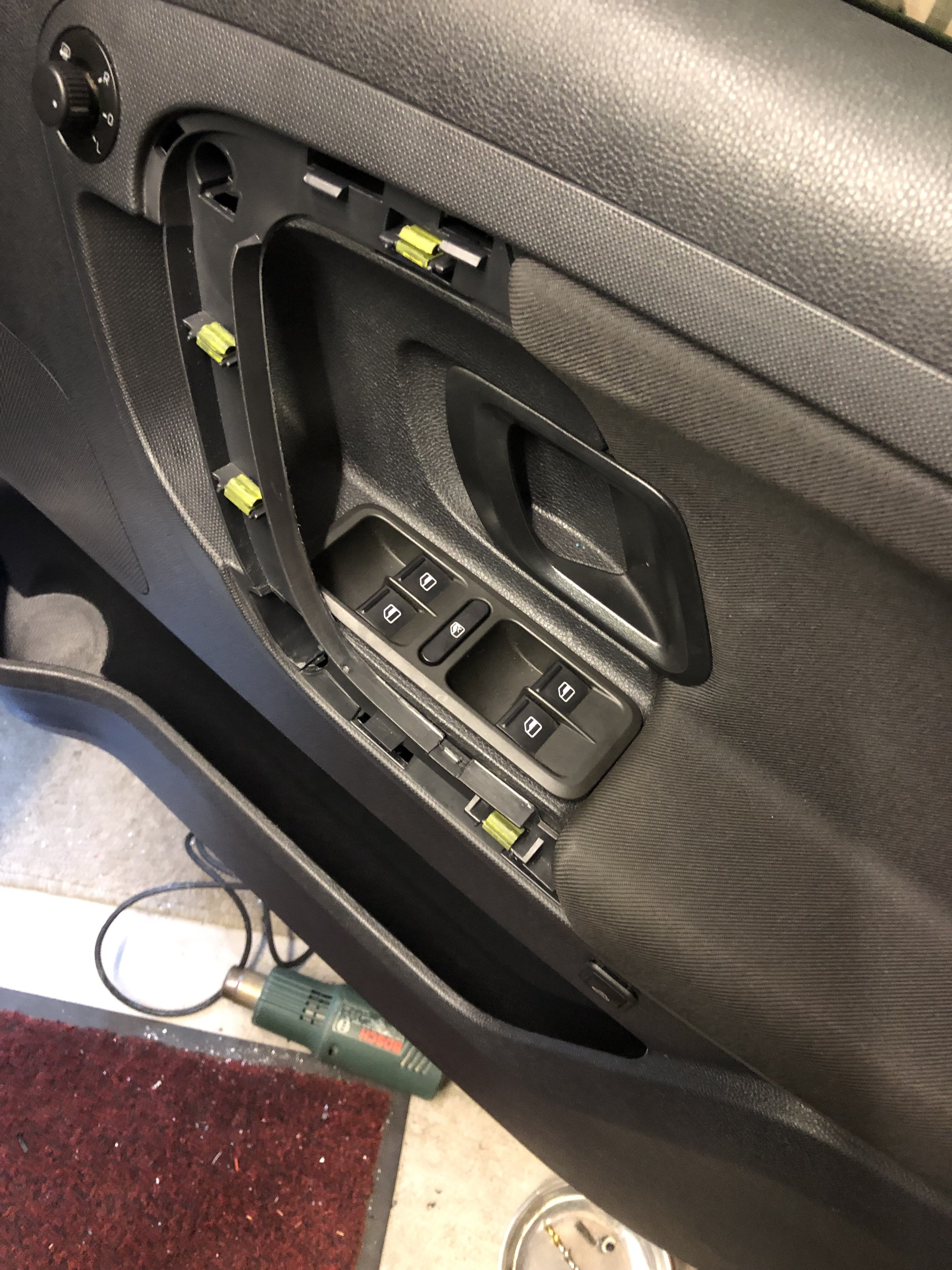

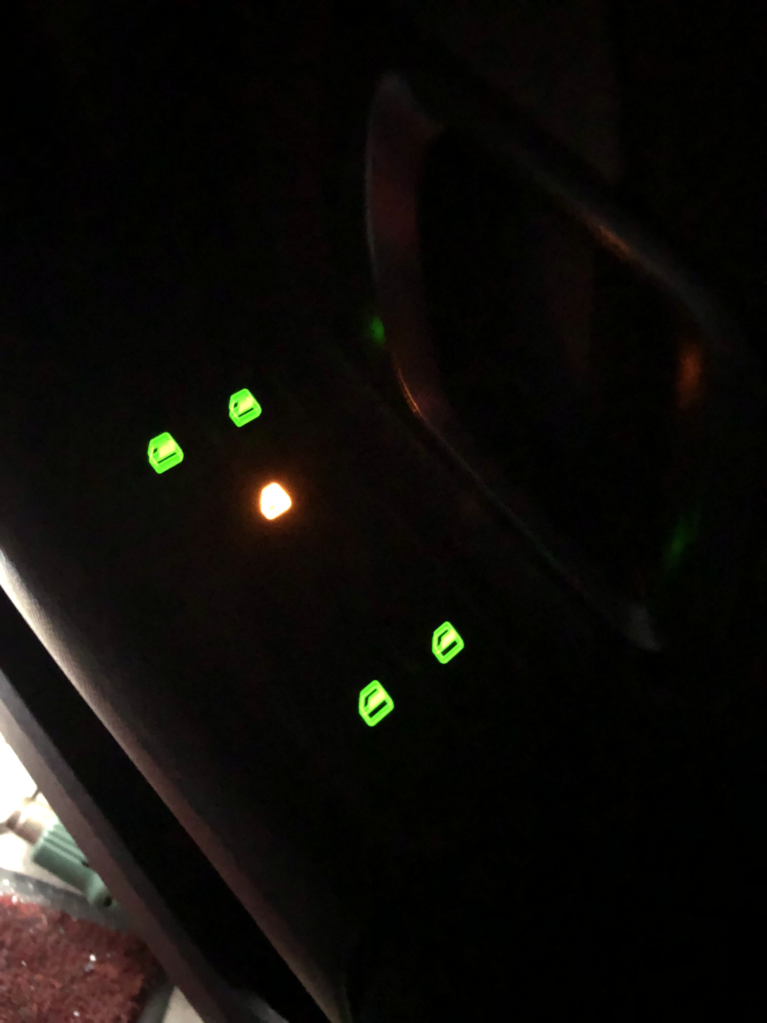

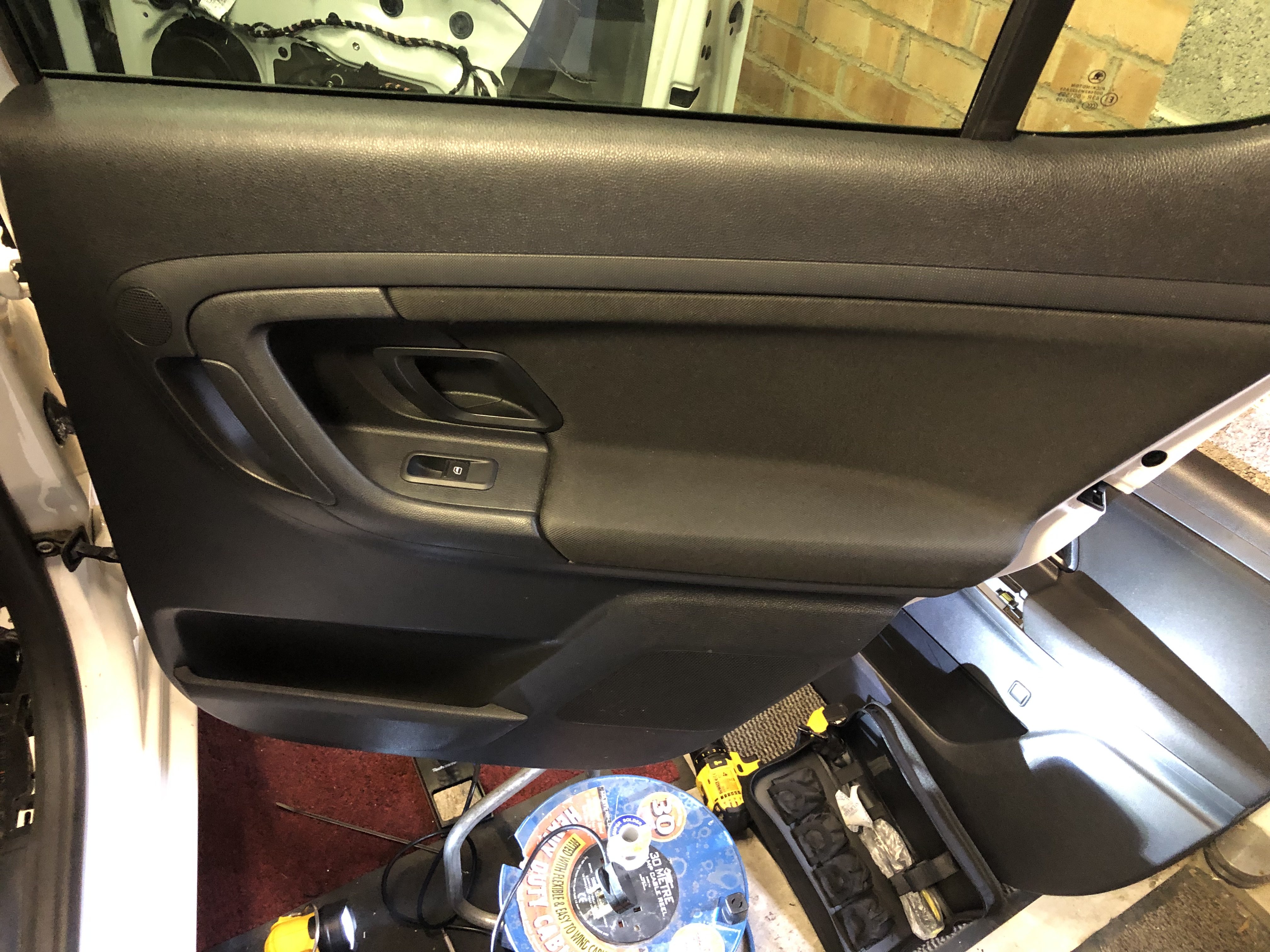

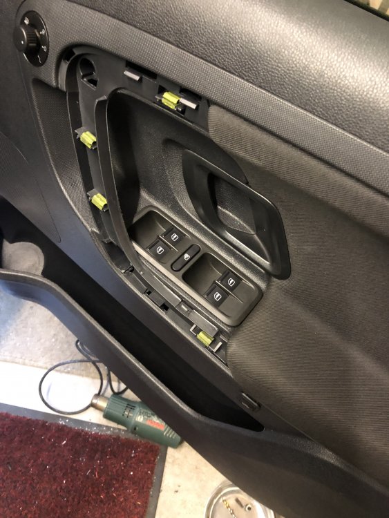

Well MISSION accomplished !!! :rofl::rofl:
I now have 5 switches on the drivers door :clap:
Really pleased how it went, all looks like it has been there from day 1 (should have been really)
In total, I think its probably 1 - 1-1/2 days work to do it like I did, well worth it for me.
All works as they should with comfort settings etc etc.
In fact, I did one side first and then the other but both even tested and worked without re-coding the central electrics module to tell it rear elecy windows installed,

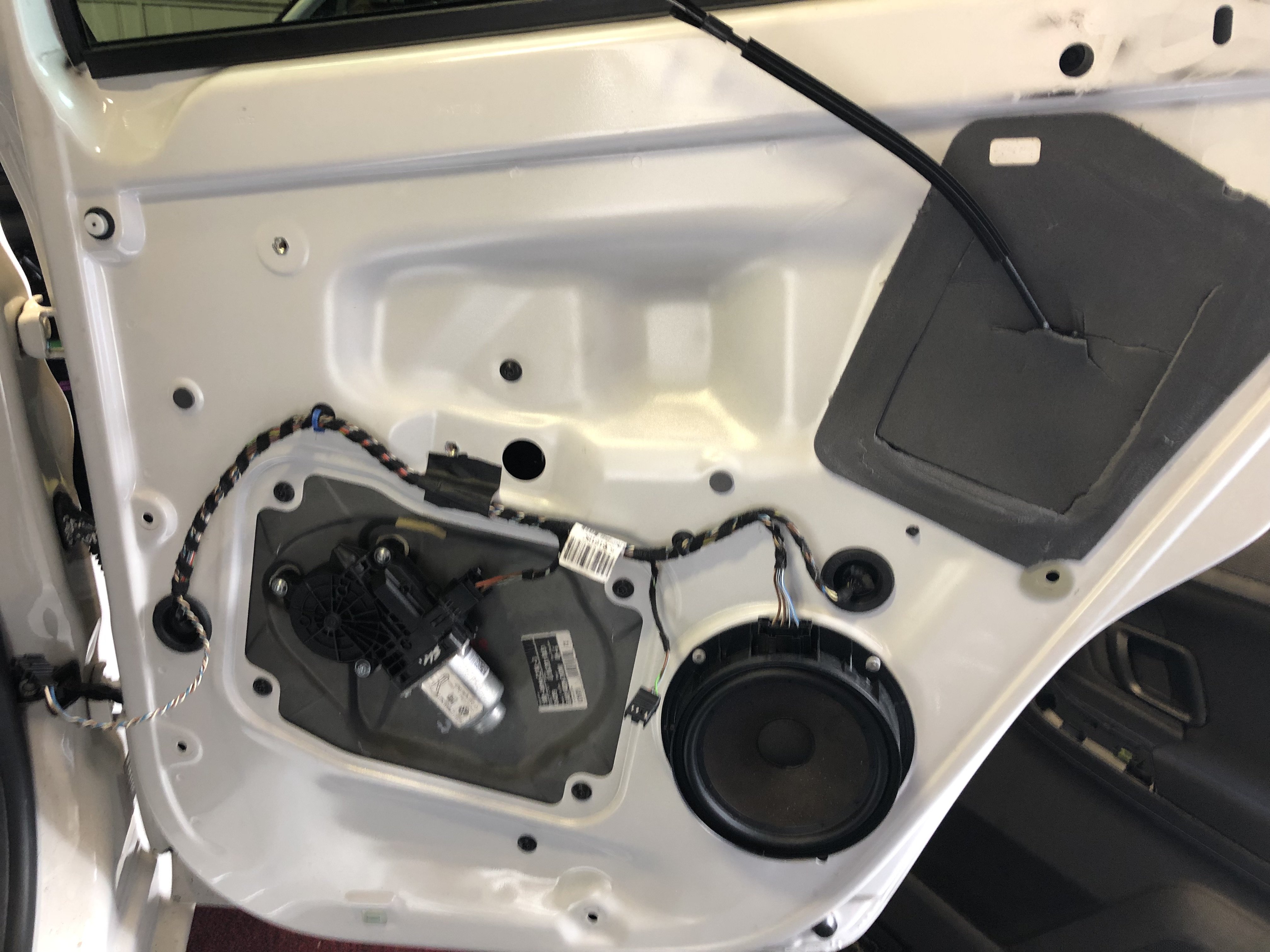

were there any mounting points on the rear for the motor etc?
Yes it was an option 100% and only £160 as well !! ................gods knows why you would not spec it, well I certainly would have considering that to buy all the parts "new" would be over £ 500 +
The motor mounts to the rear regulator plate which inturn mounts in exactly the same way as the manual regulator plate to the door using the same fixings. It also connects to the glass the same way etc.

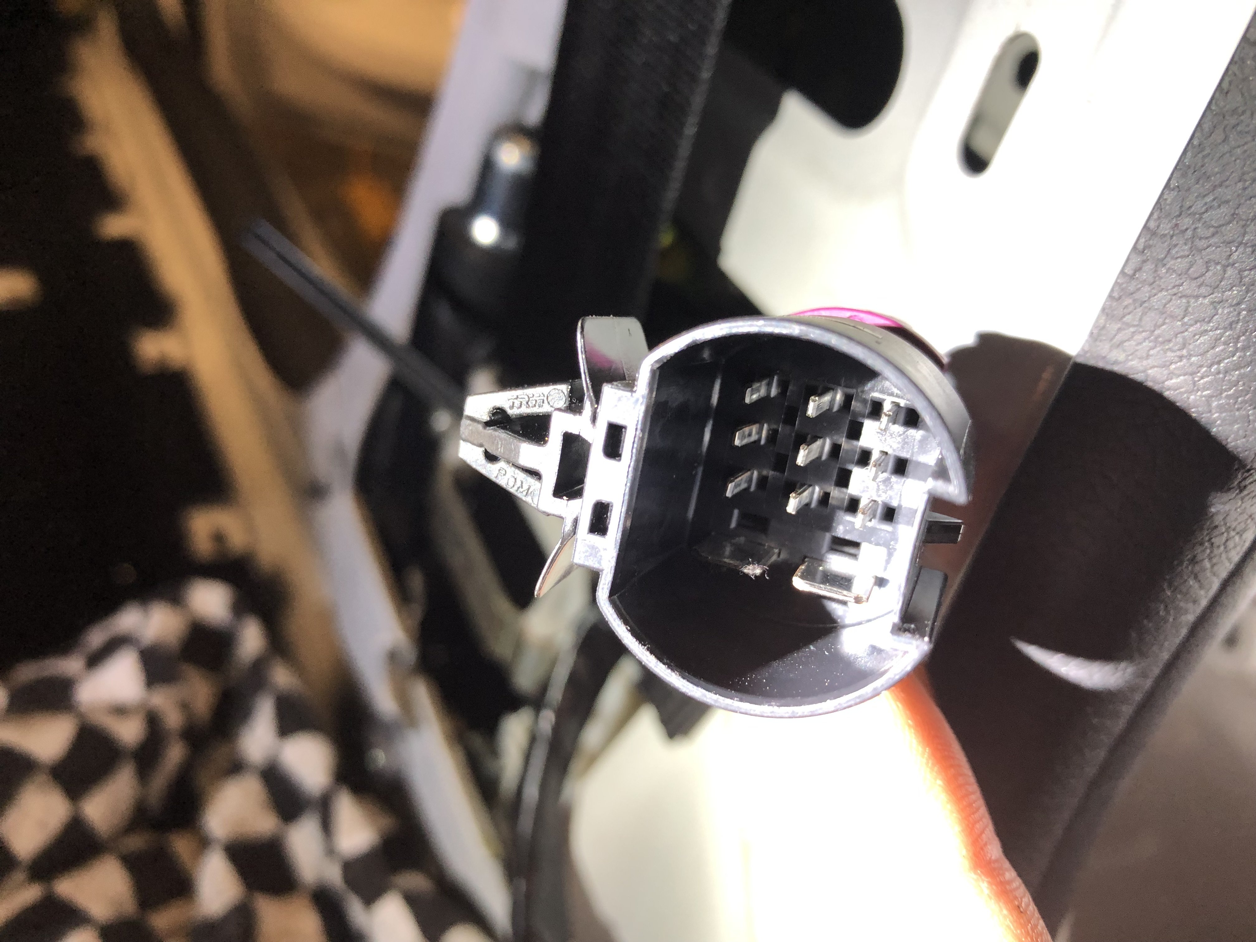

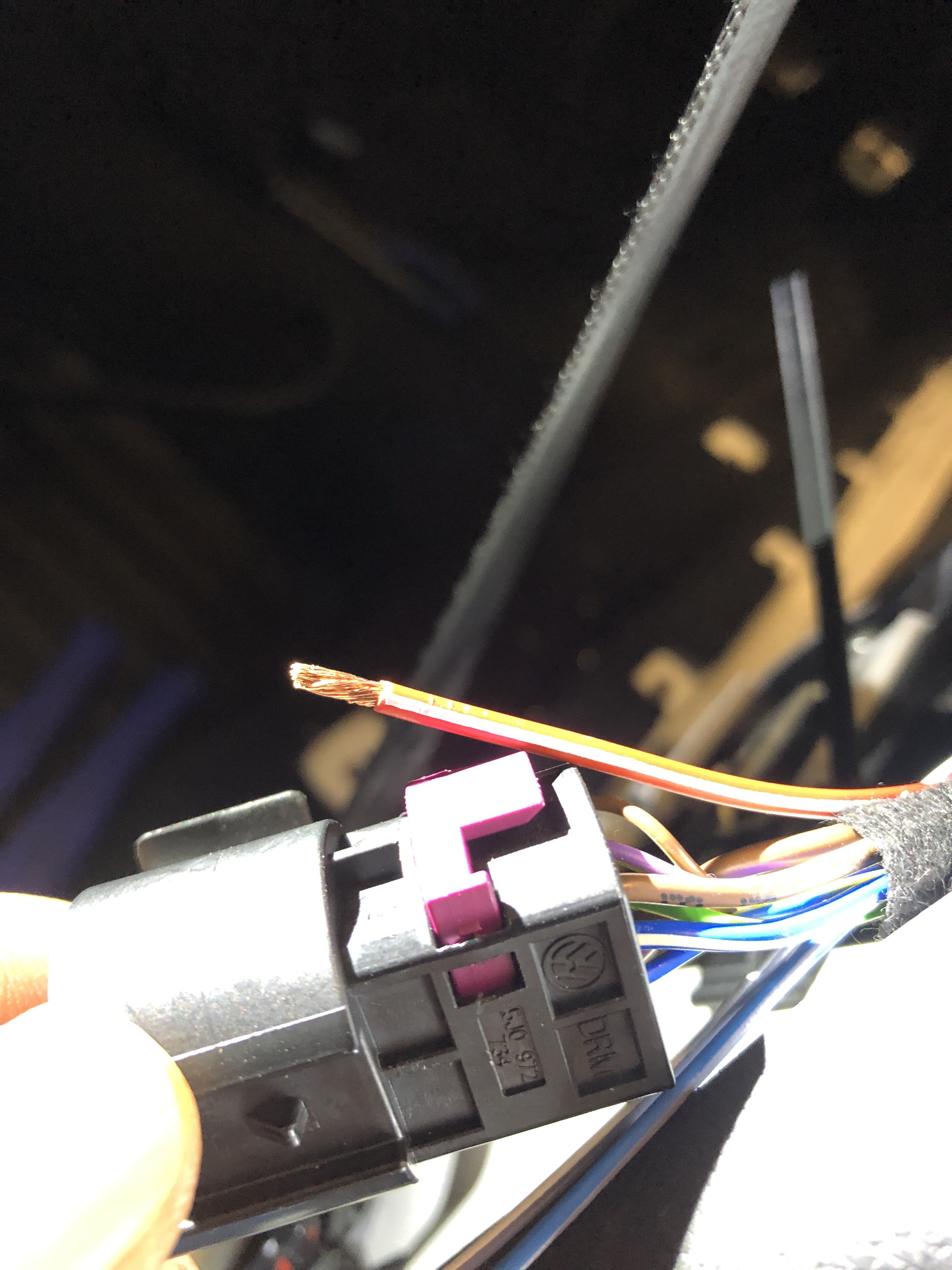

Below is the plug at the B pillar, it's is now fully populated, but it was "missing" 3 feeds,
+ 12v for power
+ 12v Lighting feed (switch lighting)
LIN BUS feed to the drivers door control unit.
 Was this just in your case the pin was broken or do you suspect they all come like this?
No there was nothing broken, this is the interior loom which I had hoped was pre-wired in all vehicles and when speccing rear electric windows it was the door looms that were added / different, but this is not the case.
The looms on cars "without" rear electric windows dont have a +12v feed , +12v for switch lighting and LIN bus connection in them (3 feeds missing) so these need to be added to the looms.

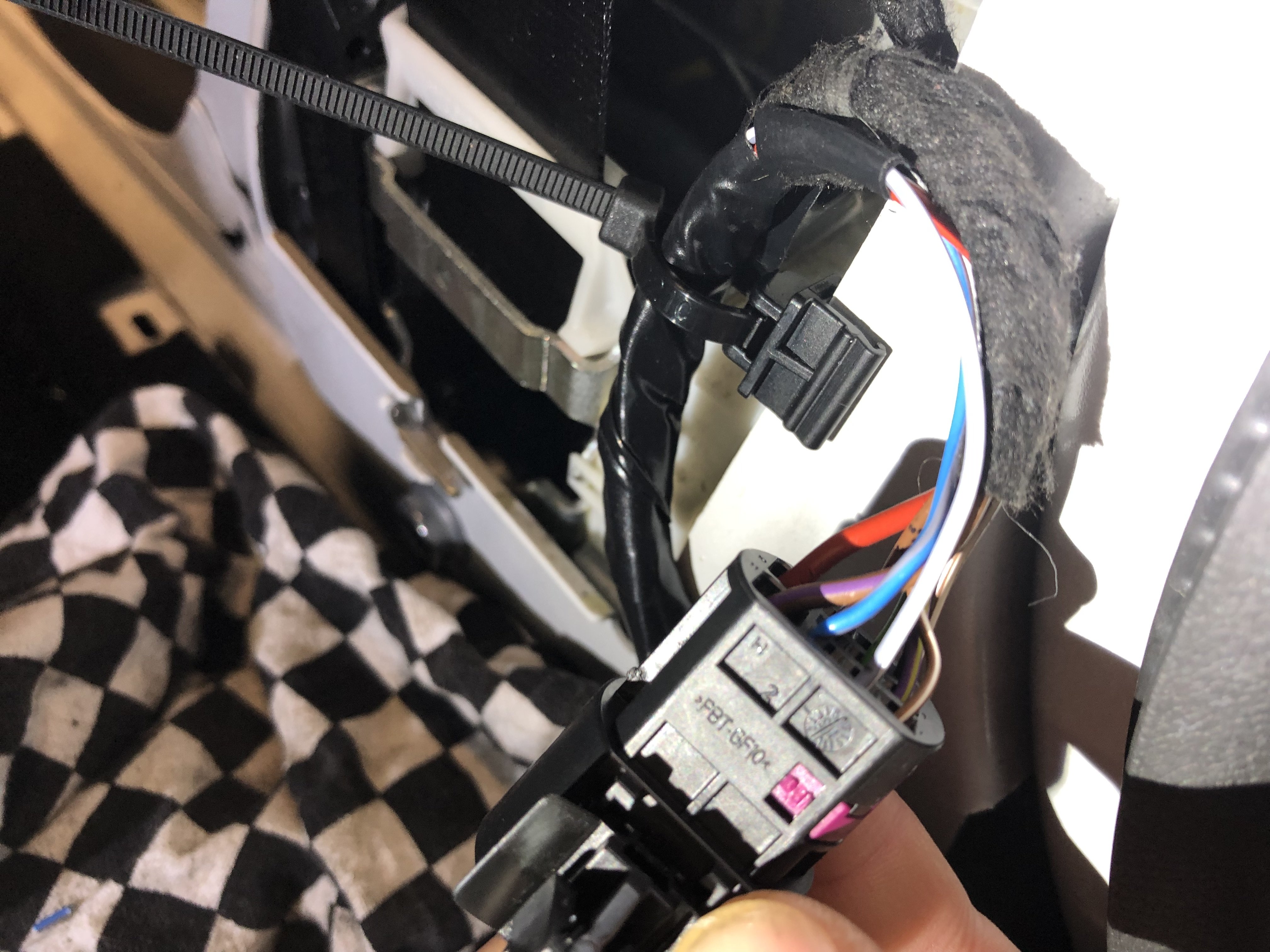

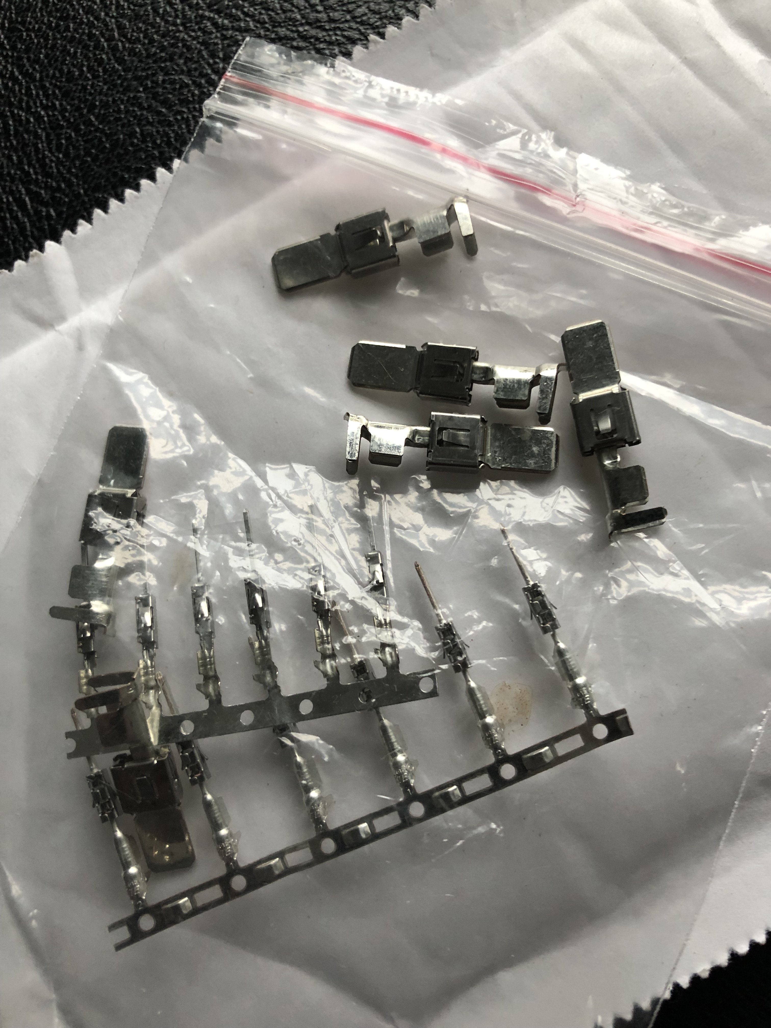

 Pins needed for connections

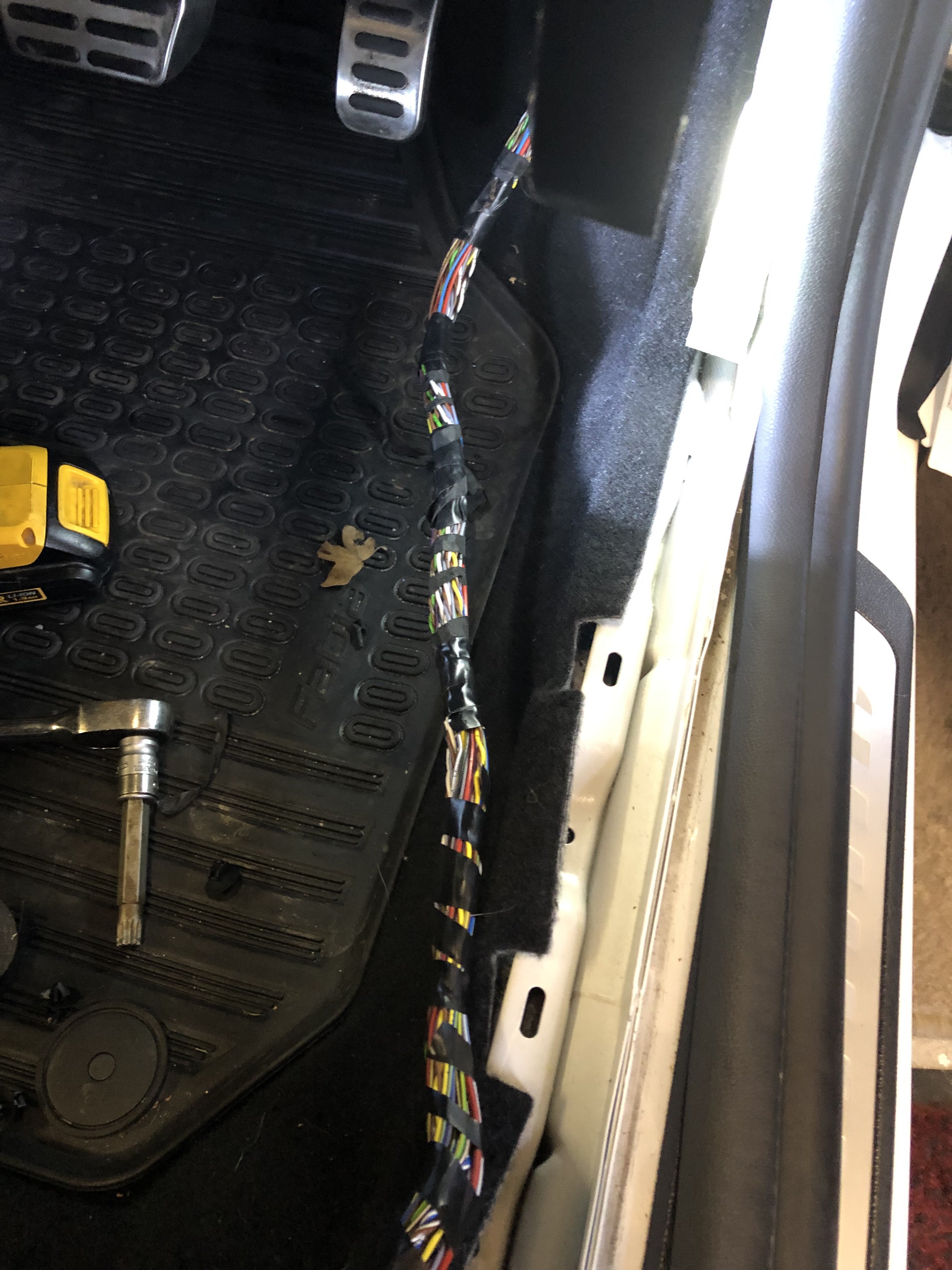

Adding wires to B pillar plug
New loom / connections in place at the plug and now run all along the sills up into the A pillar
area where the drivers door loom goes into the door

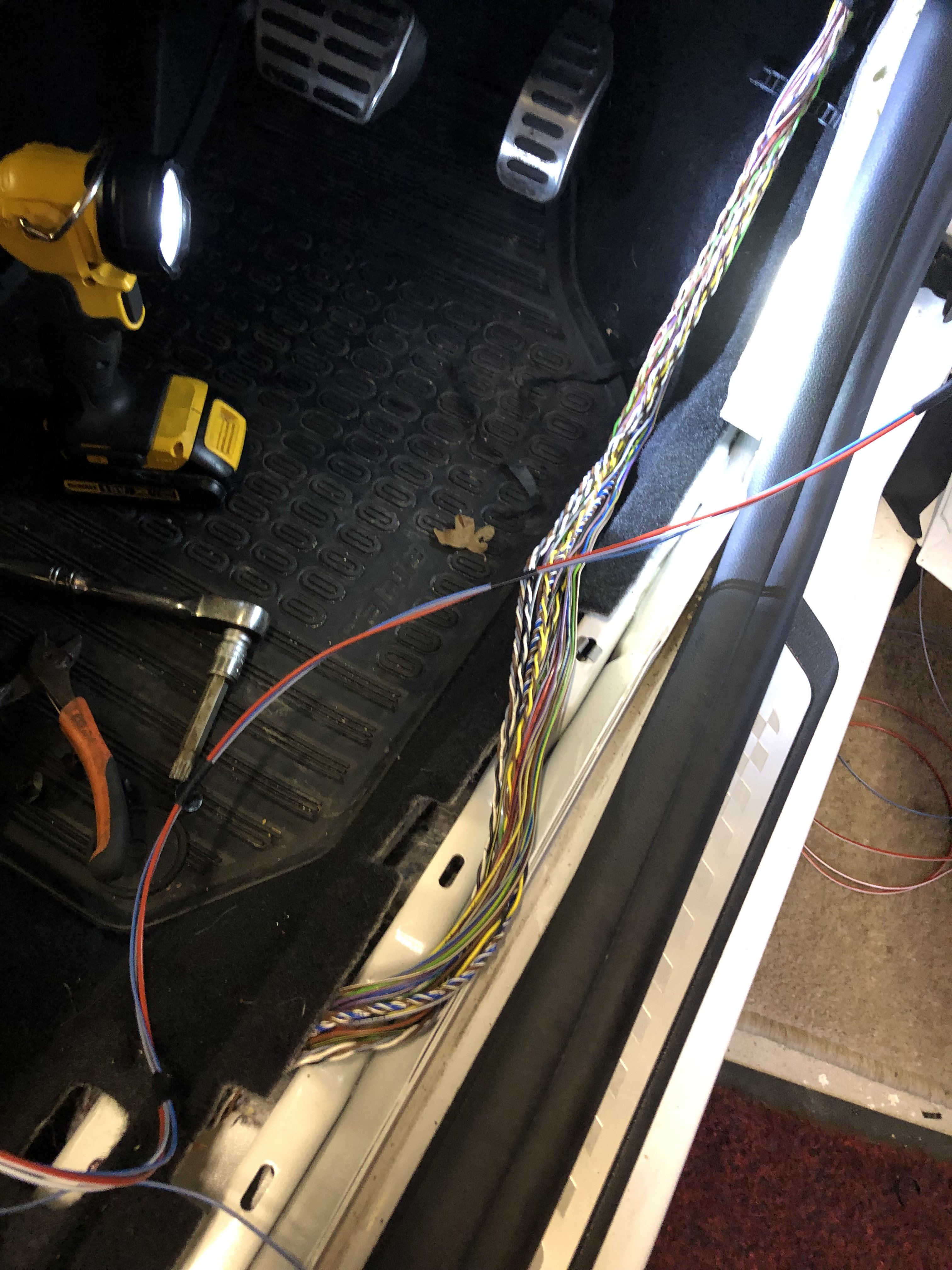

Running in new wires into existing interior loom... I "split" un-wrapped the factory loom
and run the new wires into it

Nice work.
Where did you get the pins from?
I have been looking for these for some other pugs.
