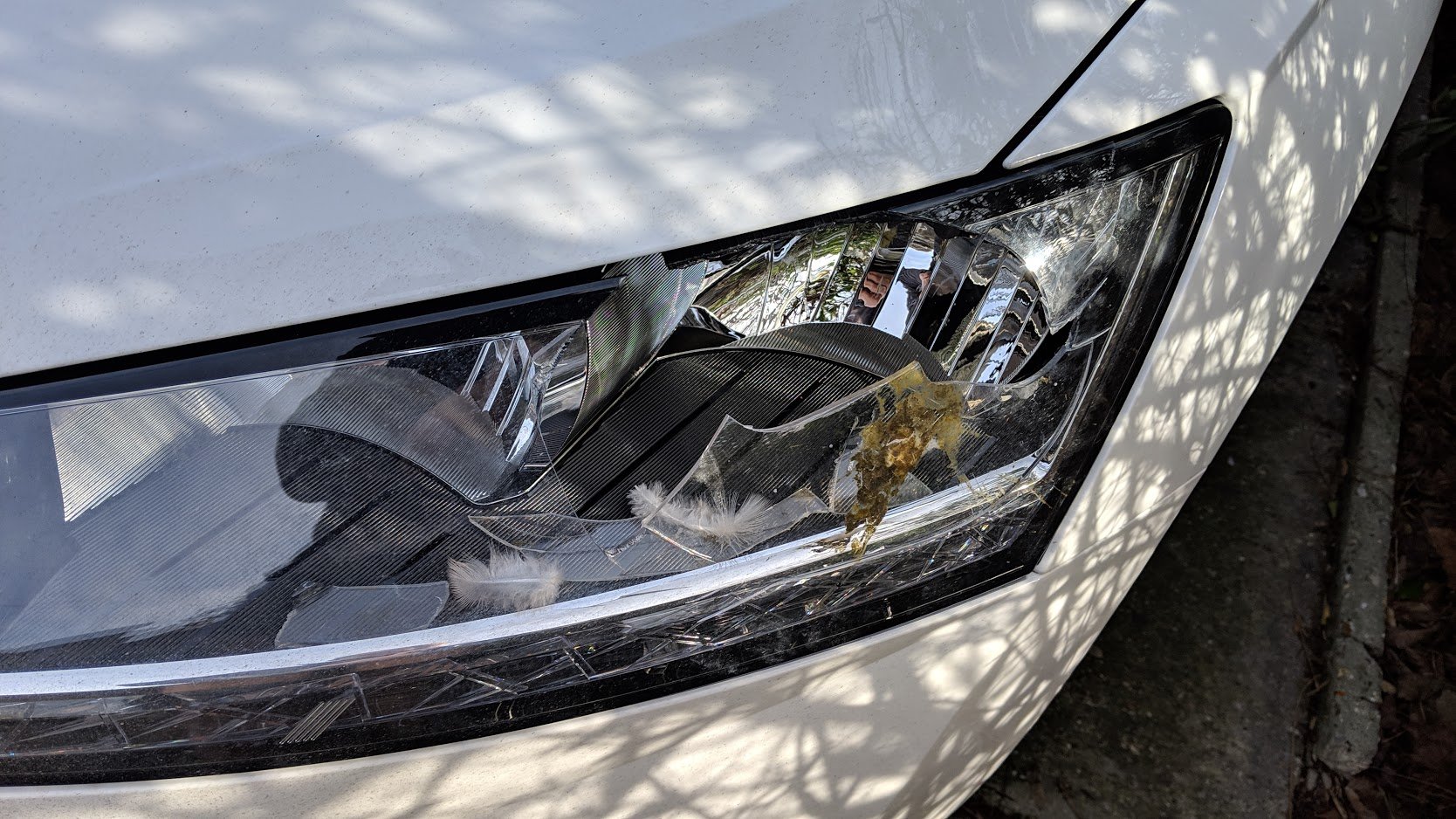

It's still not fixed and to make matters worse, the little Fabia they lent me had a collision with a pigeon on the M25 yesterday. Outcome is the bird is dead and the headlight smashed/broken.
So now I'm a murderer with a bill to pay for a new headlight!!

Took the 'borrowed' Fabia in today to get the headlight replaced. Wasn't charged for the labour so the bill came to £140.
