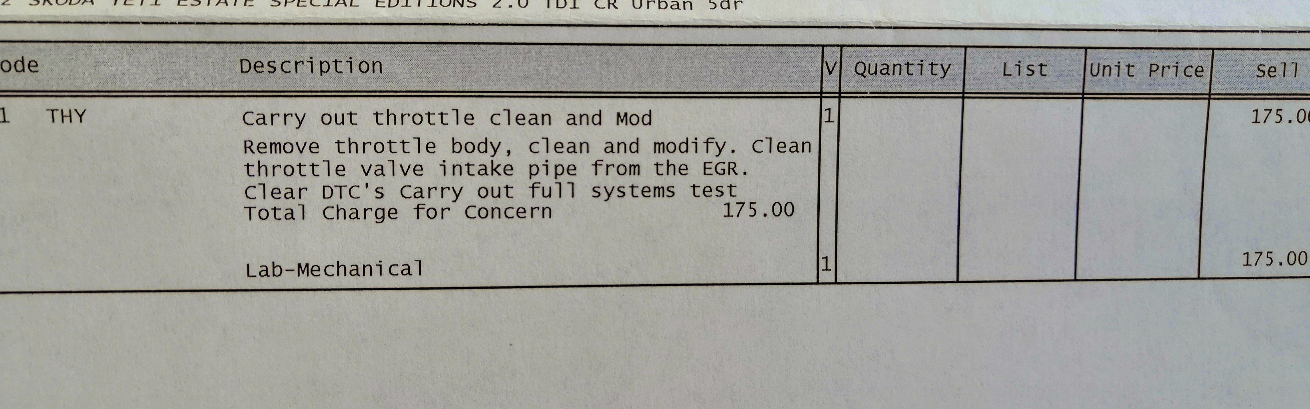

Had the coil warning light flashing on my Yeti 2.0 tdi, took it to a dealer that read the engine code (P2102) they cleaned and modified the Throttle body (receipt attached in photo - £210!!).

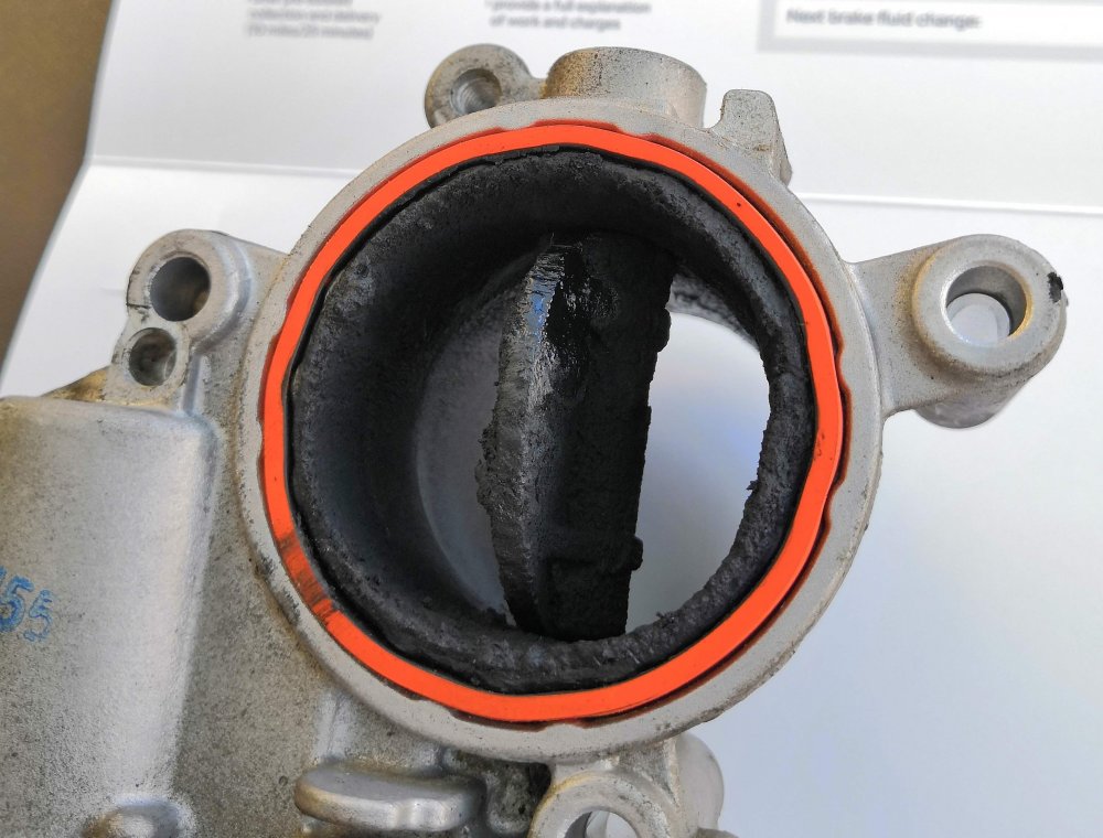

Took the old body off this morning and it looks like this - was cleaned 3 weeks ago??
Don't believe it has been cleaned myself, can anyone comment before I go back to complain?
well the outside of the body certainly looks like it has been cleaned (considering it is 6 / 7 years old) plus the O ring looks new.
How many miles (and what type of mileage... motorway / local town centre etc) have you done in the last 3 weeks?

The rest of the engine is clean - only done 40,000 miles.
It has done about 450 miles since it was "cleaned" - 400 of which was motorway to London and back.

I was hoping for the same (Emission fix was done  about 18 months ago, I've only had the car for  just over 1 month) - but they said it wasn't related and it has built up over time, low mileage and short journeys, which seemed reasonable.
Planning to have the "fix" removed once it is out of the "trust building measure" has run out!
Obviously it's not been cleaned. As a part of the modification is to turn the pipe so all the gases going back to the engine and not into the throttle body. If that will be me, I'll be going to see Service manager before fitting a new part (expecting refund a job done once again under warranty)...
What he said...
Also, if the previous grunge had built up over years, how comes this grunge took a month?

Thanks both - I have emailed the dealer - waiting for a response, can't see how they will explain it, but I'll keep you posted......
Perhaps the fix produces so much gunge this is what you see after 450 miles?
