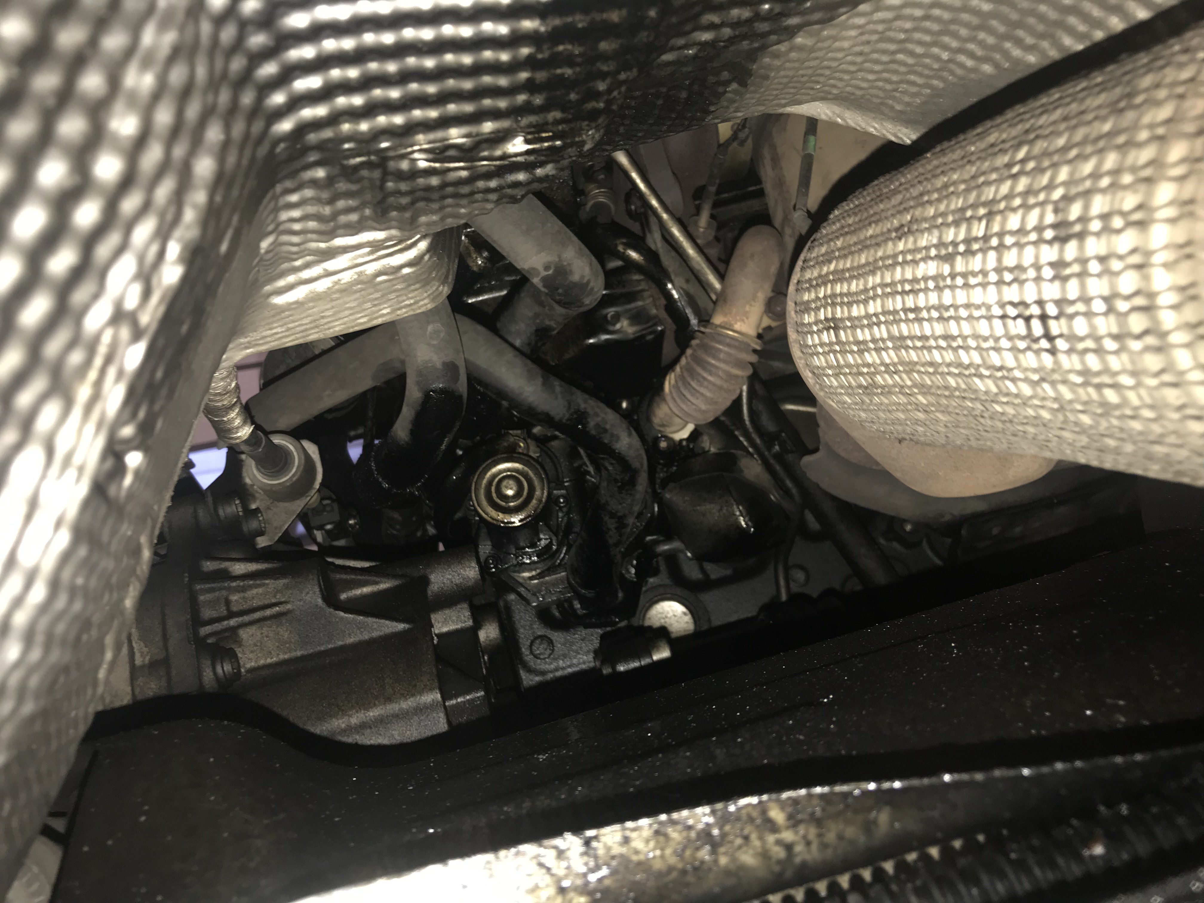

Still bloody leaking. Seems to be just right of centre of the engine underneath. There is also some wetness at the back of the engine, a right mess. Not sure if that’s oil or coolant. I'll post pics I have. Any suggestions?
Think is is under/behind the engine, a right mess

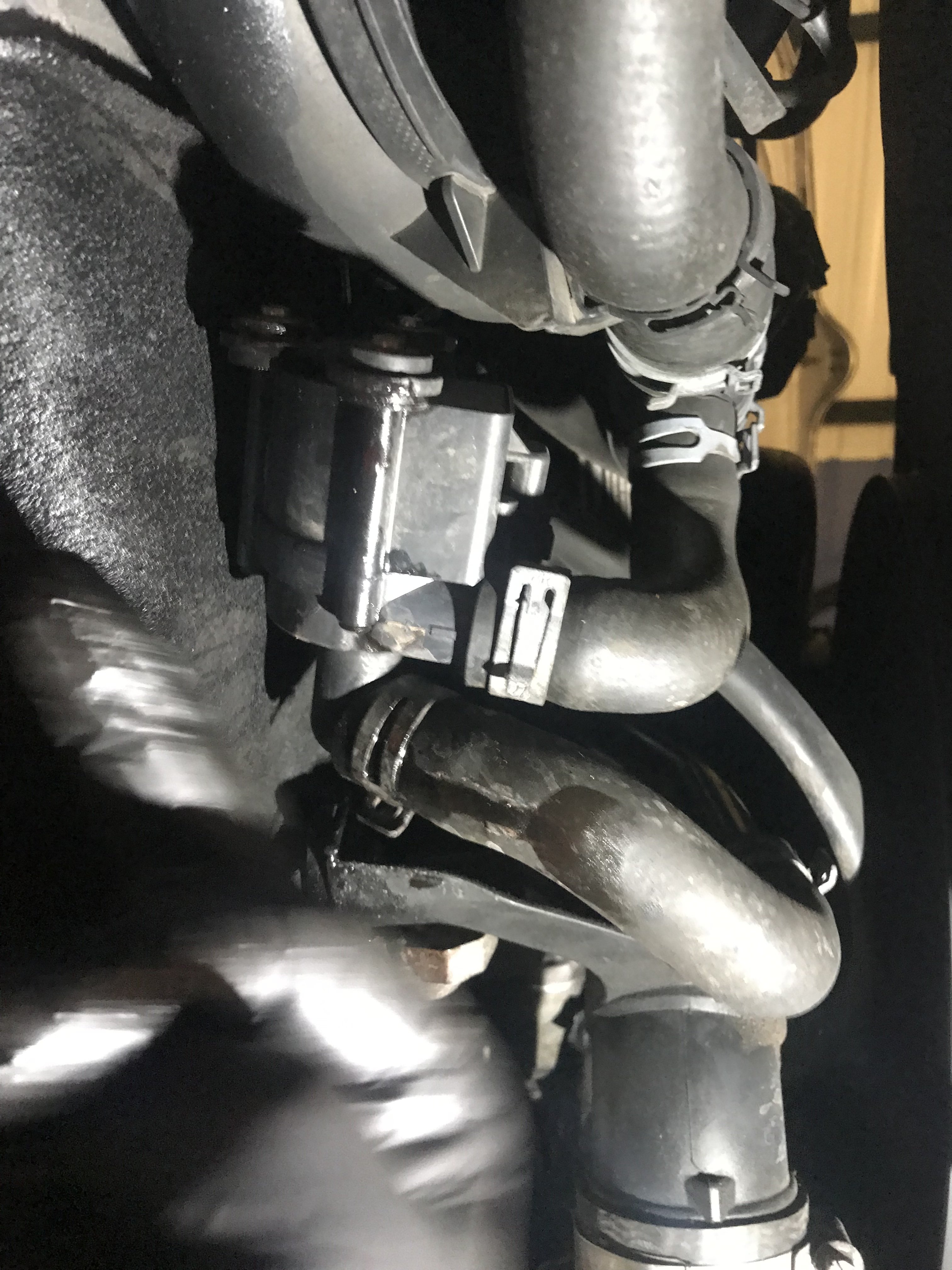

This is the Temp Sensor housing I believe. Garage 2 changed this. It’s next to the airbox up top.

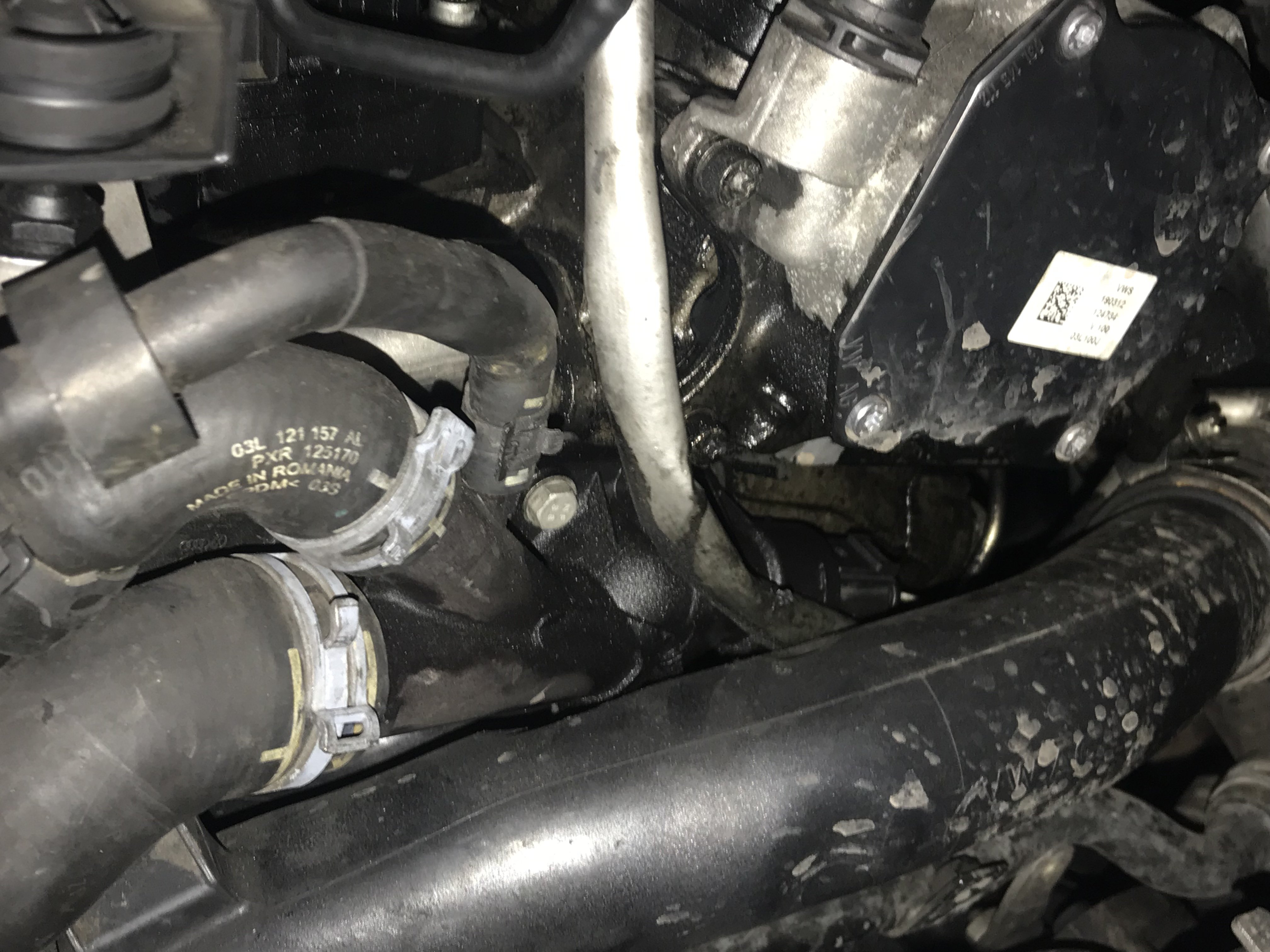

Garage 1 said it was this part. Think he said it was Thermostat housing? It’s at bottom underneath. Not where leak is landing.8632C018-7D53-4B6E-9858-CFB8638A2719.thumb.jpeg.118e96a80462cd5c53c0973ddb8c03bd.jpeg

Re original leak - trying to see where it could have come from. Looks the wrong position for the waterpump (i think) but could it be the EGR cooler?

When the head was rebuilt (local mechanic sent it off, £700 it cost), they rushed it I think, and thats whats caused me all these problems. The cars never felt right since, and then this leak appeared. He said the other day "It could be the oil cooler". Last weeks 'investigation' replacing the temp sensor housing cost me £105, and didn't fix the problem. I'm reluctant to chick more down the drain.
That mess at the back of the engine, is that what you are on about, and Is this likely to to have beeb caused doing the cam belt & removing the head?
