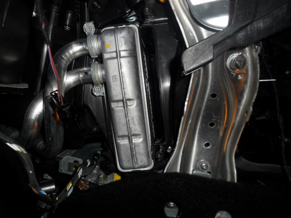

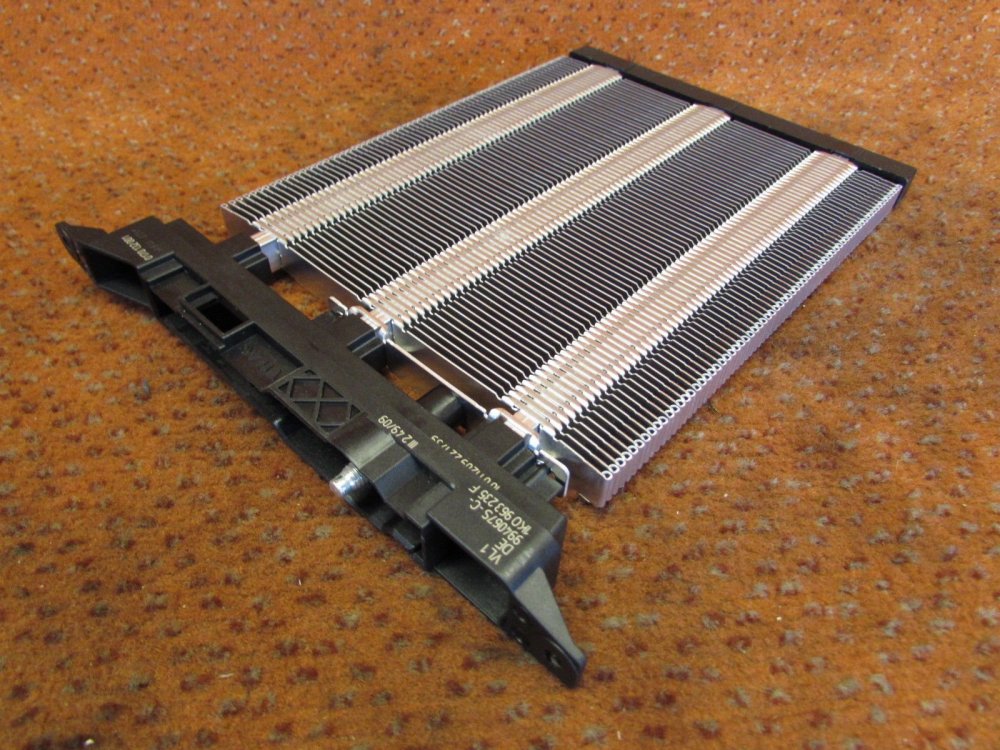

I fitted an aux electrical heater in my Superb
 sure its doable on Oct
Bought mine 2nd hand from eBay for about £15
this year I am going to upgrade to the canbus one that completely  works through heating
I just wired mine up direct to battery through fuse and into a rather stupid big switch
Info here for your

DSCN3534.JPG.45cb5698af6ed19b5ccc6f23f94bf14e.JPG.c33f910e343e4b10043f32c53ba706d2.JPG.6e5e5d10ca88b5bf5be30379afc2ca58.JPG.dcb106d6eead5536daa3f742985e5c19 (1).JPG
That's the fella. How easy was it to fit?

These dont heat up the engine they are fitted inside the cabin in front of the heater matrix
40 mins top with all the wiring which needs to be really heavy duty through a 100amp fuse from battery.
I  am going to fit the canbus revision one next as
Use the search engine you will find loads of info on them

It's not an engine heater I'm after, its a cabin heater coz I'm nesh and only take my jacket off if it gets to 30'c. I have the car set to 27 and it never gets there!! :)
What did you do for a switch @DEL80Y? And where can I find a canbus one? Ebay lists 2 heating elements but no details. One is £27 and the other is £65

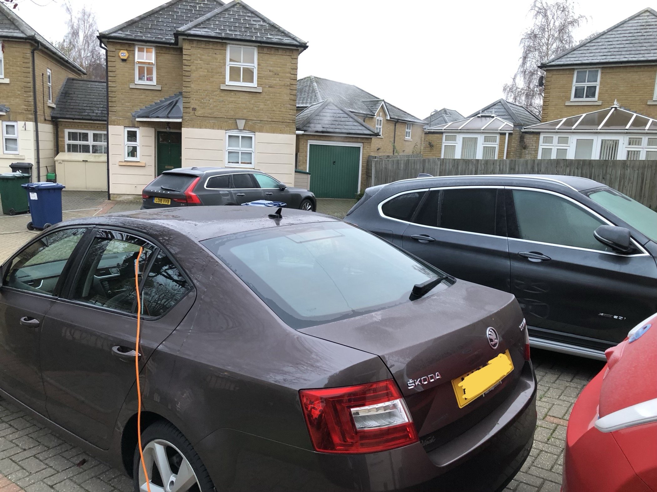

Cabin pre-heating is the best.  Just use a £15 fan heater, an extension cable and a timer. :)  You won't get this with aux-heater, you still have to sit in a cold car initially.
When I got in my car this morning, it was toasty warm inside. The 2kW heater is able to heat up the entire cabin. Only downside is that unplugging is a bit of hassle, having to feed the cable in to the car. My Nissan Leaf EV is much easier to unplug. All electric cars have pre-heating is built-in, this is where I got the idea initially.
Taken a few months ago, first frosty morning:
I can imagine a few people's insurance companies would be a bit twitchy if they knew you were slinging 230v fan heaters in your car whilst it's unattended :biggrin:
