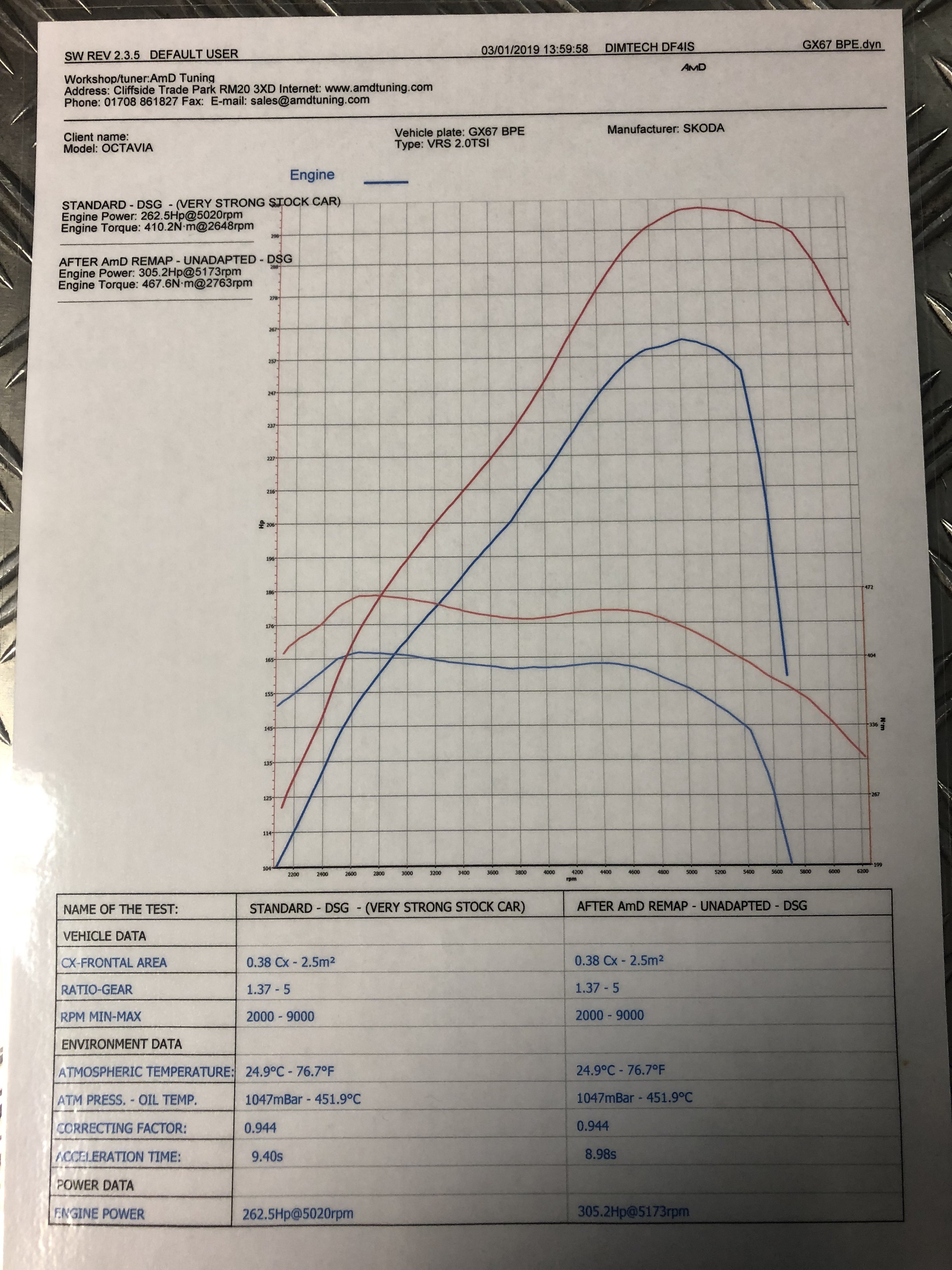

Just had my 245 mapped at AMD
262.5bhp & 410.2 NM stock and 305.2 and 467.6 NM after.
As mine is DSG they canny run full throttle so Ben @ AMD reckons once the DSG box has been mapped and run full throttle, reality will be around 315-320bhp.
So overall, happy boy here.
Scorpion cat cat back next week and then downpipe and stage 2 later in the year.
262bhp stock?
I wonder how much of that is genuine and how much is optimistic dyno calibration?
Edit - a quick look Google around suggests AMDs dyno has a bit of a reputation for being on the generous side, or 'customer happy' as I saw one person describe it :biggrin:
Decent enough gains regardless and a nice looking torque curve, an extra 45bhp (or predicted 60bhp) isn't to be sniffed at, whether it started from 245 or 262...

Had roughly same output at Surrey Rolling Road (Farnborough) with 263bhp being pushed out of my Pre-FL 230. Was running stock with an APR c/f induction kit, and BP Ultimate fuel. Probably less than 260, but definitely more than the 'suggested' output from Skoda, given decent fuel quality, air pressure and all that jazz.

Hmmmm my 245 ran 252.9bhp stock software, Revo sports filter & 99 Ron momentum fuel at JKM Portsmouth know as the heartbreak rollers cos they're damn accurate. AMD could be running 10 high & yeah @Ads230 could be right about SSR maybe running high too maybe, not as much as 10 though.
Hope @Chris245 you take note to change up between 5 & 5-1/2k revs, chasing that red line just slows you down matey, nice mods all the same
I take all dunno figures with a pinch of salt, all subjective on the day and totally different what what you’ll ‘actually’ achieve in real world on the road....all just a guideline.
The car drives so much better and is so eager to get up and go. In gear and midrange acceleration is massively improved.
Also fuel economy seems to be up based on the onboard computer, easily achieving over 44mpg on the run back.
@themanwithnoaim, yes noted ref changing up around 5,500rmp, you can feel the power tailing off after this.
To really understand the best shift point you need to know the gear ratios, as the maximum acceleration is derived from having the maximum available wheel torque.
What you want to aim for is the point at which the wheel torque in the gear you're changing to (which will hopefully be on an upward trend) is equal to the wheel torque in your current gear (which will likely be on a downward trend). This won't necessarily be the same rpm in every gear as different ratios give different torque multiplication.
As an example without specific numbers but the shift from 1st to 2nd is likely to be better done at very high rpm because the massive difference in ratios mean its unlikely that 2nd gear will provide equal or better wheel torque at any comparative shift rpm.
Engineering Explained on YouTube made a good video explaining the principles but using an S2000 as an example.
If we have the ratios of the DQ380 and the final drive it's relatively simple to make a spreadsheet/graph of torque that'd identify the best rpms at each gear based on the dyno plot but as yet I can't find any info on these.

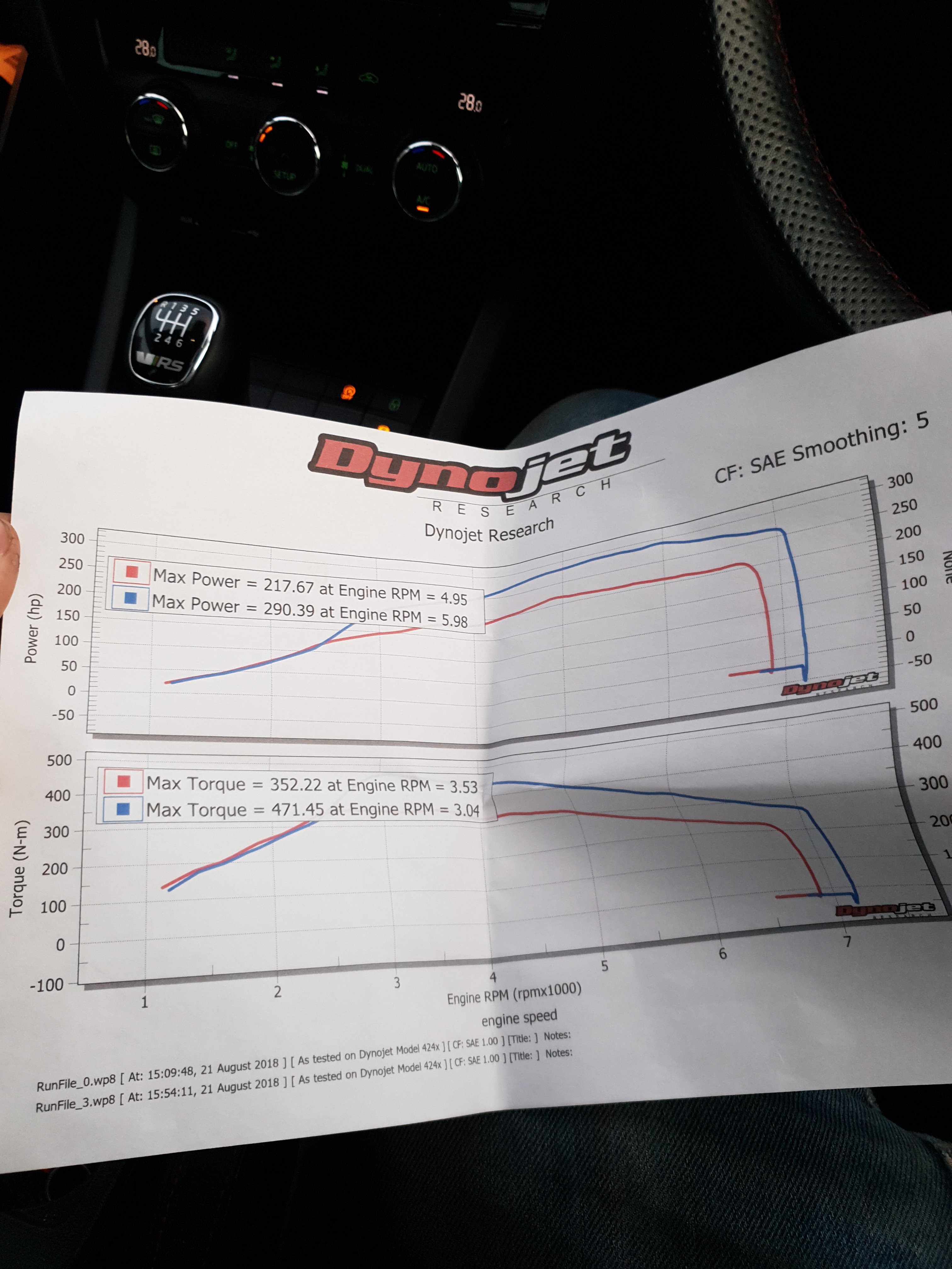

Reason I ask is my graph is in WHP according to the mapper, but nobody ever believes the figures he reckons he got out my car, he does have a reputation for getting the most from vehicles though, everyone I know with Evos heads there. I doubt the figures myself, too. It would just be nice to know exactly how much I've got, I'm not bothered what they come out as, as it's fun to drive regardless.

Hi Chris well done on a good choice for the remap. Everyone has ignored the FACTS that your 245 isn't standard as you have the Ramair intake and elbow which will increase the amount of air going into the engine. This explains the extra 14bhp and extra 10NM you achieved compared to my run on the same rollers plus it was slightly warmer last March which can affect rolling road figures. Even though my car was completely standard when it had the stage 1 map there at AmD it produced very similar figures to your car at 302bhp at 5,500rpm and 467NM at 2,700rpm. Also as someone already stated best to change up at around 5,500rpm as power tails off between there and the 7,000rpm redline. Not surprised your economy has improved still getting 44-46mpg even at stage 2. ENJOY.:thumbup:

This is very true so slightly misleading when it says stock car as its not quite. I was expecting somewhere between 300-320bhp as per what Ben @ AmD has said and as above, as the DGS is not mapped he cannot use full throttle as it wants to kick down so his estimate is 315-320 as it stands today....but that's just on one dyno and on the day, could be different tomorrow and to me they are only ever a guide figure, its all about how it is on the road.

Also demonstrates that the 2 Ramair components give more of a benefit to a standard car than stage 1 as you only gained 3bhp over my stock car and same 467NM of torque which shows standard induction system is pretty good. NOAIM also realised this when he replaced his standard induction system with an aftermarket item and actually saw his power drop from 290 to 287bhp using a DTUK tuning box. He also used the same rolling road both times in Portsmouth for accuracy purposes. When you go stage 2 you can expect between 330-340bhp.:thumbup:
