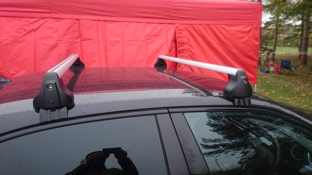

I have the Skoda bars (got them thrown in with the lease deal) and all I can say is that they just fit perfectly.
Having said that, I have no reason to believe any Thule set-up wouldn't be just as well fitting.
Personally I have Monte Blanc bike carriers, but not heard a bad word said about the Thule 598.

Thanks for the advice. They look neat. Sadly couldn’t get them thrown into my lease. Tried but then did get good cashback so swings and roundabouts.

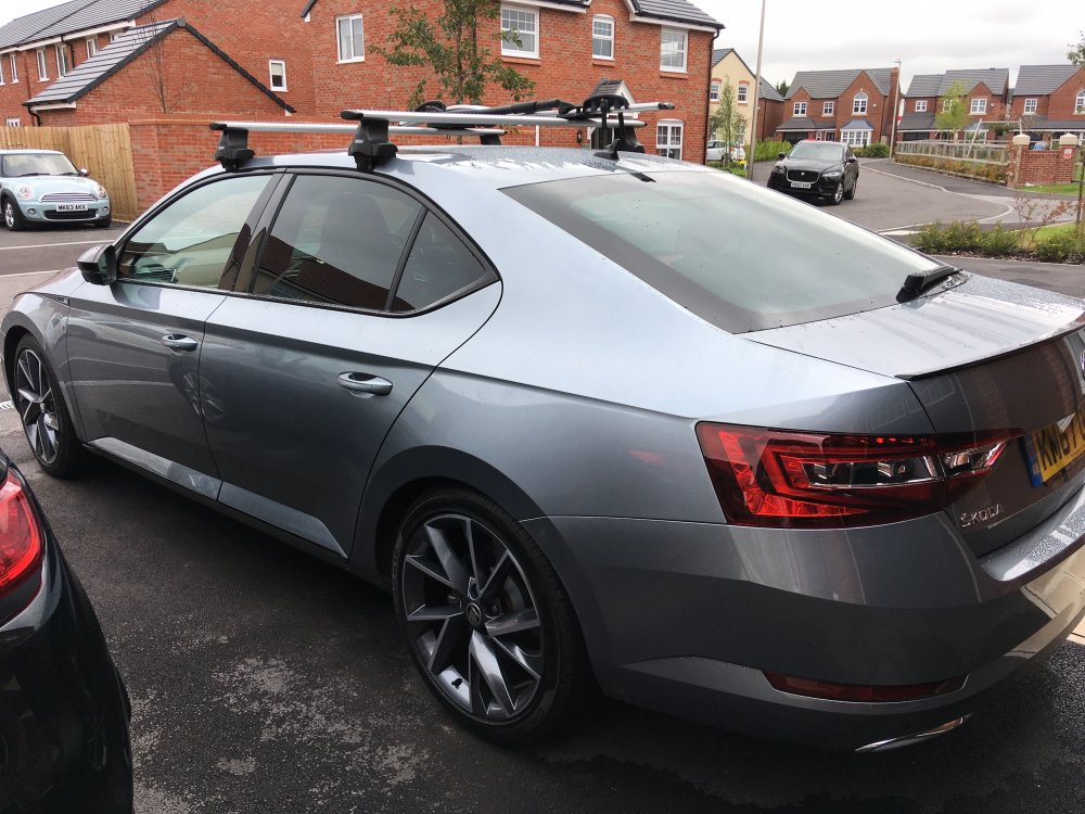

I have a Thule wing bar setup on my Sportline with 2x 598 carriers. It fits really well, better than it did on my Octavia. The 598s are really easy to use too and with the T-bar mounting you could likely get your 4 bikes on the roof, though you may have to mount them alternating forward/rear facing.
Another thing to consider is, can you transfer your roof bars to your next car whenever that may be? All I needed for the superb was the purchase of a new fitting kit for the superb and was still able to use the existing wing bars.
Photo is with just 1 carrier on, but gives you an idea of the room on the roof.

I have the same setup as GrahamVRS - Thule Wingbar + Thule 754 feet + Kit 1726 (Superb/Octavia HB). I can put up to 4 carriers on it (Proride for Alloy frame bike and Thruride for carbon frame bike). I would recommend getting Thule since you can easily use it with your next car changing the "kit" or feet if the car has rails. Škoda specific bars will not fit anything else...

Hi, do you notice that when you remove them the rubber seals on the windows are misshapen and do they let water in when removed due to the seal being misshapen?

They fit better around the seals than they did on my Octavia, but they haven’t mis-shapen the seal. I only use the rack a few times a year when we travel to family/holidays and it’s a 10-15 minute job to fit or remove carefully.
