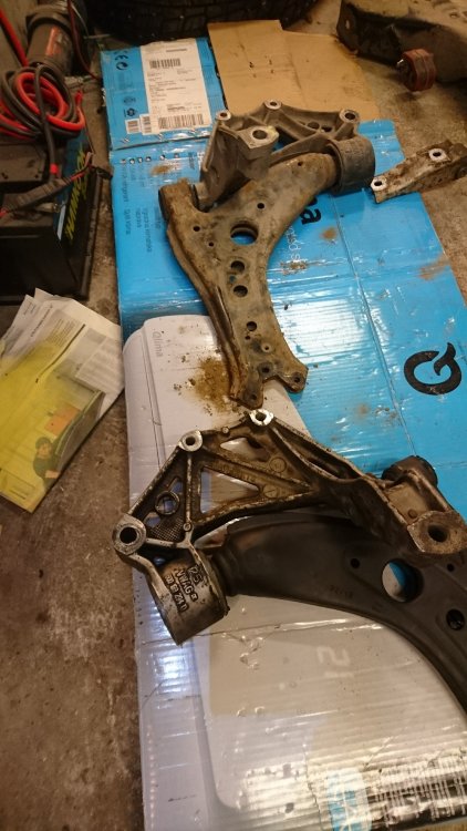

Hello,
I'm trying to change rear bush (big one)
It is just nightmare, very difficult to get installed...
First, how do you get bush all the way in? And second, how you get arm all the way through bush?
Situation now: lip of bush is ~5mm from arm and arm isn't enough penetrated because it's 1-2cm away from it's place where it bolts.
Any tips?

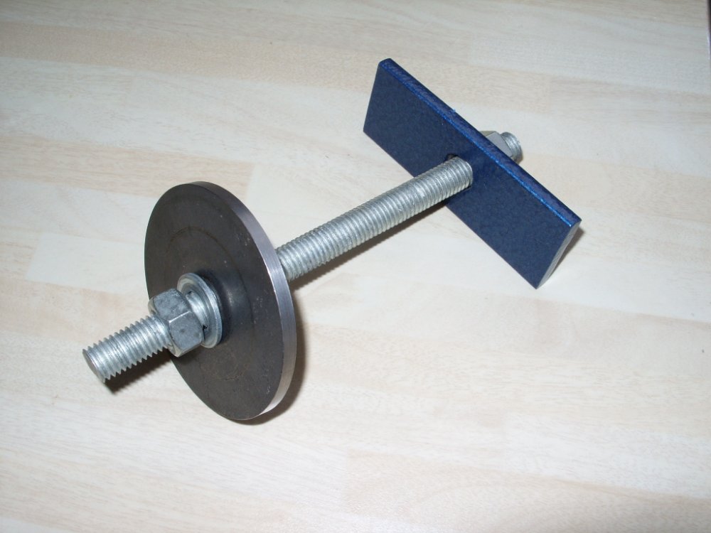

I made my own tool for installing the bushes...
I made that too but it broke bush.
Bough new one and cleaned arm hole. Still no luck. I'm going for urethanes.
