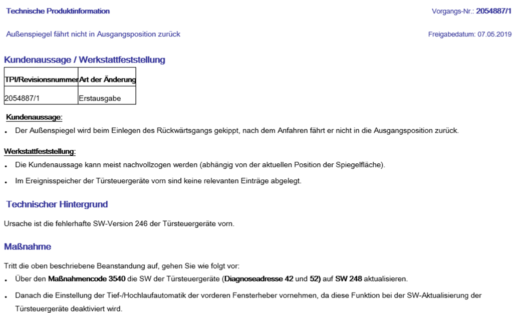

There is a TPI dated 07/05/2019 - 2054887/1 - I only have it in German, but your dealer should be able to cross-reference:
Thank you for this. Car booked in next Thursday for the software update. I will let you know how I get on.
Thanks for this update. Confirms I'm not going crazy when it does work sometimes. My wife is German so translated it for me. It details everything that has been posted about the issue.

Don't suppose anyone has a UK TPI, or any other information on the software fix as my local dealer says they can't find any details!!
Thanks; so the UK TPI is the same number as the German one?  Local UK dealer say's they checked using the German details and couldn't find anything (Think it may be time to try a direct dealer!).
Just gave my dearer the TPI number and they found it on their systems.
Just booked mine in. Apparently there is a v2 version out.
2054887/2
