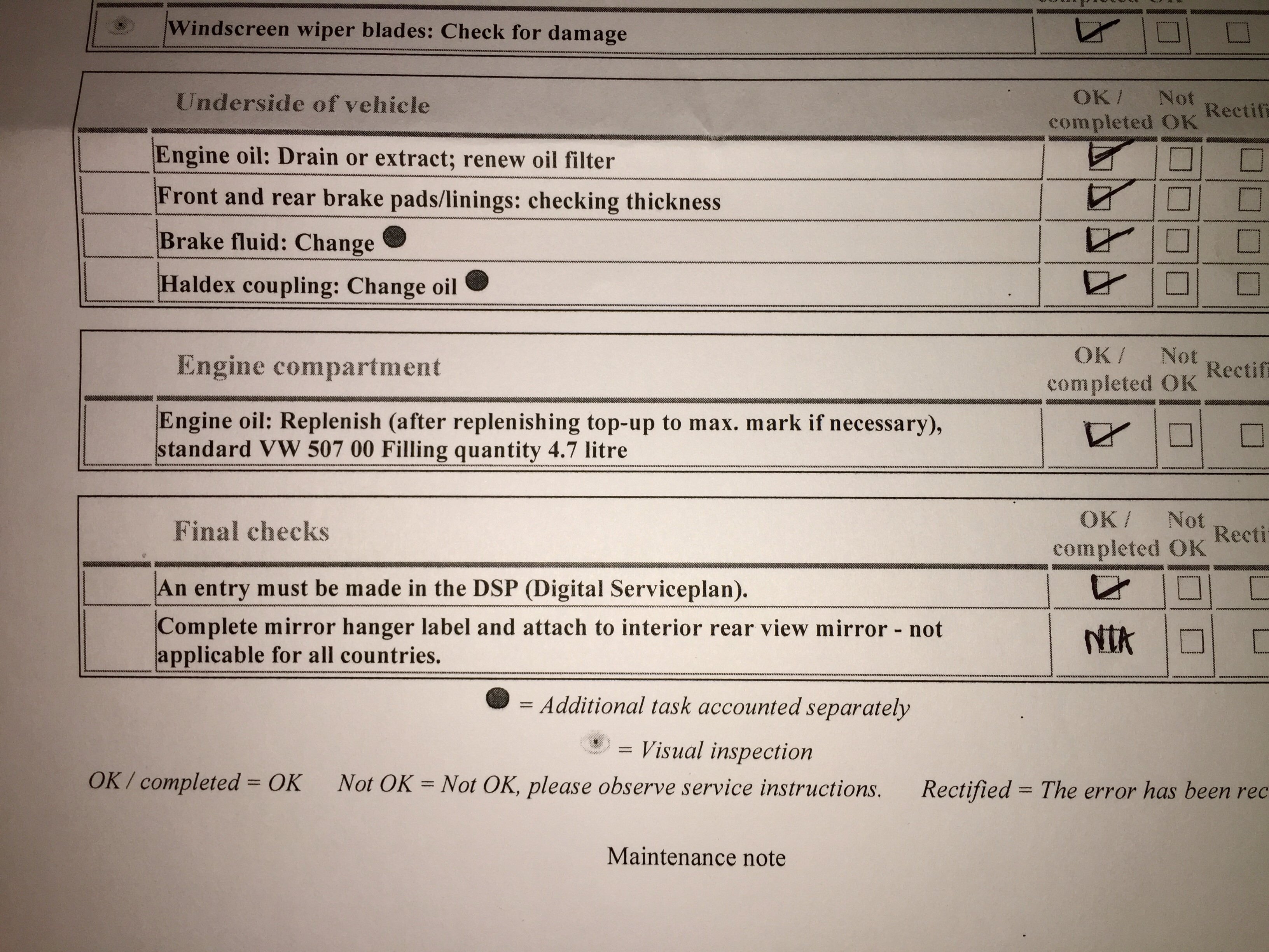

Just had my car serviced and MOT'd by Skoda Yesterday and it states 4.7 ltrs of oil on the worksheet
