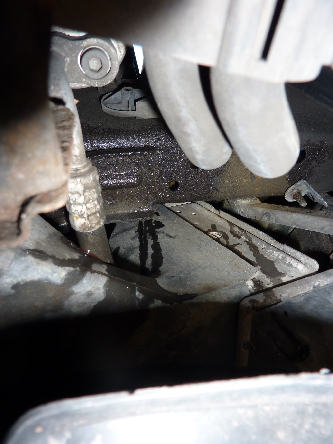

Hi trusty Briskodians,
I've been losing coolant for a few weeks now, but I'm not doing many miles so not overly panicked yet.
I've now had a good look and i would say it appears to be coming from the underside of the reservoir itself.
Is it easy to get the bottle out to have a proper look, or is it likely to be something else?
Thanks for any advice.

if you remove the fixings from the tank you usually have a good amount of play on the hoses to take a look at the underside
And coolant bottle leaks arent exactly uncommon... or it maybe a perished hose end attached to the bottle..
Doesn't the overflow for the cap exit the underside of the tank ?
Possibly faulty pressure cap ?
Coolant system over pressurising due to HGF ?
My first thought, I must admit.
Check for residual pressure in the expansion tank when the engine is stone cold.
Ok well i checked under the water bottle, and there's no obvious split in the hose, but the overflow outlet looks a bit crusty.
I suspect you're right about the head, or head gasket.
Taking in to local garage tomorrow for them to take a look.
Guess I'm going to have to face the dilemma of an expensive fix to a cheap car... (and probably further age related problems) or bite the bullet and save the pennies for my next one....
