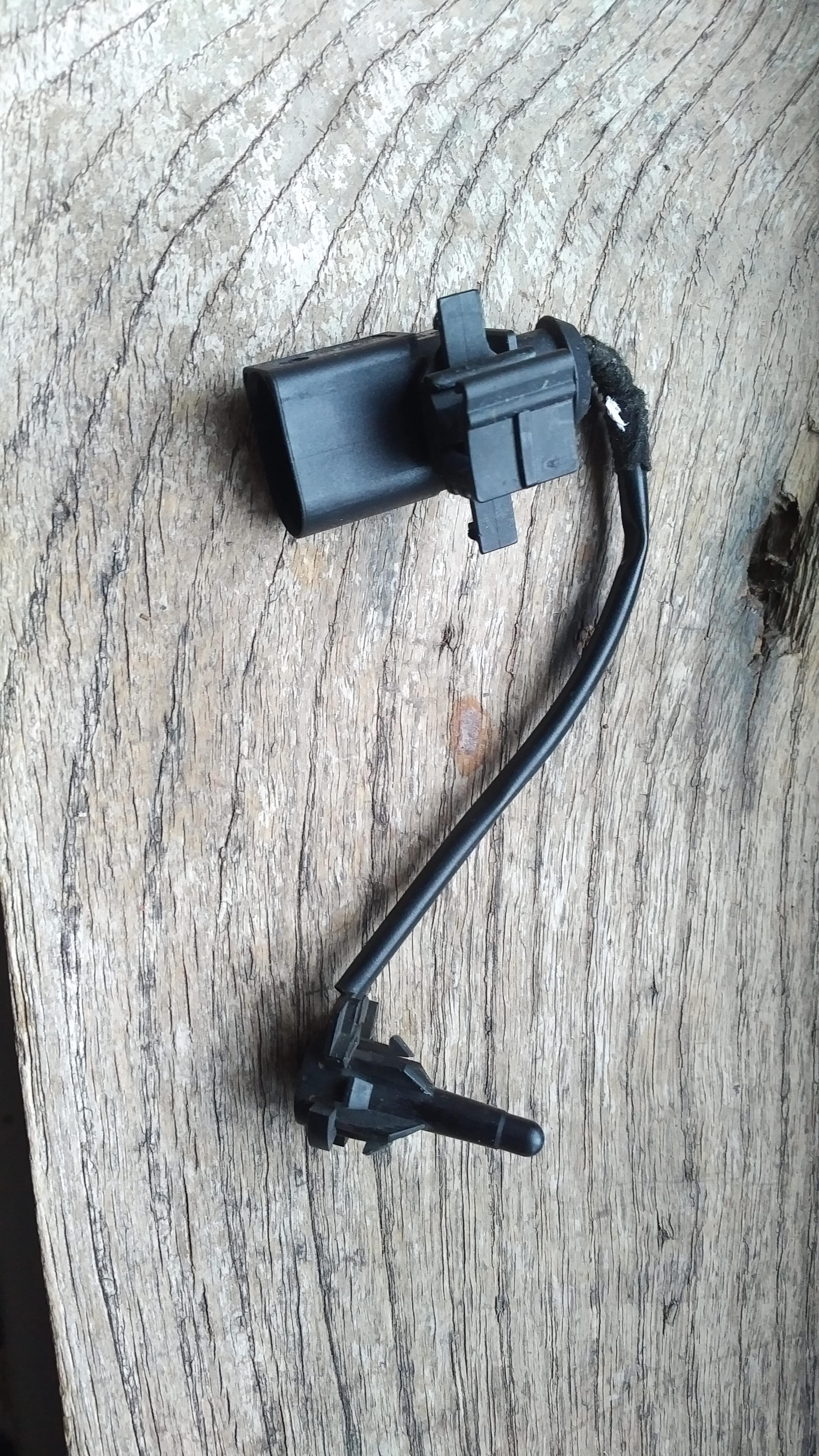

Attached is a pic of the offending sensor. Now the outside temperature on the Passat reads the same as the Octavia parked along side it. That's the problem fixed. Don't understand why explanations of temperature calculations for boost/ intercooler etc are relevant for the posting. Thanks all the same.
Regards
