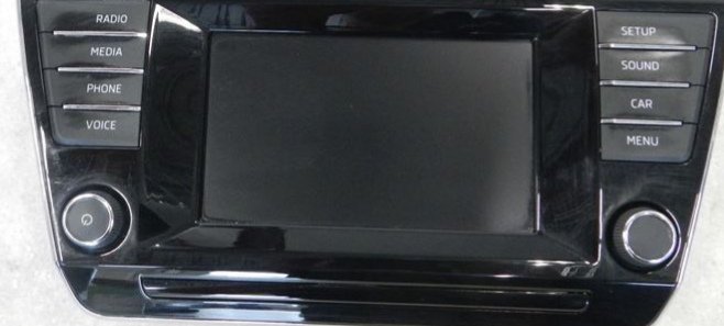

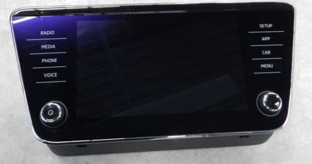

I want to make 2 retrofits to my Superb.
1. Virtual cockpit.
2. Better screen.
I know that the virtual cockpit is possible but how about the better screen? I have found the screen that I want. Can I do it Plug and Play?
I think I have the smallest screen available. Posting picture of my screen today and the one I want to install.

The referred screen is actually 8", its just the new glossy type with touch buttons. I have the same idea - to upgrade the old Columbus 8" screen to the newer Amundsen 8" screen and add the virtual cockpit.
Yep!
It's not the 9,2". That one has no buttons to the right.

Does anyone know the name of the screen that I posted?
Its the standard Bolero screen from MY18 I think. The Amundsen screen part number is 3V0919605D.
Doesn't matter if it's the 8" screen, buttons or no buttons - it's the same process u go through with regards to the component protection.

Hello ,yes its possible i have it , go see my topic bolero 8 inch screen. You must have mib 2 .
Also interested in this.
Screens don't have Component Protection, if the resolution of your old unit matches it should work
