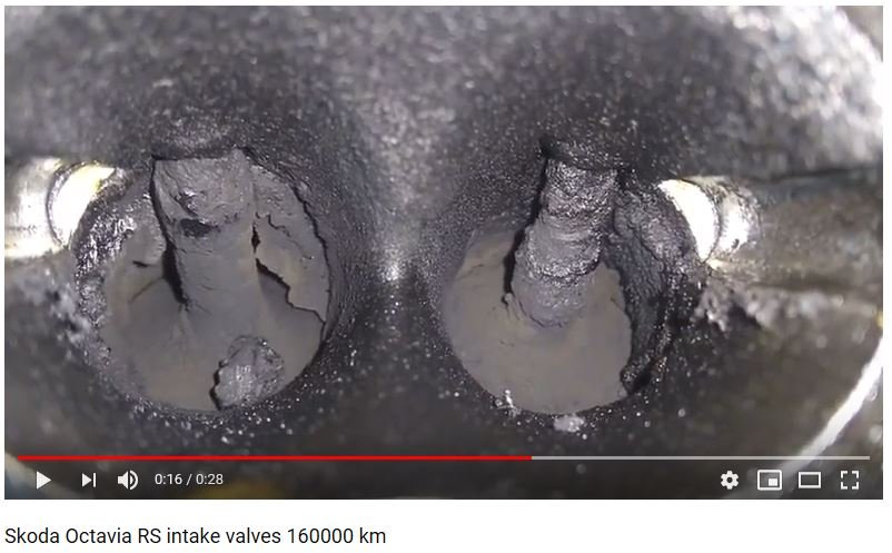

I located the  thread on an Australian Forum and the engine is not an older 1.4tsi but the older 2.0tsi (non dual injection I think)
http://www.vwwatercooled.com.au/forums/f149/skoda-octavia-rs-my11-new-intake-manifold-carbon-clean-diy-walnut-blaster-1of2-123757.html
I've taken a snapshot from one of his youtube videos showing how bad fouling can become over time.
I must admit I bought my 1.4tsi knowing it had DI but not knowing about historical issues with DI. Upon discovery and initial panic it was a bit of a relief to find out that my engine should be ok as I intended to keep the car for a few years past the warranty.

Yep, that is a typical image of DI engines of previous generations with big mileage, but 160K is probably bit over the average owner's total mileage with one car. If I appreciated a car so much as to keep it for that long I wouldn't mind paying for a proper valve cleaning  .
