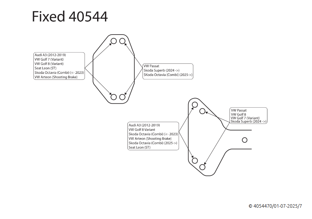

Looking at the fitting instructions for the brink towbar as an example.
The cross member can be fitted to the side beams in two optional place depending upon Octavia and superb models, the superb mounting bolts are lower, could that possibly be the error.
https://www.pfjones.co.uk/Thule_Brink/4054470.pdf
If you get underneath and have a look it may be possible to see for yourself?
