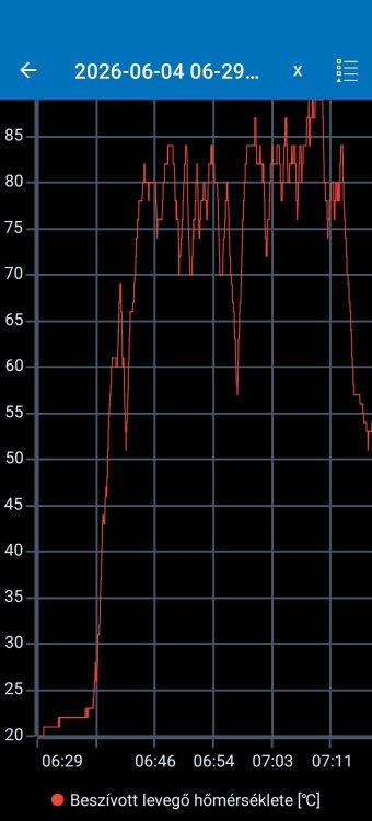

I have a Skoda Fabia with a 1.2 AZQ engine. I have a warm running issue - the car misfires/stutters when fully warm. The intake air temperature (IAT) reads around 80°C when the problem occurs.
When I unplug the EGR connector the car runs perfectly and IAT drops to around 30°C.

Unfortunately, this test did not yield any results either. IAT temperature is still above 80°C.
