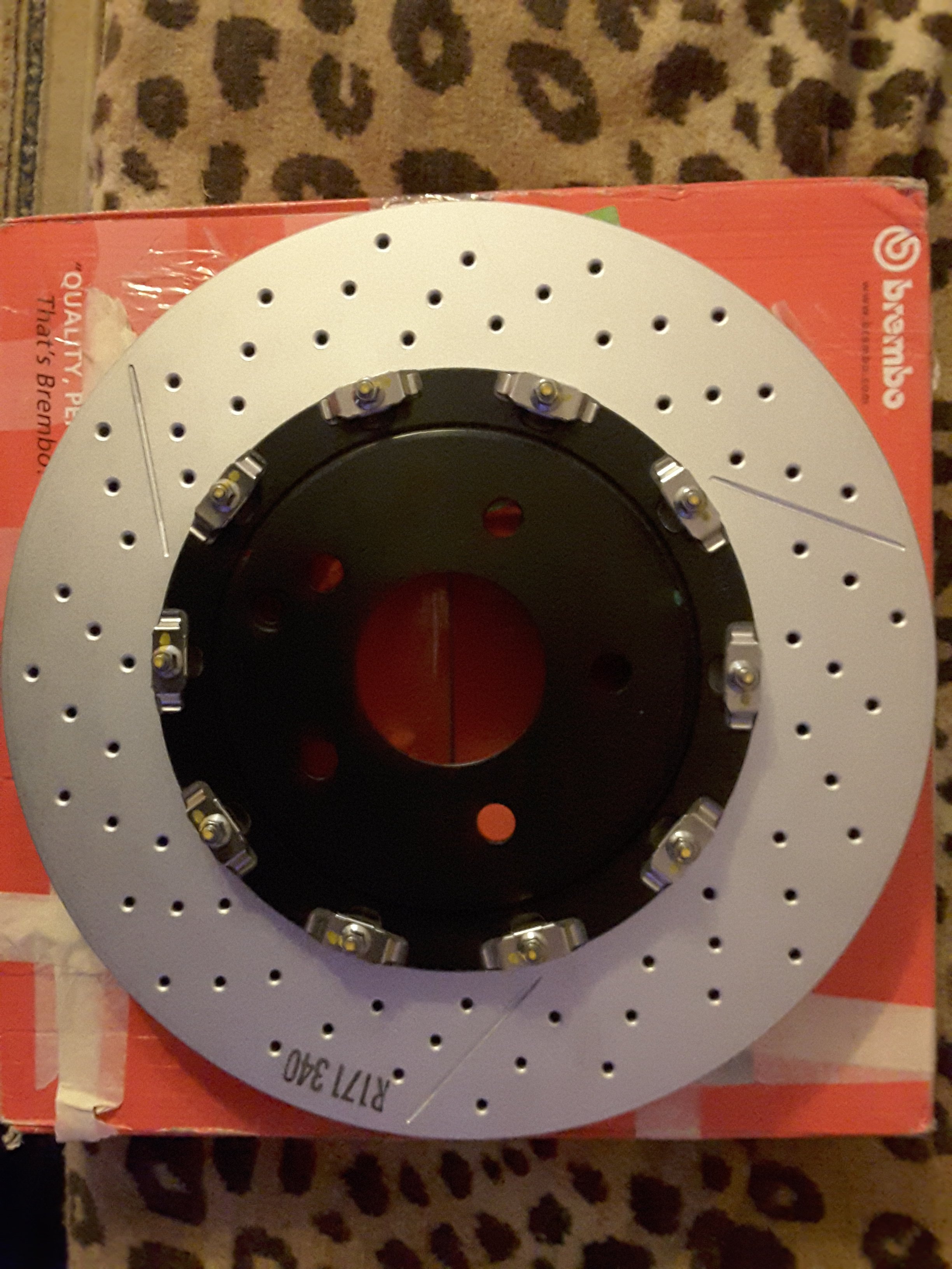

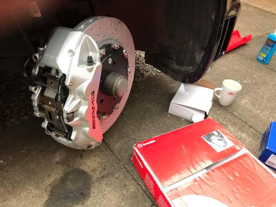

What, like these bad boys....B)
Exactly.
Or like some Porsche, Bentley or even owners of Performance Audi might expect to be fitted.
