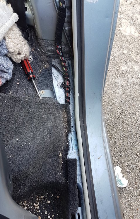

The passenger side footwell, front & rear, occasionally gets soaking wet. I think in heavy rain mostly.
I read about the rear washer pipe connection splitting here, I checked that and it appears to have leaked at some point, however I don't think that's the main cause of water ingress because the washer pipe has been split under the bonnet the last few times this has happened, so washer fluid hasn't been getting back there lately.
I read there's a common fault that caused water to come in, this topic, however it doesn't give much detail as to exactly where it's leaking or how to fix.

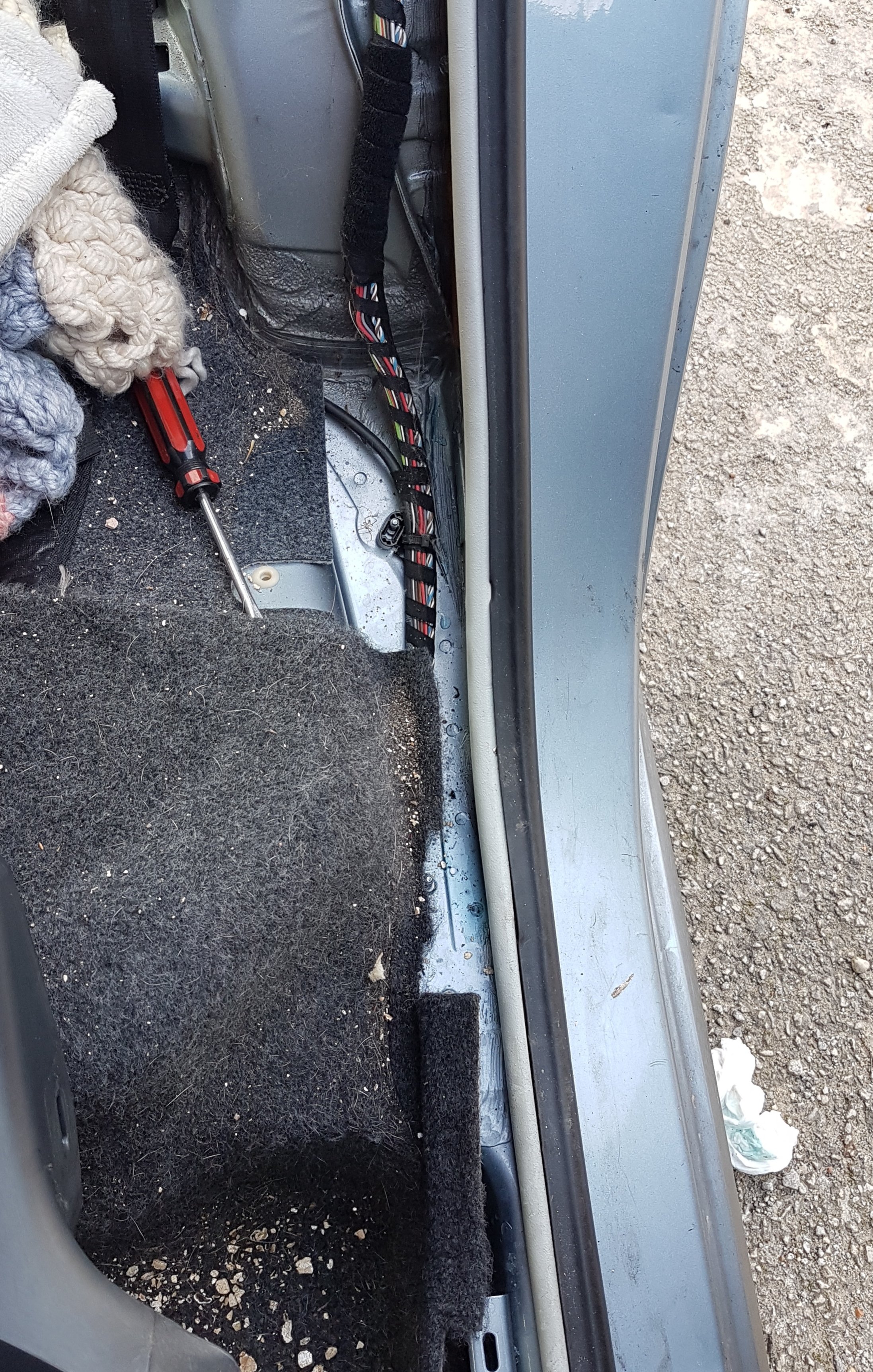

The underlay is mostly wet in rear foot well, at the back.

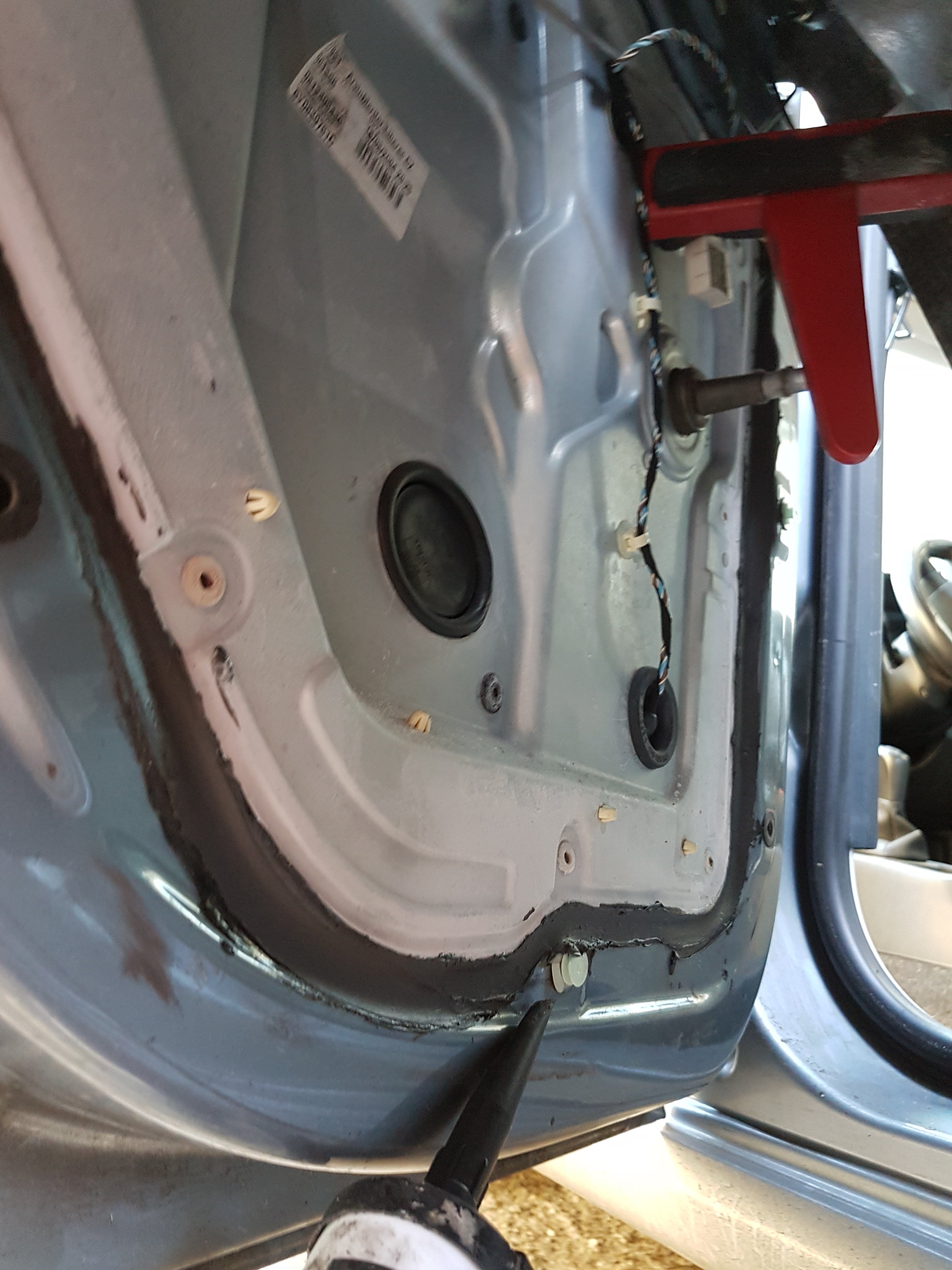

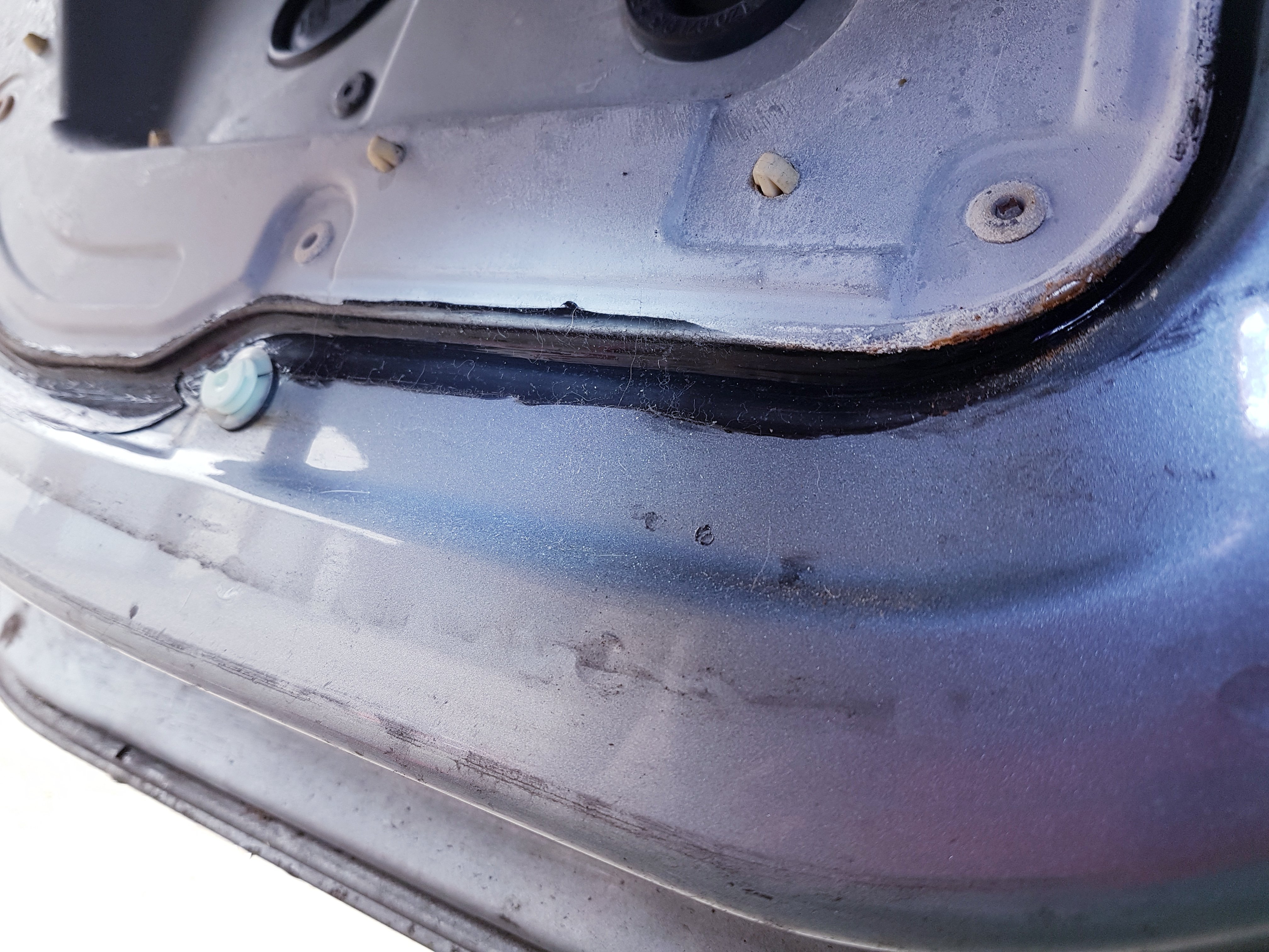

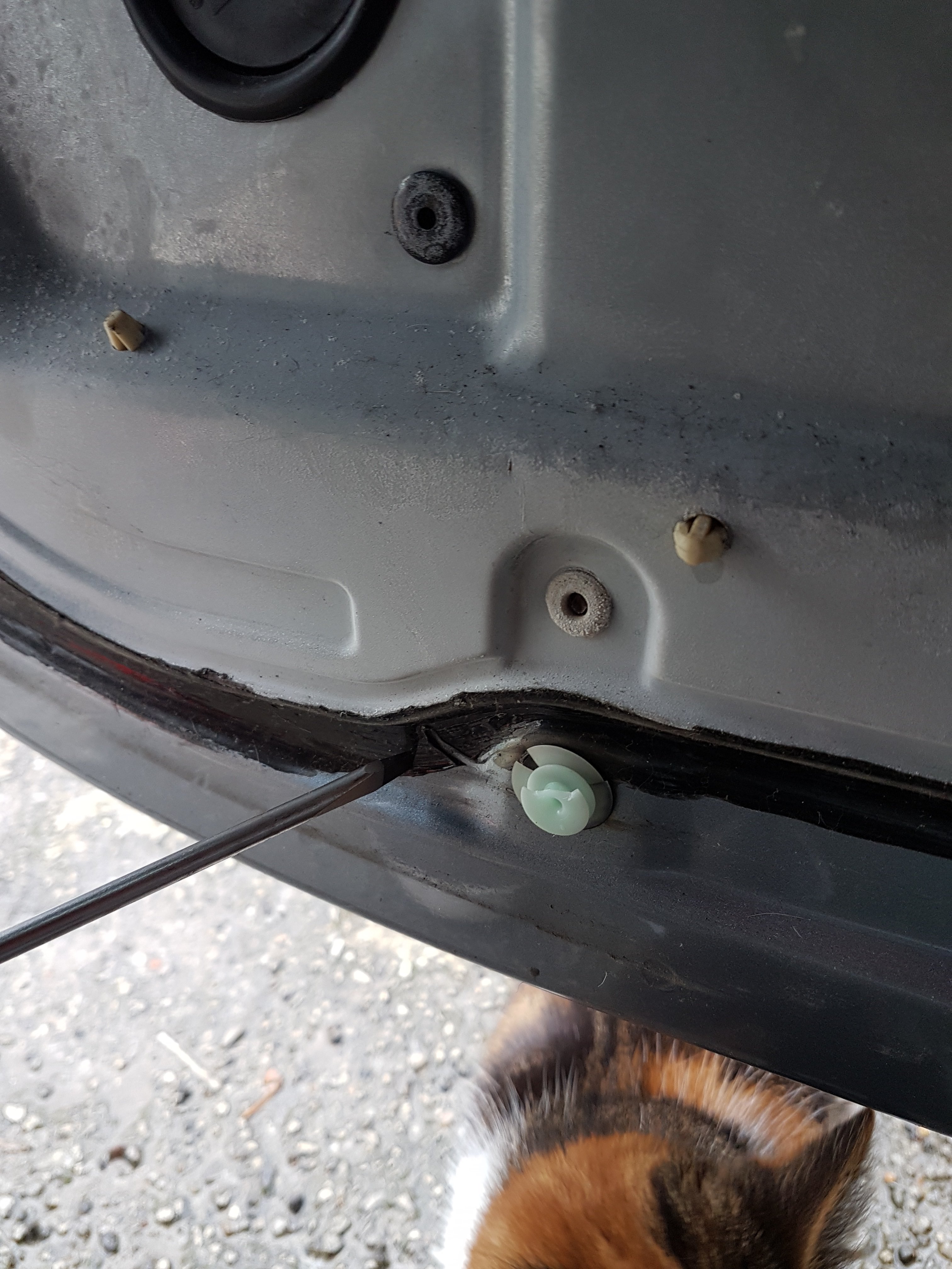

This is the bottom of the inside of the door. The sealant already there looks fairly well intact. There appears to be a bit on corrosion on the right side though.
  • Sponsor
Can you take a pic from further away, to show how far up the edges is sealed?
  • Sponsor
Isn't the sealant broken away from the metal just to the left of the trim clip?

Here...? No, I don't think so, it's just a kink in the sealant line, it's still sealed.

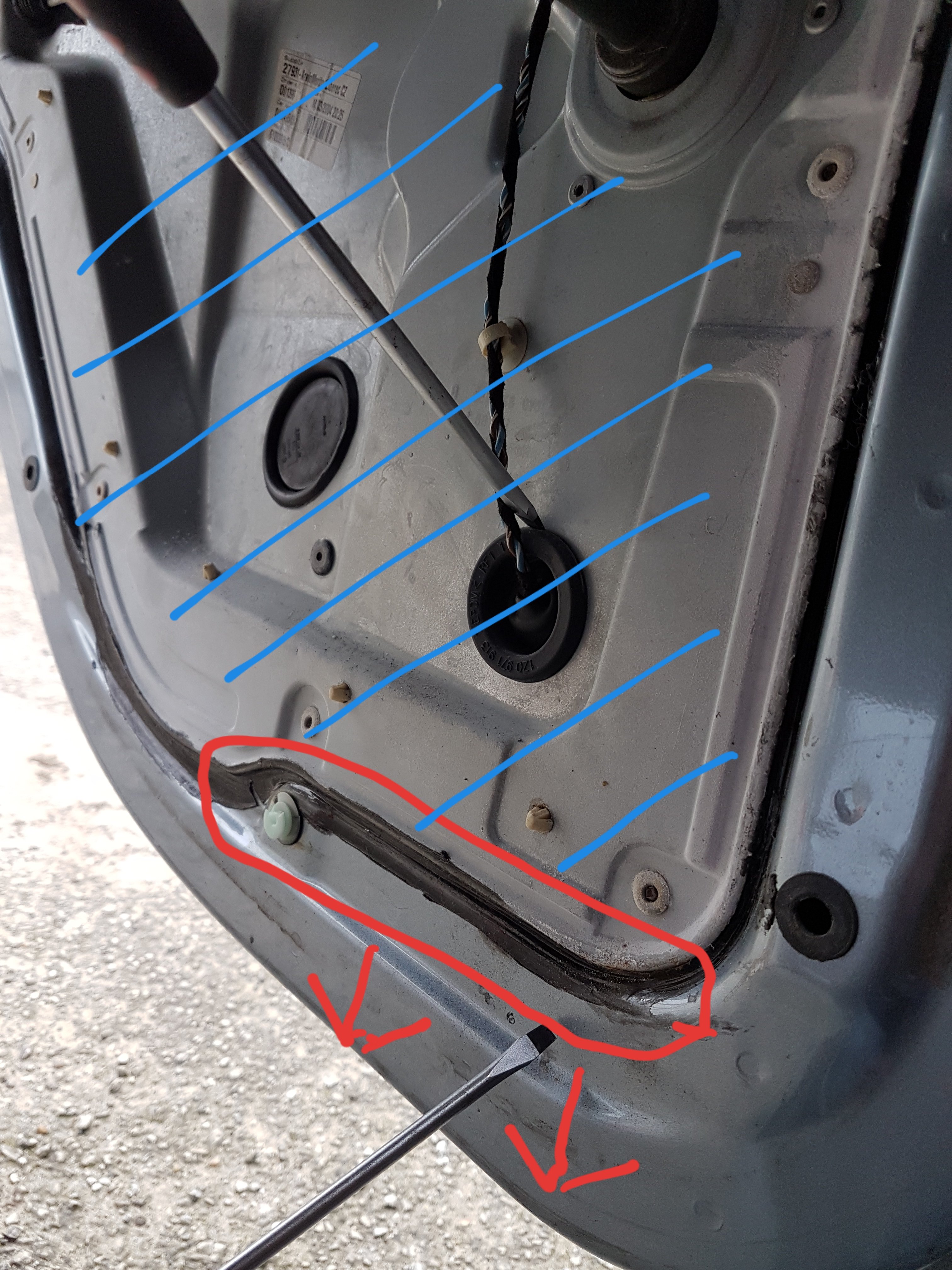

So it's runs down the inside of the bit marked in blue, then comes out of at the bottom red area, runs down onto the foam seal?
The black sealant there goes all the way up and round.
  • Sponsor
Yep, except it probably mostly originates above your highest blue line, on the back of the panel where the black plastic bracket attaches. You'll see three black plastic rivets just out of shot above the top left of that photo, which is where the bracket attaches to the back of the plate. Water could run through the seal way up there, as well as where you've marked in red oval.
It's easy to break that bracket if/when trying to remove the carrier panel, as it's designed to stay attached to the lock unit. I decided not to refit mine, as I could see its potential for channelling water onto the carrier. Tech1e has removed his too, judging by the arch-shaped bit of tape in his photo (covering the holes where the rivets used to be).
If less/no water gets onto the carrier, the seal isn't so critical.

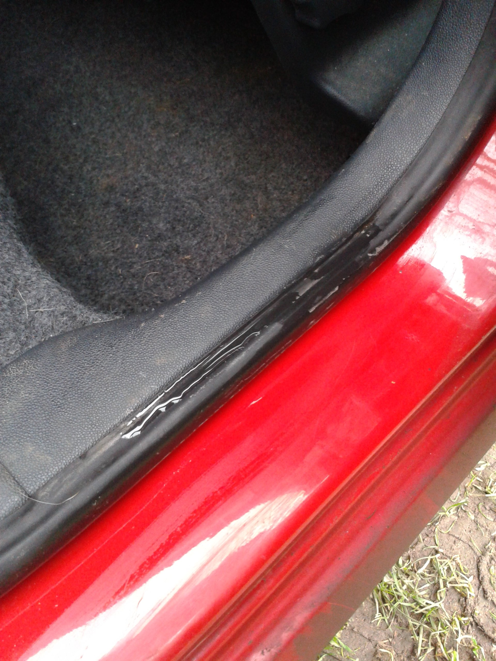

Fix the washer pipe so that you're convinced that's out of the equation, then monitor the rubber seal at the bottom of the door orifice after any rain. If there are little puddles on there, the carrier is leaking, if there aren't it isn't.
This is artificially poured on to illustrate the area to look, but it will be there to some extent whenever the door carrier seal leaks.
Just re-reading this again, the foam seal in question is between the carrier panel and the door metal, not the one I've suggested inspecting after rain. It's a flimsy neoprene foam affair that you'd barely consider waterproof to look at. Can't really see much of it (except edge on) unless the carrier plate is unbolted/unriveted. Second photo in here, it's the dark grey rim about 8-10mm wide all round the perimeter: https://www.briskoda.net/forums/topic/311048-thanks-briskoda/?tab=comments#comment-3720232

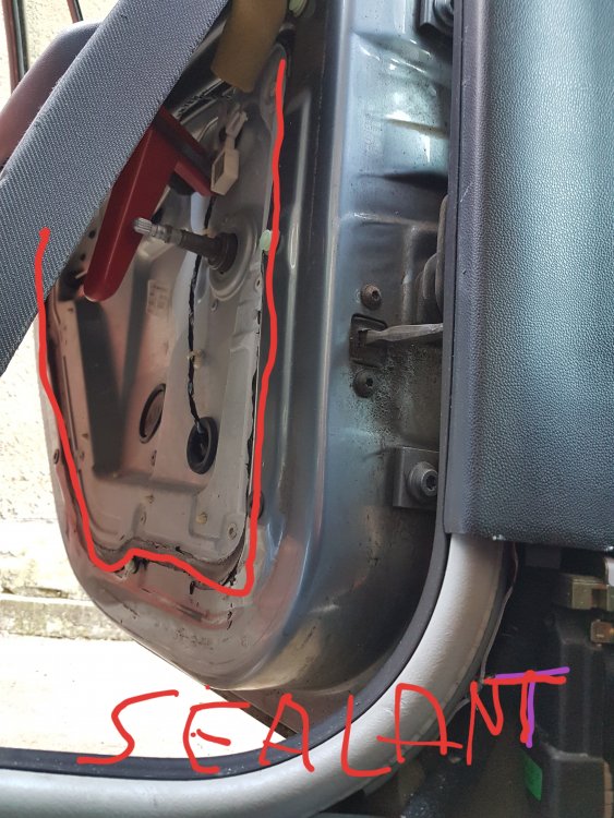

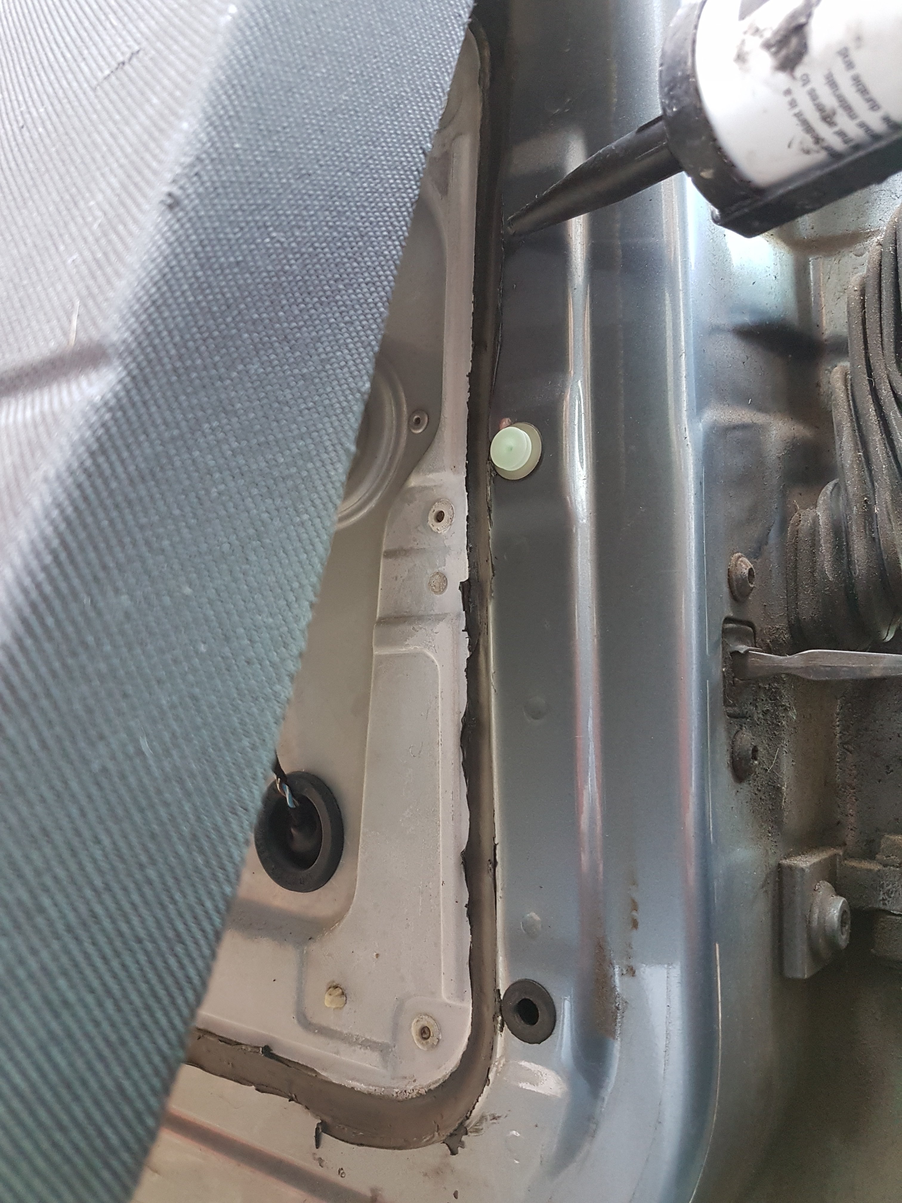

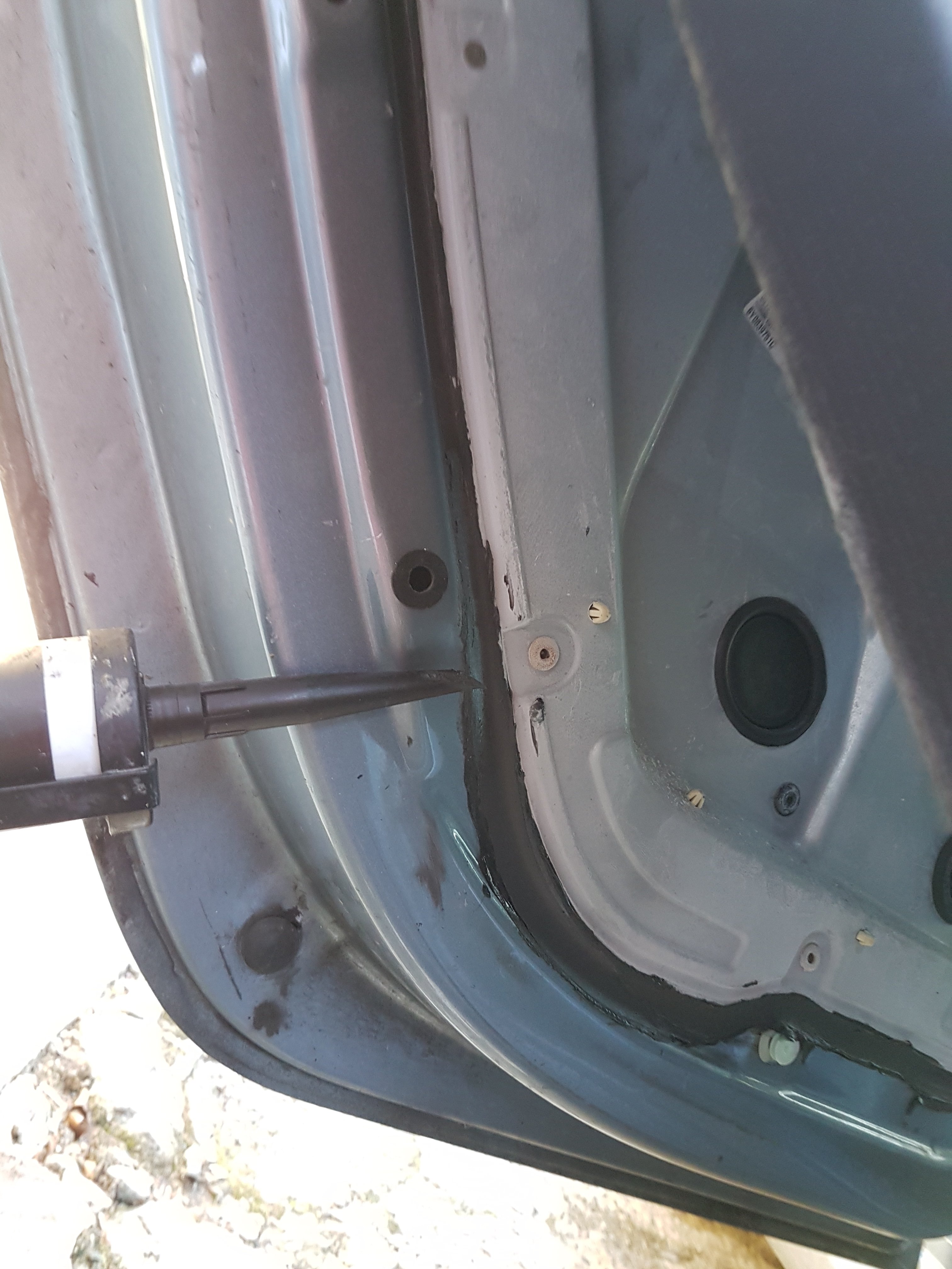

Thanks for all the help & advice on this. I finally got round d to putting g some sealant on where the think the problem is, pics below.., have I sealed in the right place? Ive gone right up the sides, to near the top. Anywhere else I should seal?
  • Sponsor
Looks OK to me, but there's no need to go that far up the front edge (nearest the hinges). half way is ample there. What sealant is that?

No Nonsense Roof & Gutter from Screwfix. Had some repairs to do on garage roof & had plenty left over so thought it'd be ideal.
