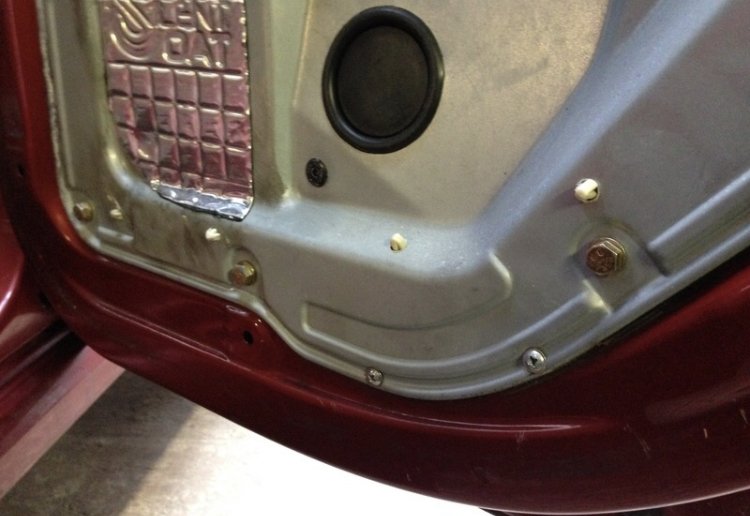

Fabia 1 wet passenger footwell

I hope you replaced those door trim panel clips.
A couple of extra self tappers also help pinch the reg up tight

Extra support there has to be a great idea. If I ever have to re-visit ours again I'll be doing the same.
Might seem that added sealant can easily waterproof this junction of door and door carrier, in a static situation.
Just think though folks - what happens to that area when/if the door is slammed? It will try to carry on after the door stops, under its own momentum.
I bet if you could do some freeze-frame photography of the carrier as a door is slammed, you'd see that area 'flap' on an 'as built' car.  This is probably why a lot of repairs aren't successful, because people don't think of the forces that might act on the sealant, and underestimate what the joint needs to cope with.
No, I don't have any of the panel clips.
Are these ok? Clips
Are these ok? Clips
That don’t have a seal on them. No seal and it’s going to **** in just the same
Ordered some. Thanks.
