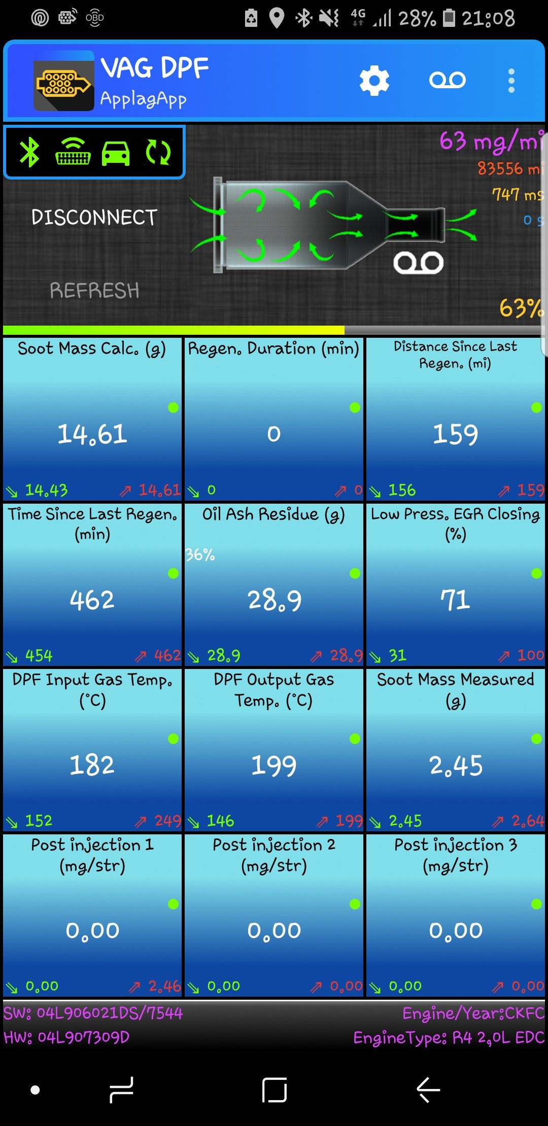

How do you know if you car has gone into regen mode? Is there a warning light on the dash telling you? I've done a few hundred miles since getting mine and never noticed anything yet...
I can normally tell when the revs start holding at 1K when Idling but I invested in a bluetooth dongle from Amazon and the VAG DPF app which shows you what's going on with your DPF i.e. when it's going through a regen, how long since the last regen and probably more importantly, how much oil ash residue it has as this will ultimate determine when your DPF is at the end of it's serviceable life (which from general consensus on here seems to be 150K-170K depending on useage & driving pattern).
Mine seems to regen every 300 or so miles.
