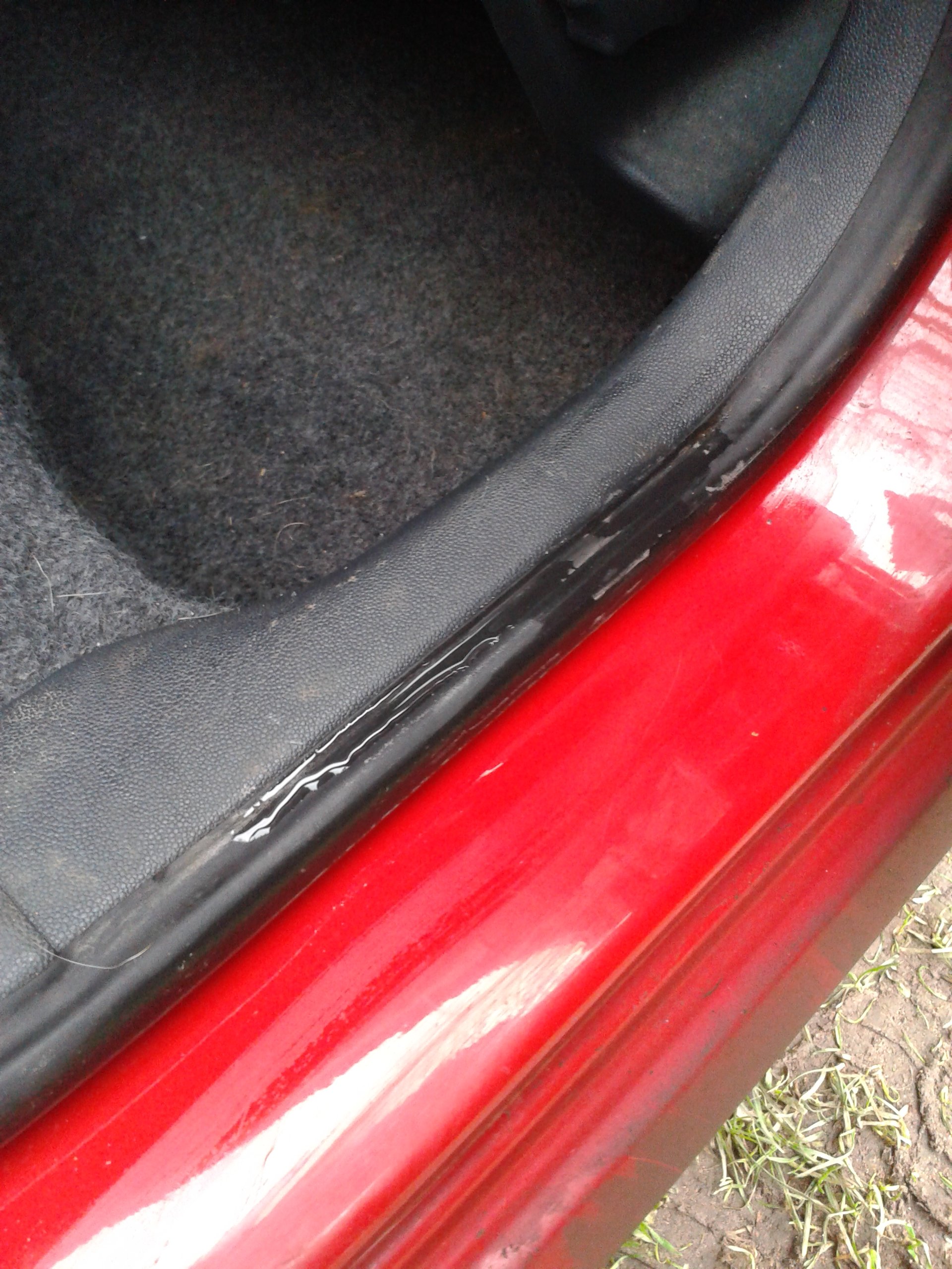

The dead giveaway for door carrier leaks is puddles on the rubber seal at the bottom of the doorway, after rain.
Thank you WINO, I had been discussing this with TMB and had not tried the search facility! As it happens it has just been raining - lightly so far, and you are exactly correct to the photo- now to sort it properly!

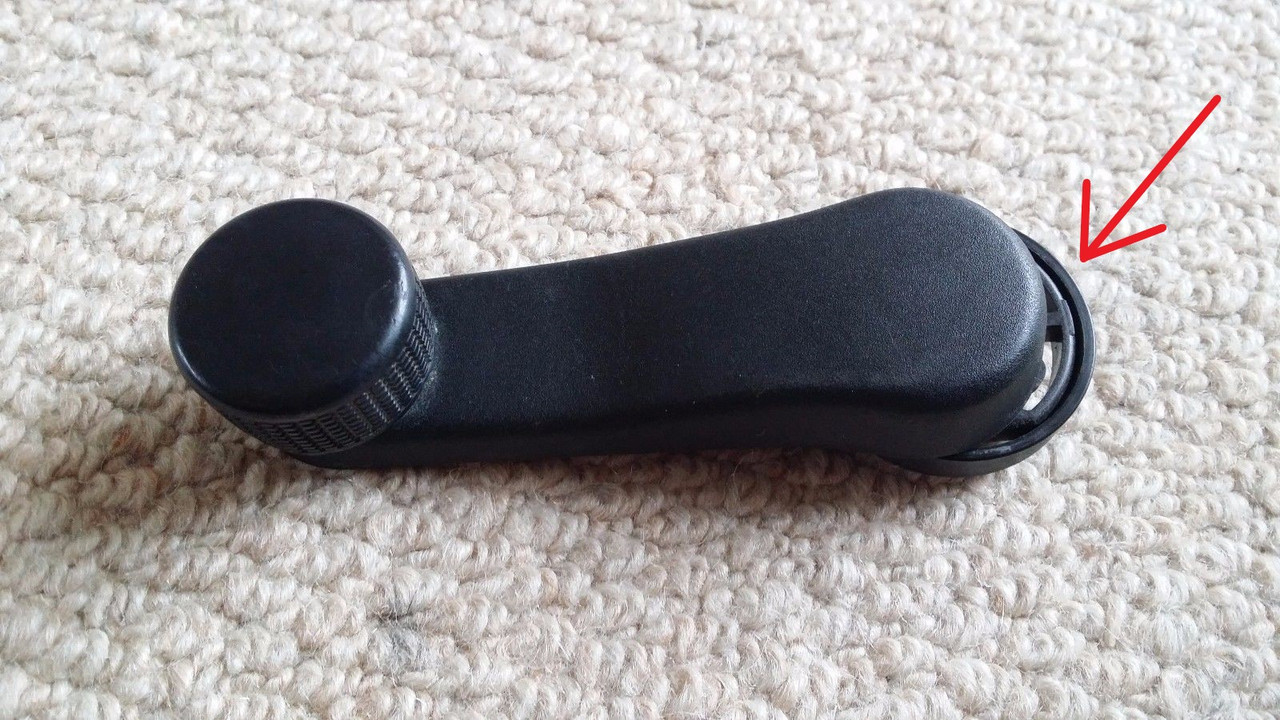

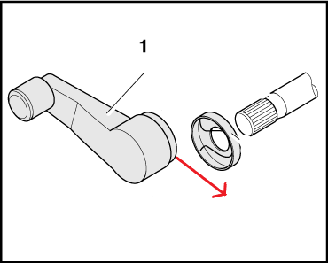

On a separate note - not sure if you know how to remove the rear window winder handles (if it has them) but it's very easy, there is a plastic latch clip that you slide as shown here...
