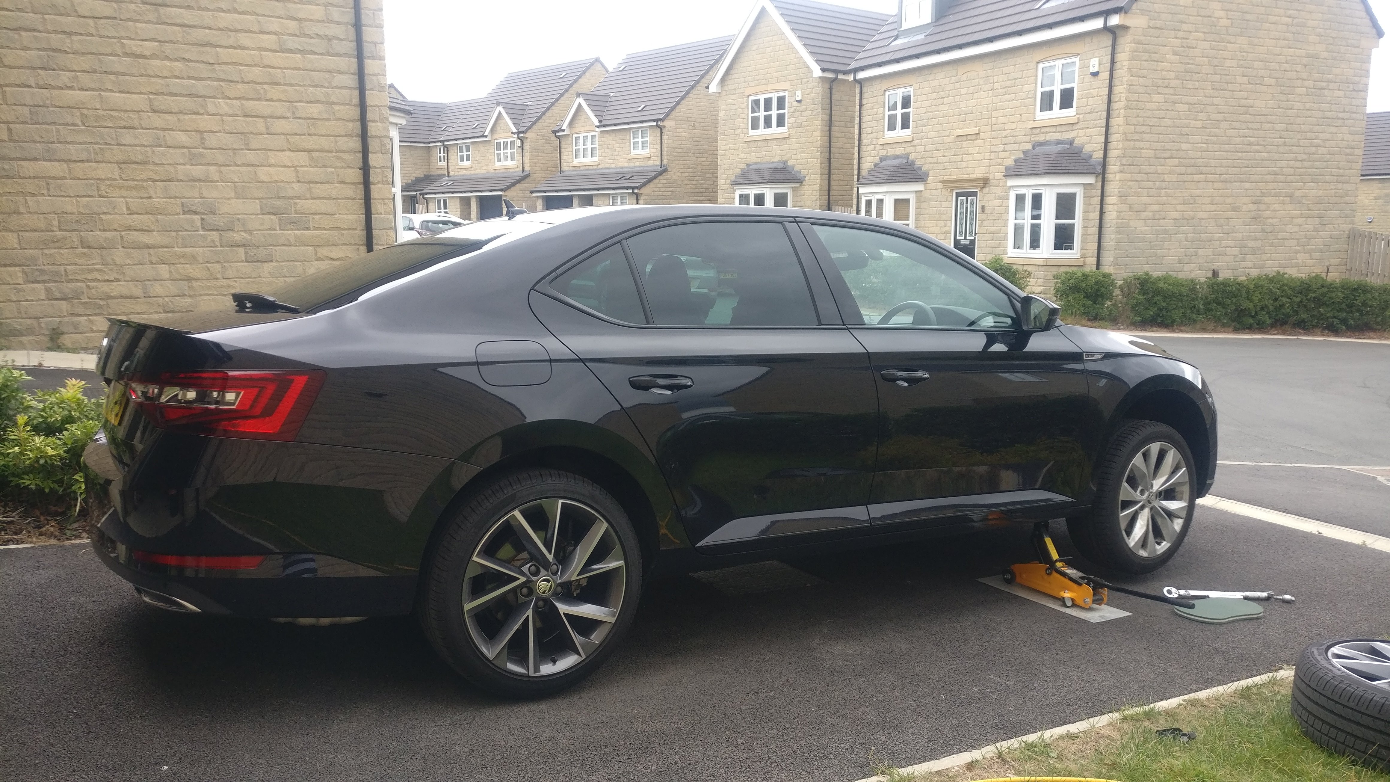

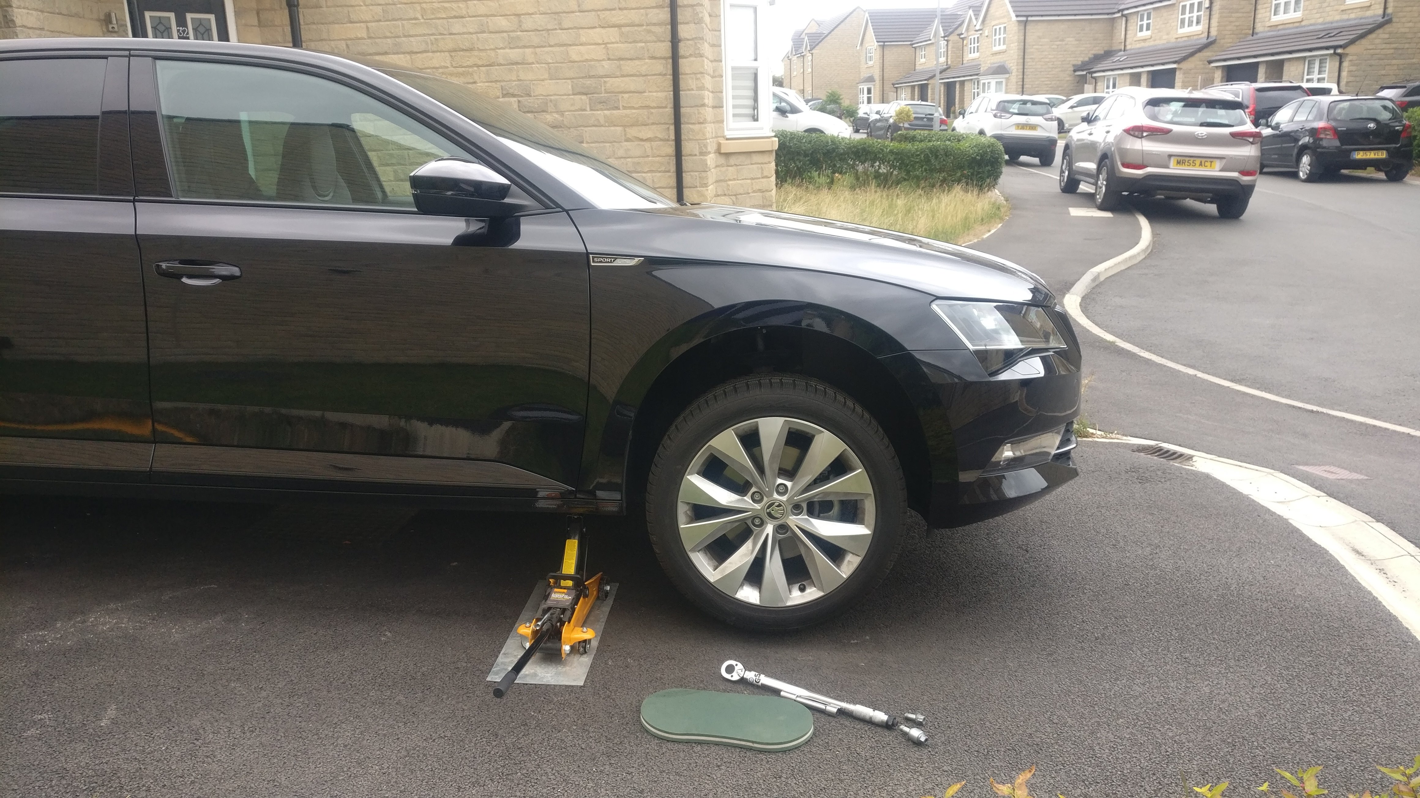

My sportline with the 18s onIMG_20180812_164853.thumb.jpg.10cb9a6d9f00e29b1f2e2ffebe4a1ef4.jpgIMG_20180812_164900.thumb.jpg.543053e344b5fbe0da0b1a0a190e254d.jpg

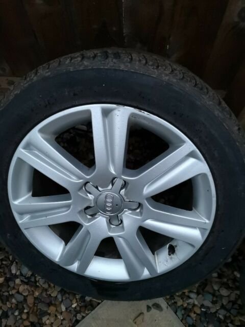

Just found some cheap Audi 17" et45 alloys, the ones in the attached piccy.
Should they fit, or do they need to be et40/41?
They will be perfect, most of the Superbs have ET44 anyway.
