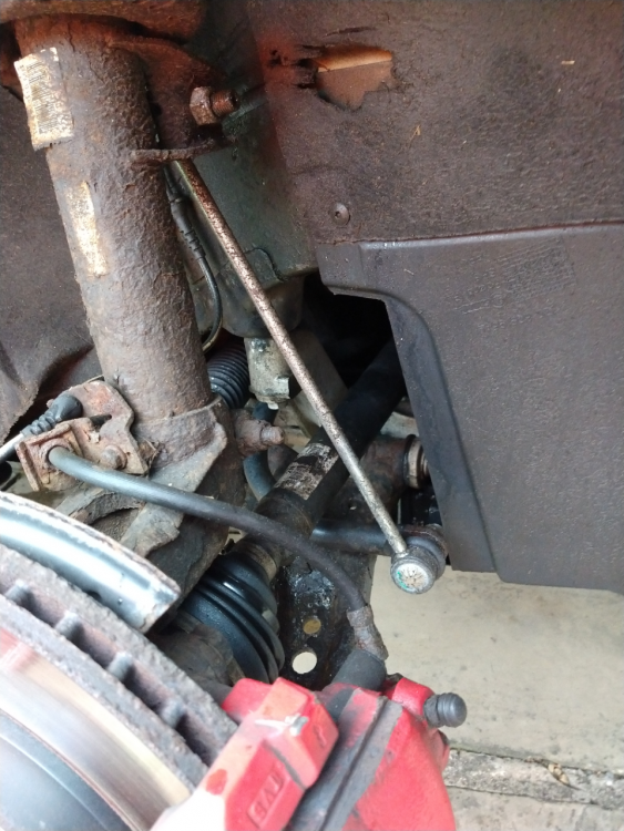

I changed 15 months ago, 3 months ago and 2 weeks ago and it's knocking again already. The most recent 2 times it has definitely been the drivers side that has gone and something that's never sat right with me is the fact the drop links and not sided left and right so which means on the drivers side the pick up on the shock connects on the rearmost side and therefore further back than on the passenger side (?).
This means the angle of the link relative to the shock must be greater on this side and the top ball joint is located with much more angle compared to the other side. You can hopefully see this in the picture below. The ball joint is almost fully pivoted within its range with both sides of the car level on axle stands.

I'd be more curious to understand how the upper drop link mount has been able to make contact with the wheel arch liner, and wear a hole in it?
Are you sure there aren't bigger suspension problems at play here?

I wouldn't expect so. Even if they do fit, the suspension is designed to use non-handed drop links so it may cause other issues. Looking online, the image you posted looks relatively normal so the angle shouldn't be causing any issues. For instance, my drop links are 160k old and going strong...
Might be worth grabbing genuine drop links and checking the rest of the suspension on the off chance something else is causing them to fail. As silver mentioned, that worn through patch on the wheel arch liner is odd.
Are the suspension and shocks stock, has anything been uprated/lowered etc?

Hi, thanks for the reply, what you can see is where the material has 'worn' away where I've repeatedly had to use an angle grinder to get the old nut off. A further frustration of the skoda design is that you can't get a nut splitter in there when the nut inevitably corrodes enough resulting in the Allen head in the end of the drop link isn't strong enough and rounds off if you try to use it.
