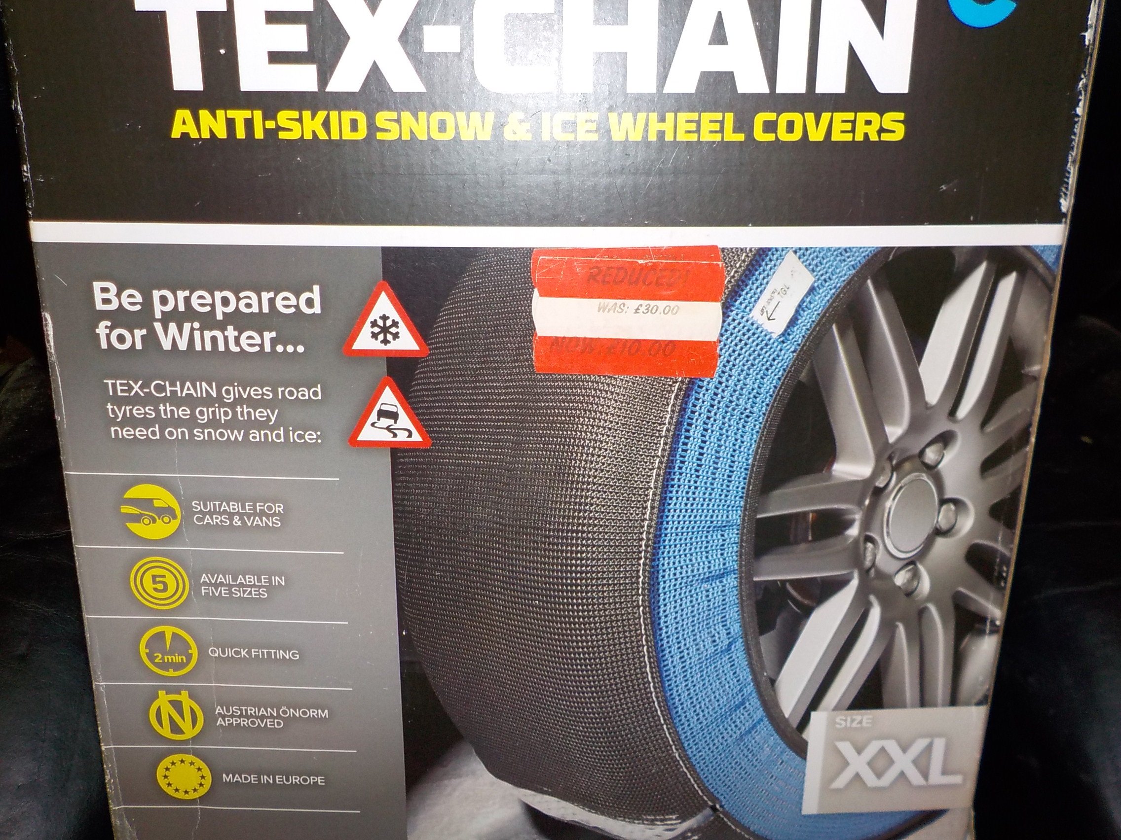

Certainly not what everyone needs or wants because many never ever fit Winter or All Weather Tyres.
But then location location location matters and to some even if 1 hour or just 100 yards a winter is all that the winter tyres are called upon to do the business they can be worth the cost.
For plenty of drivers these are maybe all they need for that time they need to get moving on ice, or off of ice.
Works for Break Down Operatives, Posties etc.
DSCN3136.JPG.88cc411f936ee4ebffd08884229a87c6.JPG.cb5bc46aa51792465da7ddcc0855071f.JPG
