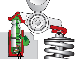

To be fair, sep, you were referring specifically to flow through the high pressure chamber (the key functional part in this context) within the tappets, where my black arrow points, which will indeed see much less flow, as it needs to hold pressure when the inlet ball/spring valve at the top of it is closed.
I haven't taken a tappet apart to see how tiddly that ball/spring bit is, but the leakdown path round the outsides of the piston will necessarily be fairly tiny, so turnover of oil will indeed be slow.

Well as I conceded at the top of the page, there are tiny oil pathways in and out of the innards of the lifter, as well as the bigger ones through it, so you're right on that one, having a biccy yourself. :)
I'm planning to take a spare lifter apart over the weekend, to see how it looks deep within.

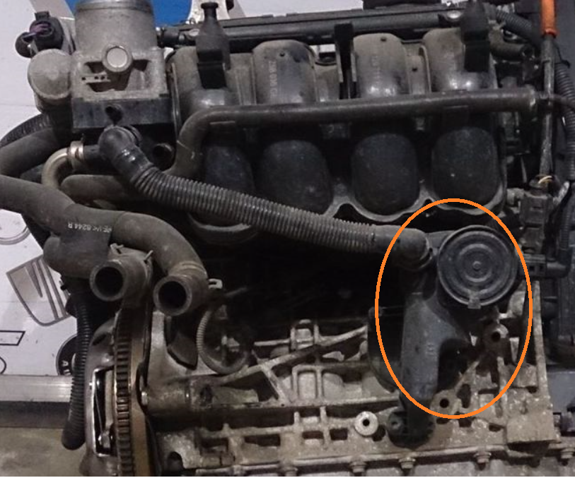

I had a look for the oil sperator & can't seem to find it. Is it the plastic block that the throttle body bolts to?

Yep, sealant instead of gasket I think, will look up a removal/replacement procedure for you.
Breather box is below inlet manifold, just above sump, not exactly sure which engine code this photo shows but it's probably about the same on yours.

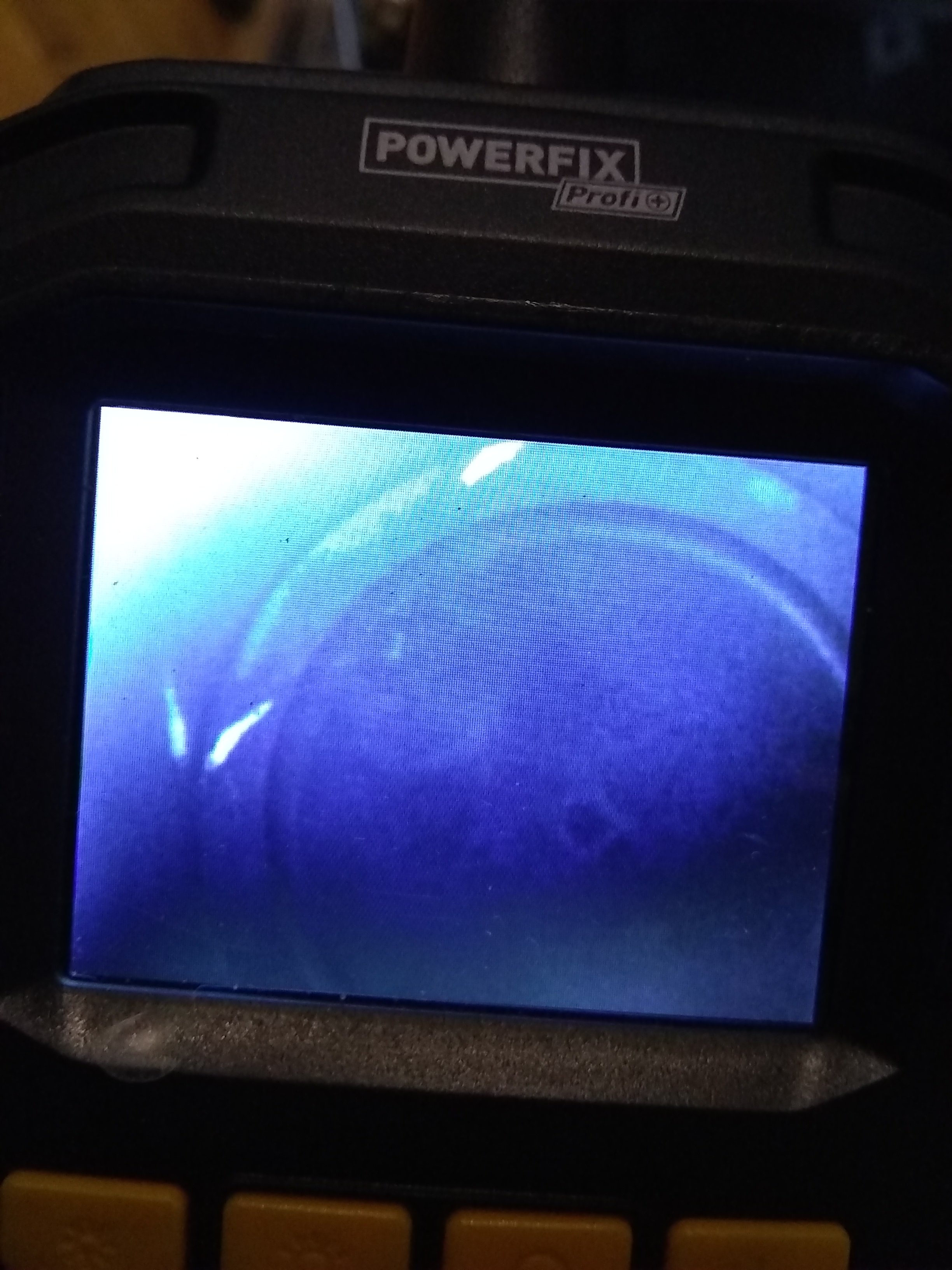

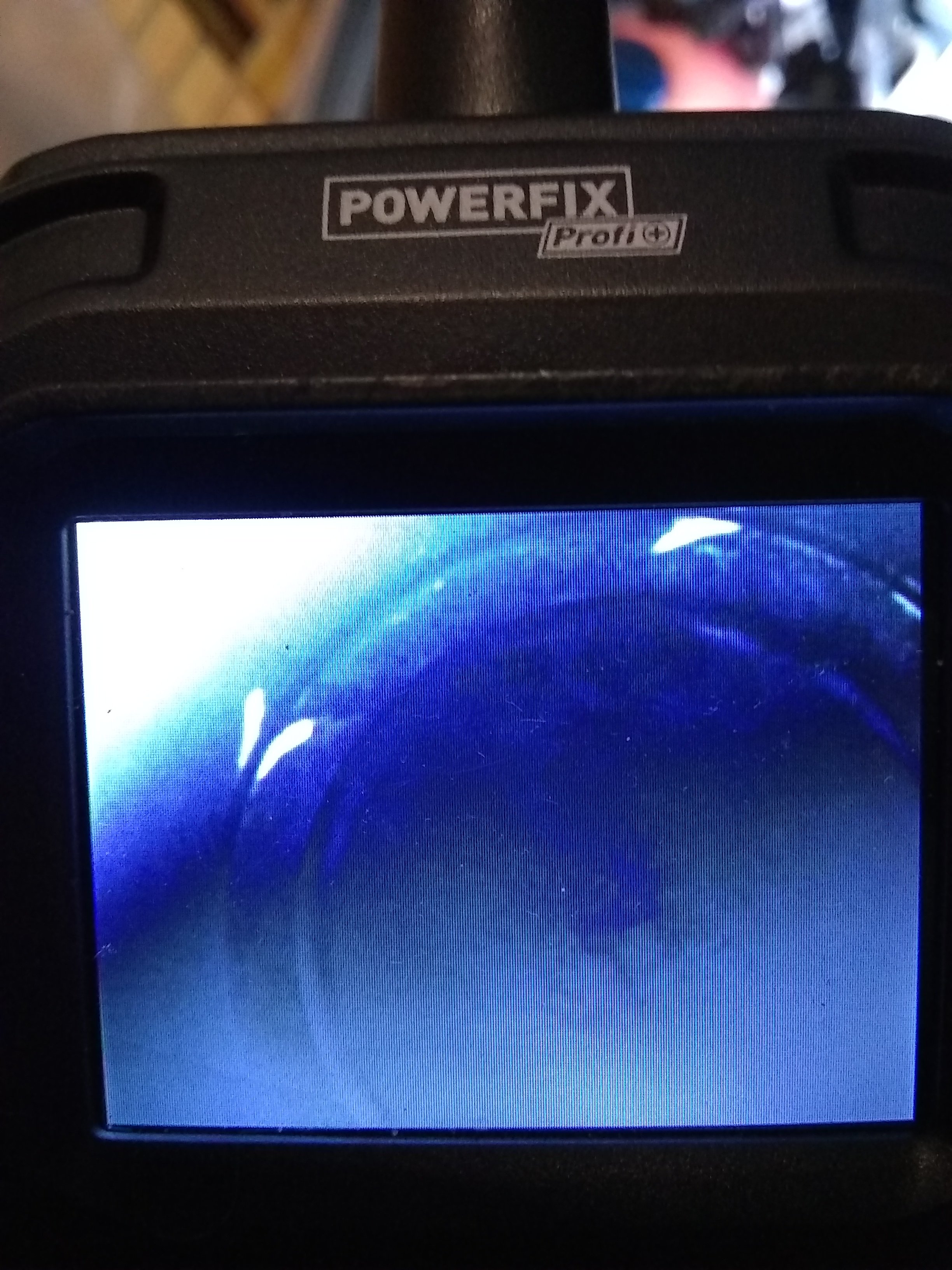

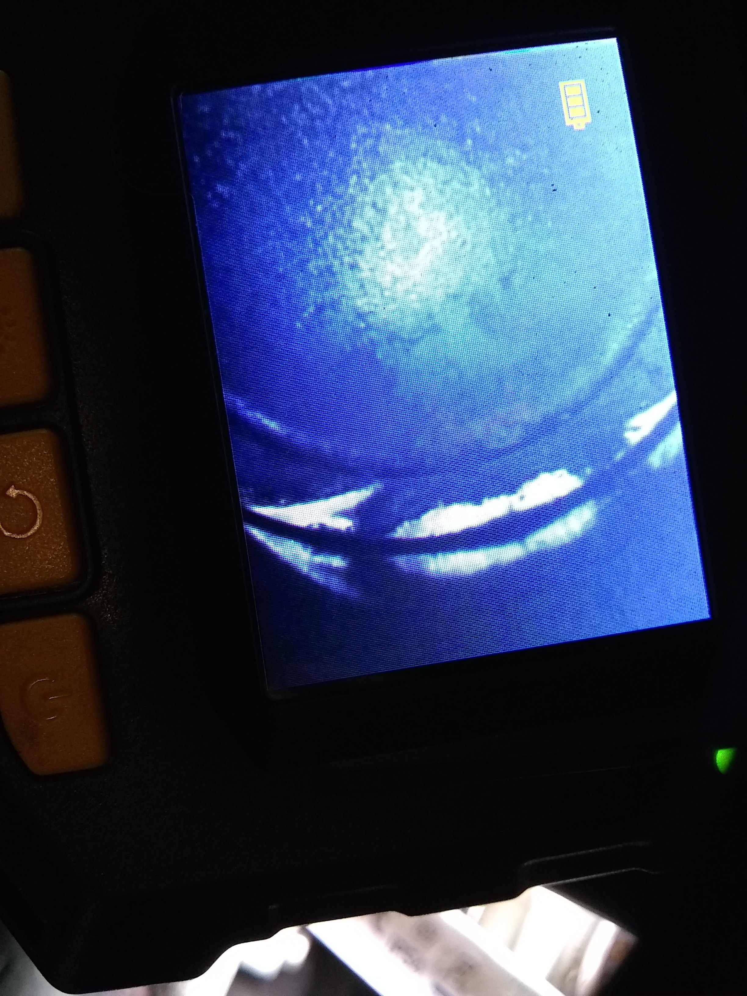

Wino or anyone else, is this normal? The alignment marks on the crank to camshaft seem to be out ever so slightly, took the spark plugs out again & used my borescope camera again & noticed this! The last pic is of cylinder 1. All other cylinders are similar to the first two pics with lesser markings. I assume that the valves have been hitting the cylinders & that isn't good! Am I going to be OK to just replace the cambelt & re-time or am I going to have to strip the head off & check? Or am I completely wasting my time & the engine is knackered
Maybe not a timing issue. Just went back & got the crank to TDC & could insert drill shafts into both the camshaft locking holes. HELP!
Those witness marks are on the piston crowns, that can happen if the engine is accidentally over-revved on a downchange and the valves graze the crowns, it doesn't mean there's any damage.
You're over-reacting, you need to get past this by driving the car, you've said it pulls strongly and drives well so it's obviously healthy.
Like I said, they can be noisy, turn the radio up.

Last photo seems to show damage between the 'valve prints' which may be more of a concern. The fact that the marks in all cylinders are all shiny suggests that this is ongoing, doesn't it?
OP has confirmed the timing is correct, the only other option for valves grazing the piston crown is over-revving on a downshift, there can't be any damage otherwise the valve heads would be slightly bent resulting in a noticeable loss of compression and performance. There is no other mechanism unless the engine has previously lost timing in a belt related event which has been subsequently repaired.
A simple compression test would confirm any valve head damage beyond all doubt. The witness marks on the piston crowns are not an issue, these are low-compression pistons from the 75 BHP variant rather than raised crown with valve cutouts found on the 100 BHP version.

Agreed, as previously mentioned my car with almost the same engine has made this noise from a young age and low mileage and I've heard others like it.
Also the indentations in the pistons are part of the original design and you are seeing difference in reflections, eg:-
https://www.tornau-motoren.de/en/engine-parts-spare-parts/engine-engine-components-cooling/pistons/piston-set-76-51-vw-golf-6-1-4-16v-036107065dp-cgg-bud-bxw.html
I'd say just drive it!
