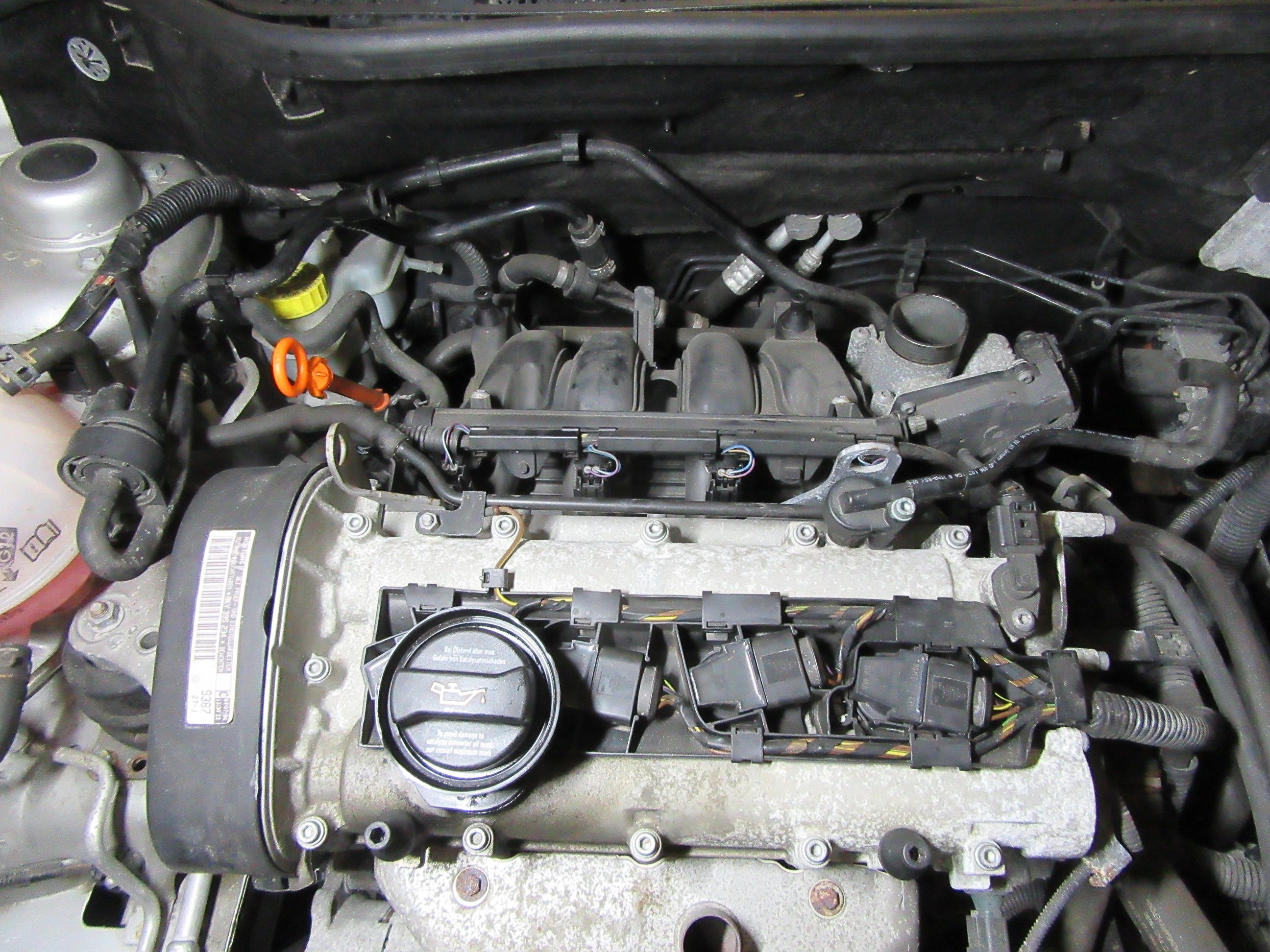

Hokey Dokey. Here goes. It is a BKY engine. Had a look where the mysterious pipe goes & it is T'd into the pipe that goes to the master cylinder & then heads off into the back of the engine gearbox side. I found out why it was loose. There is a rubber adaptoe that had been pushed too far up the spigot on the airfilter. Once removed & refitted to the pipe it was a snug fit. No effect on rattle but might improve brake performance!!!
Pics attached of pipe for reference.

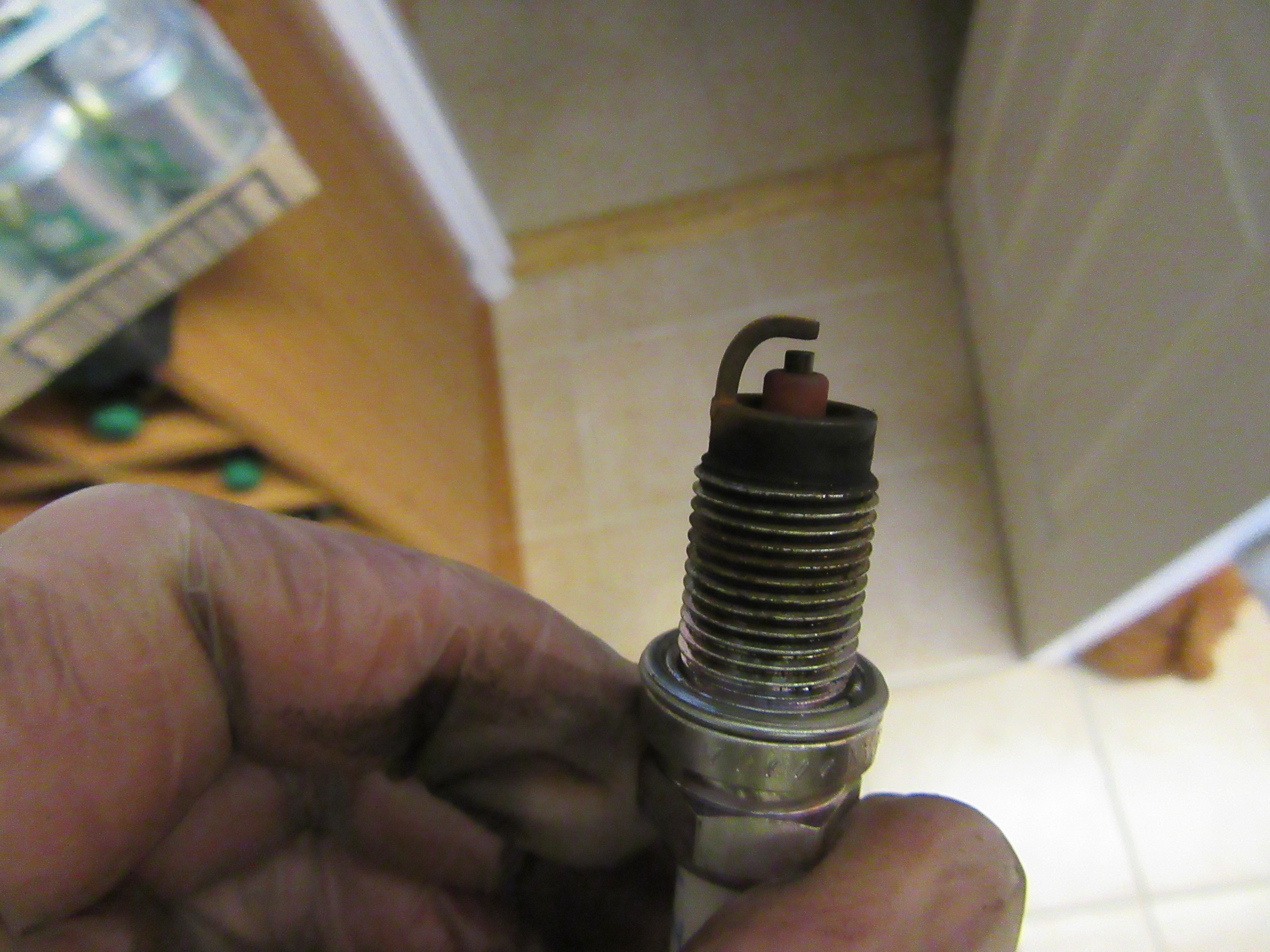

As for the rattle I got a work colleague to drive the car around the block. He is a car nut, built his own kit cars & is currently rebuilding a TVR wedge. He thinks it is definitely top end related & may well be tappet related or small end bearing related. He suggested I get my stephoscope out and have a listen. Another work colleague who is also a classic car nut did suggest pinking. As stated the car has had virtually no use for a year & even before then on very short journeys. I also wondered whether the 1/4 of a tank of fuel that was in it may have gone off. This has all gone now as I ran it down to 30 miles of fuel left & filled up to 2/3 full. The plugs look OK (pic attached).

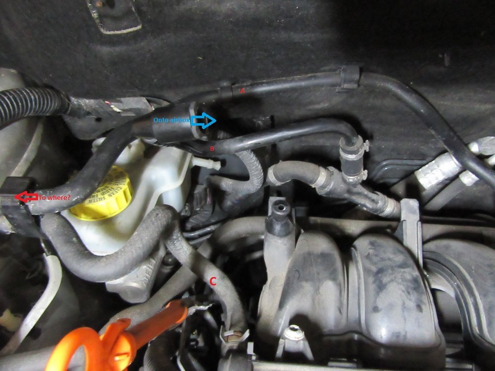

Do you mind if I save and edit your top photo to clarify some things?
That's fine, It's not a good pic as it looks like there is a join where there isn't. The pipe at the very back is not connected to the pipe in front of it
  • Sponsor
So pipe A, strapped to the firewall isn't involved, but pipe B is T'ed into the Airbox pipe just next to the airbox fitting, and at its other end into the brake servo vac hose?
Where does the airbox pipe go to in the direction of my red arrow? I think pipe C isn't just that looping back round, that's a fuel pipe, or coolant pipe?

Ah, wait, pipe A and "to where" pipe are one and the same, not connected to "airbox pipe"?
Edited by Wino

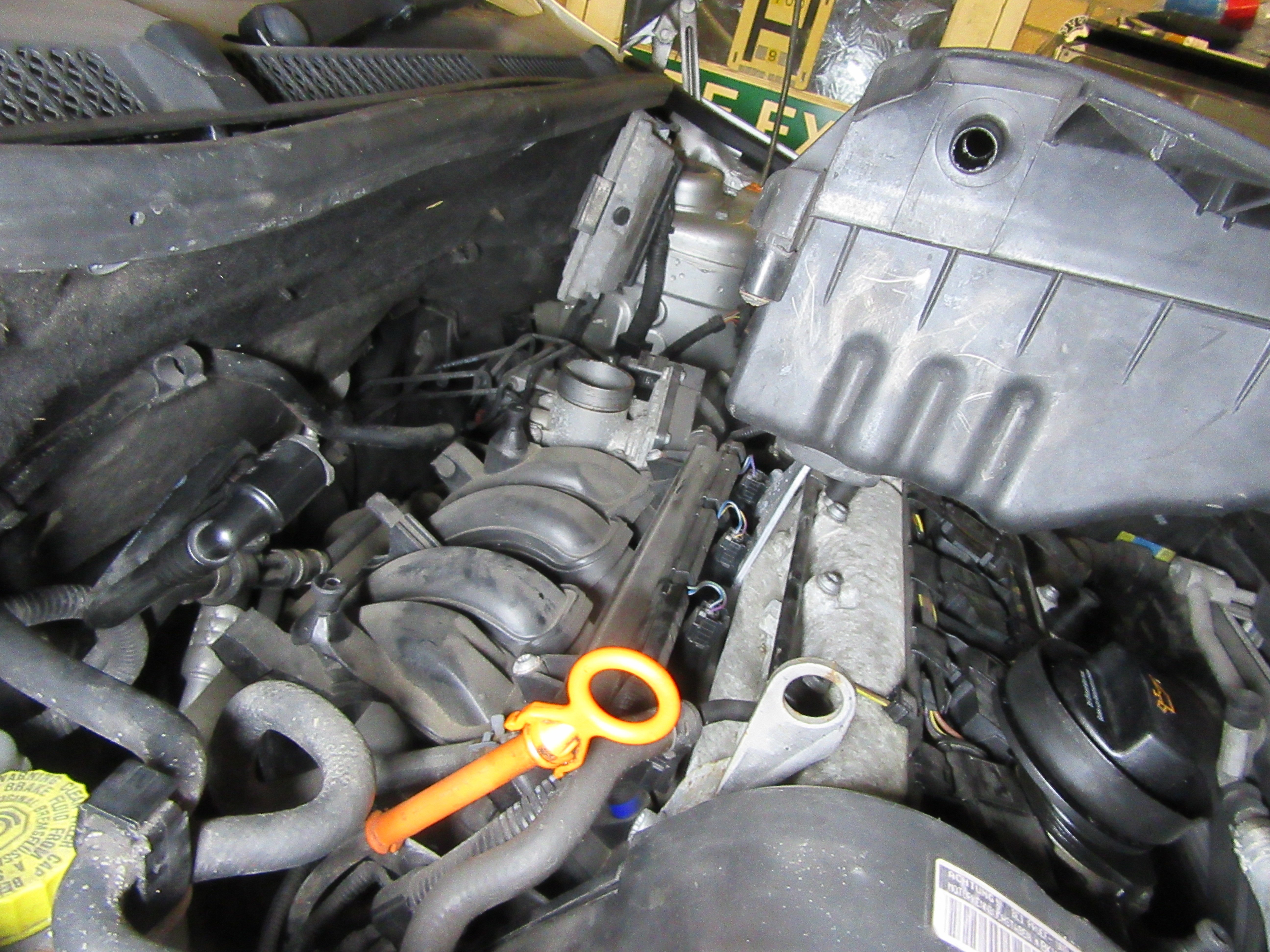

Pipe "A" & "To where" are one pipe & are not connected to the air filter. Pipe B &"onto airbox" are the same pipe. These two pics may help. The first shows the airbox hole two (airbox lifted off & moved to the side)

OK, yeah, so the airbox connection is just a 90° elbow, heading for the brake servo hose.  Pipe A on the firewall is the output of the EVAP purge valve, next to the expansion tank.
It's not super-obvious to me why there's a fresh air feed into the brake servo vac hose, presumably the lump just to the left of where it tee's in at about 45° is a non-return valve? Otherwise it would just seem to be spoiling the servo vacuum. Is that a big split in that hose just to the left of the 'B' I've added? Or a trick of the light? Can't see it mattering much as it's just going to bring in unfiltered, instead of filtered air.
Edited by Wino
I think the split is a trick of the light. I was using a long stick LED lead light which I think is reflecting! I will double check it though!
