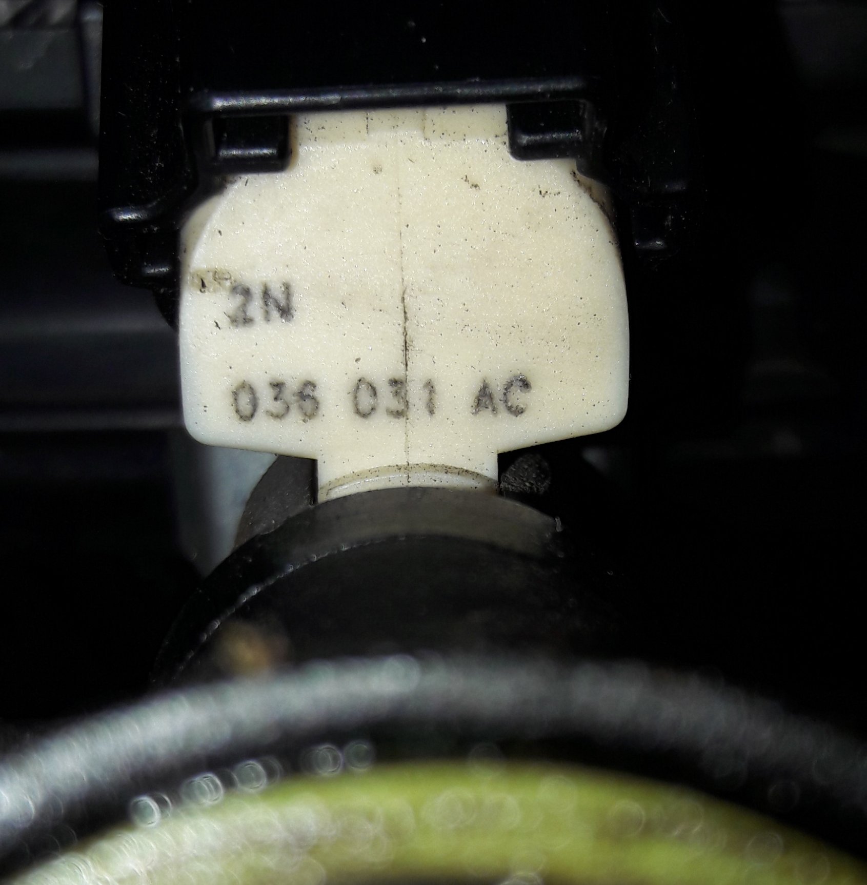

I got hold of a fuel rail complete with injectors for £20 so I though I would give that a go in case a dodgy injetcor was allowing through too much fuel (the fact taht cylinder 1 had liquid in it when I first looked) Unfortuantely the injectors on the replacement had white ends & the original had blue. I fitted it anyway & the car runs, it does seem quieter! I have since done a bit of googling & appear to have bought a BBY rail instead of a BKY rail. The injectors on the BKY are 036906031AB & the BBY036906031M both are 1.4 16V.

Hmm. A while back I bought a spare inlet mani including injectors and MAP sensor (for a song off ebay) for my BBY, and ended up getting something that had non-matching injectors to what I have on the car.  Will just pop out to the shed and see what it is I got, injector-wise.
  • Sponsor
Different number from either: seems to be 036906031AC I've got, and neither of the part numbers you quote supersedes to that.
What the differences are I couldn't say.
If your car is running quieter now and shows no faults I'd be tempted to leave them for now and see what happens.  Doubt there'll be any risk.
Edited by Wino
The main part number is the same, only the revision is different, the revision probably denotes a different supplier rather than a different spec.
Flow rates are really all that matters with injectors.
