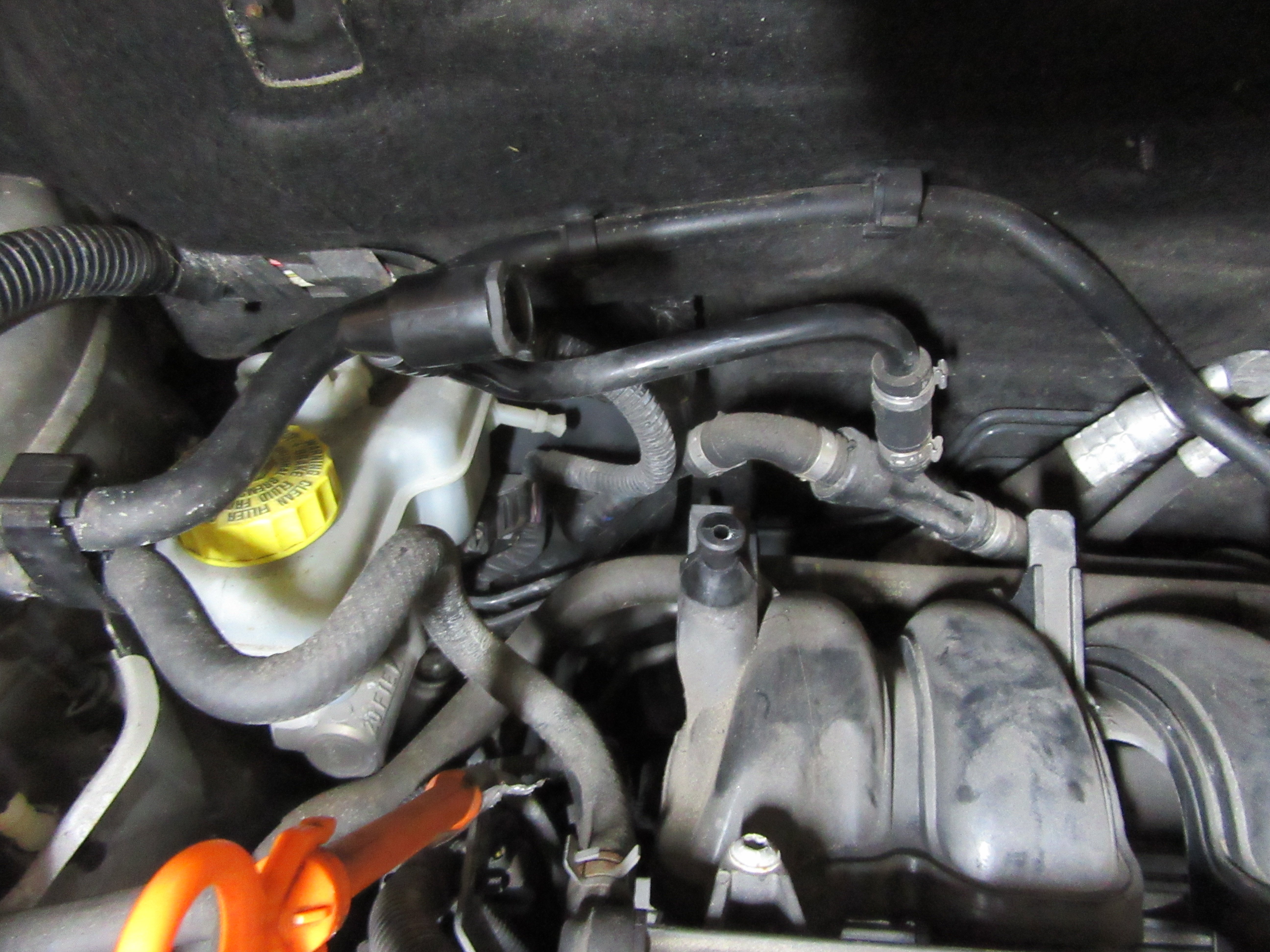

Just an off-topic observation but it's interesting to see how the brake/clutch fluid reservoir still has the barb for the clutch fluid pipe but it's blanked off because the car is an auto.

This stuff about the extra air hose has me realising how very little I know about automatic transmissions.
That extra connection into the brake servo vac line does appear to be only there on the automatic cars, but I have no idea why it needs to be there. Presumably the right hand (as photographed) end of the servo vac line goes to the inlet manifold, just below the throttle body, same as on manual cars? Or is there something else? This SSP suggests that some petrol automatics get an electric vacuum pump for reasons discussed within; can't spot this in Fabia parts diagrams though?
I've not leant over the engine far enough to see exactly where the pipe goes. My wife's last car was a Petrol Citroen C3 sensodrive (manual gearbox with a set of actuators fitted around it). It was lots of trouble & I rebuilt the gearbox as the input shaft bearing went & put all filled all the oilways with the caging of the bearing. I drive a C3 manual diesel & it always amazed me of the small detail changes tht were made for it being an auto. In fact it was easier to work on the auto car than my manual one!
