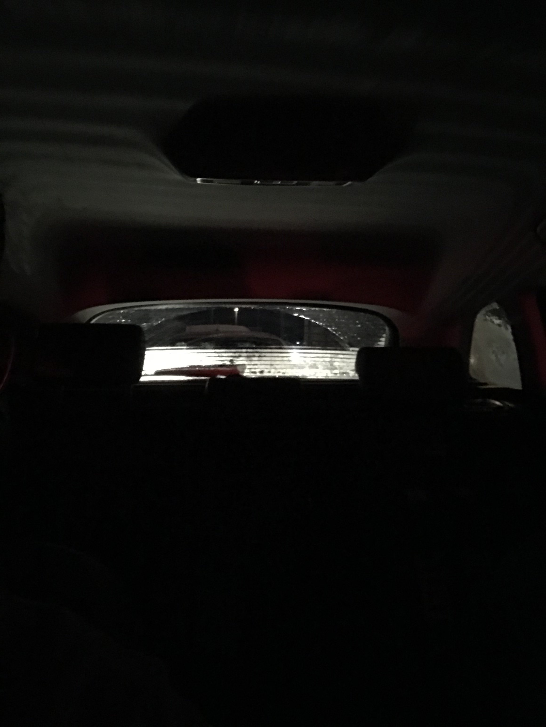

Just bought a 280 L&K. I love the car but one thing I find strange is that the Heated Rear Windscreen takes ages to demystify. I think it may be taking 15-20 mins to do so. Is this typical of the 280 L&K ? The front heated windscreen is wonderful and the back seems very slow.

On this... what about 50% defrost capability?? I’ve heard of a dropped element but not dropped half a screen? Upper section was rapid to clear. Thoughts please...
That will be a scratch running through the upper elements.
