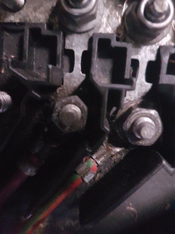

Firstly, check the fuse strips on top of the battery. Look very carefully as they can develop very fine cracks.
Like this...

Yep, it'll be fuse 6, with a thick red/green wire, on your car.

I'm really surprised it's not the normal fuse problem; can you post a photo of it?
Yes I'm upload pic of fuse.did another scan showing cent electrics j285 control mot in cluster?
  • Sponsor
Must admit, it looks OK.  Try giving it a gentle poke in the middle of the thinnest area. Or remove it and see if it breaks as you do so.
Have had it out it's strong no cracks.
