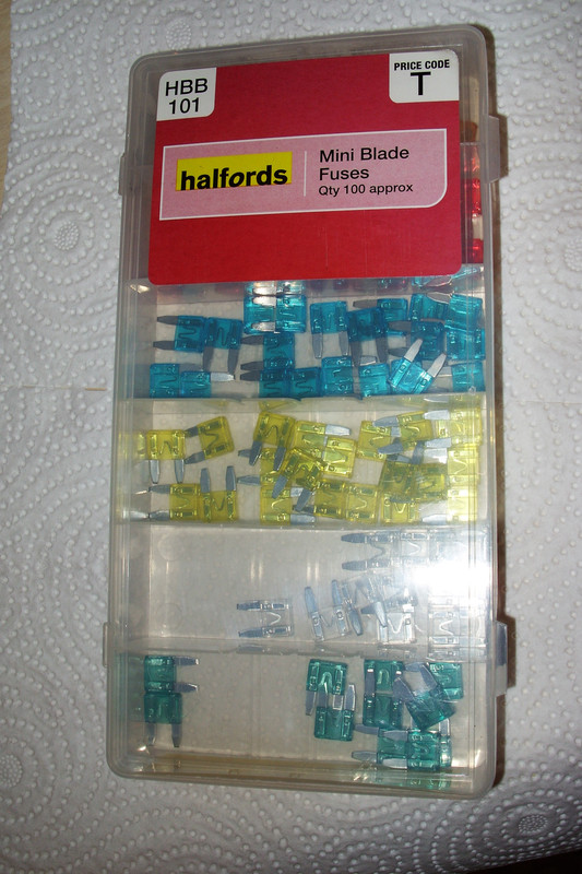

Mini blade.
Halfords do a selection pack of them...

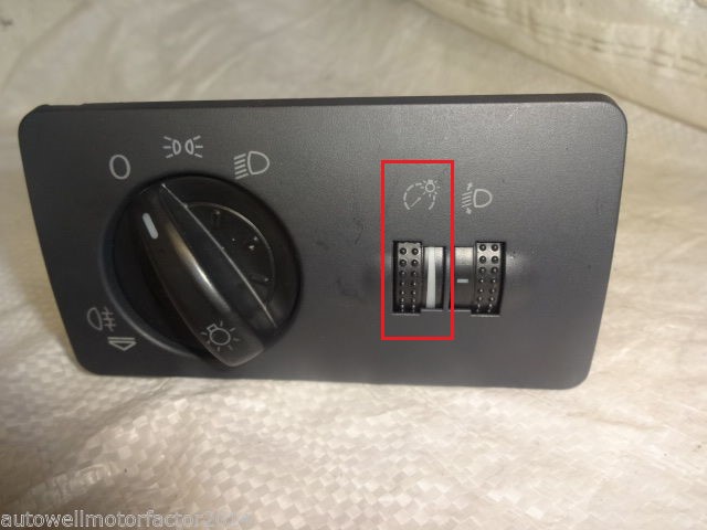

Cluster backlight isn't going to be a fuse. It might be the dimmer switch.
wheres that? to be found?
I sound like a girl now :)
It's part of the headlight switch....

s-l1600.jpgnope.... try again. Changed all fuses and fiddled with dimmer switch. Still dark

replaced all fuses Halfords £8 ... ouch. still no joy

I think TMB was not just suggesting that you wiggle the dash light brightness wheel a couple of times to see if it made a difference. You found it didn't and it should! This suggests a more careful examination of the part is in order. Perhaps work out what pins it is connected to and hook up a meter measuring resistance to see if it changes as it should. An examination of the mechanics in the switch. Even a purchase from the local scrappie or ebay (£15) to do a swap test.
Exactly.
I was suggesting that it may be faulty, of course.
