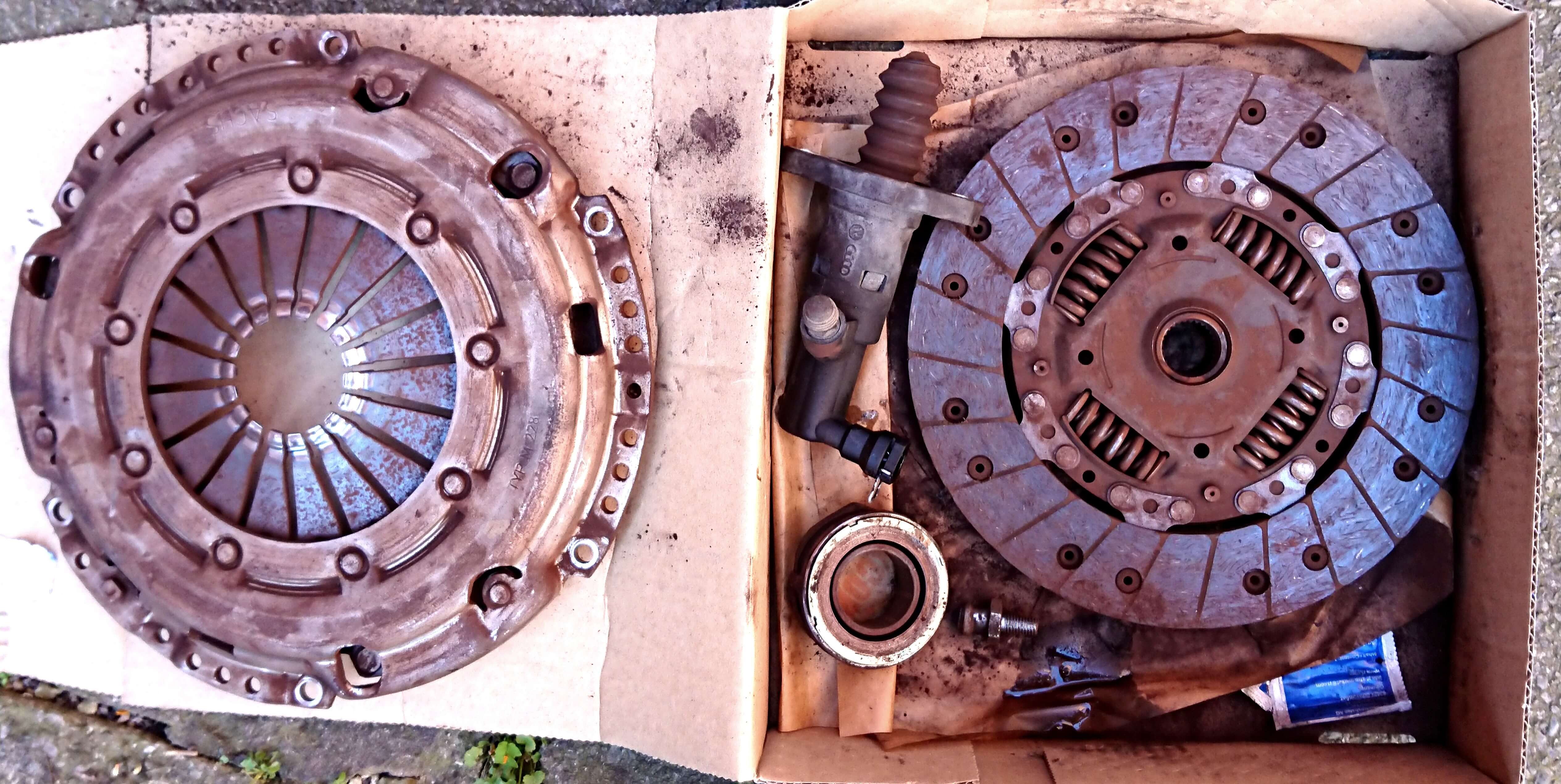

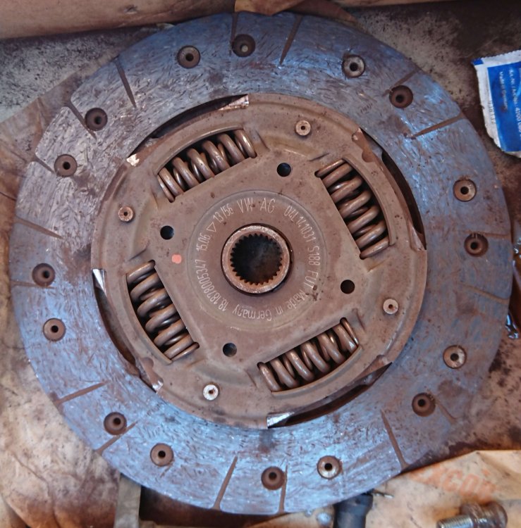

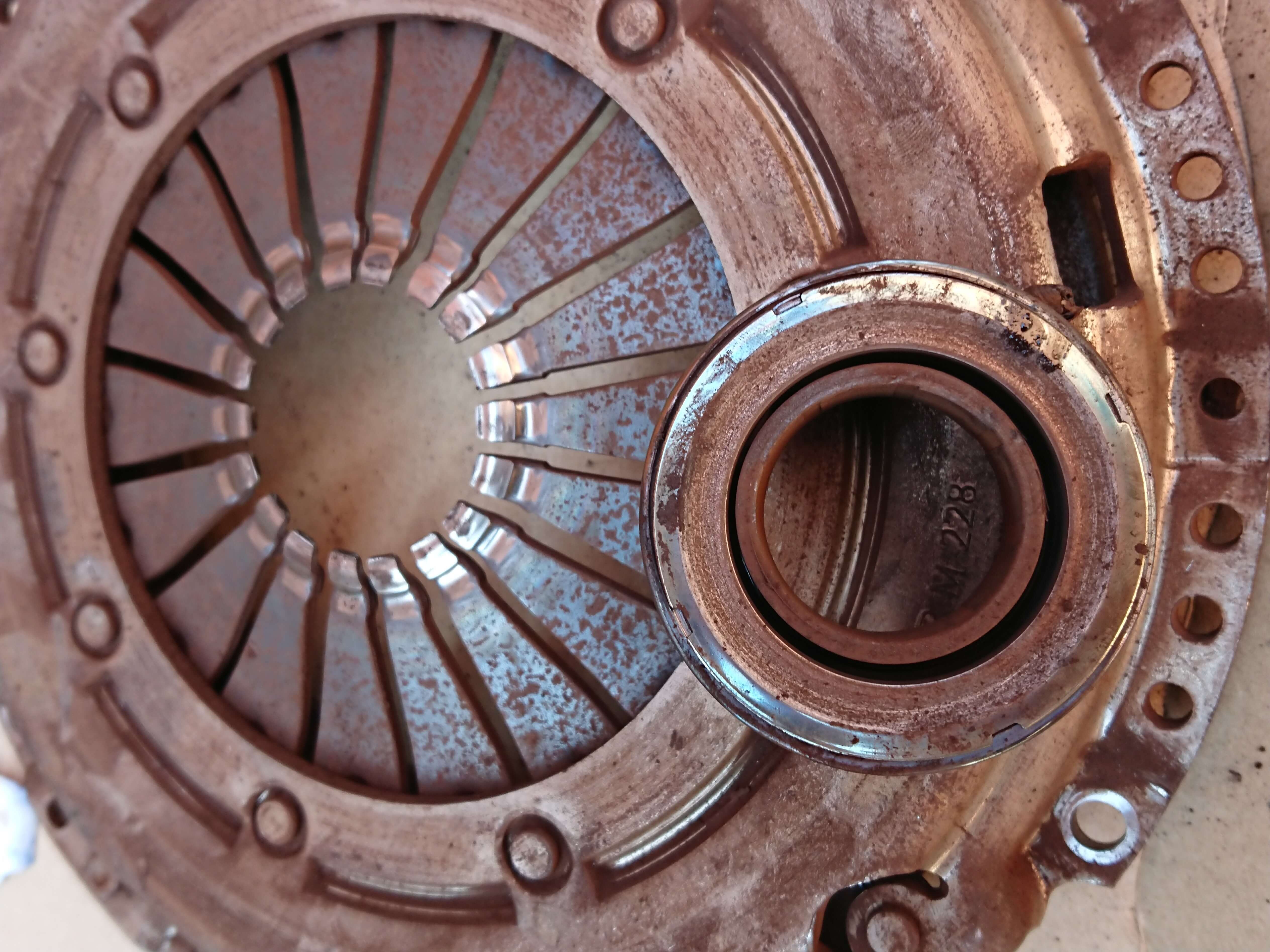

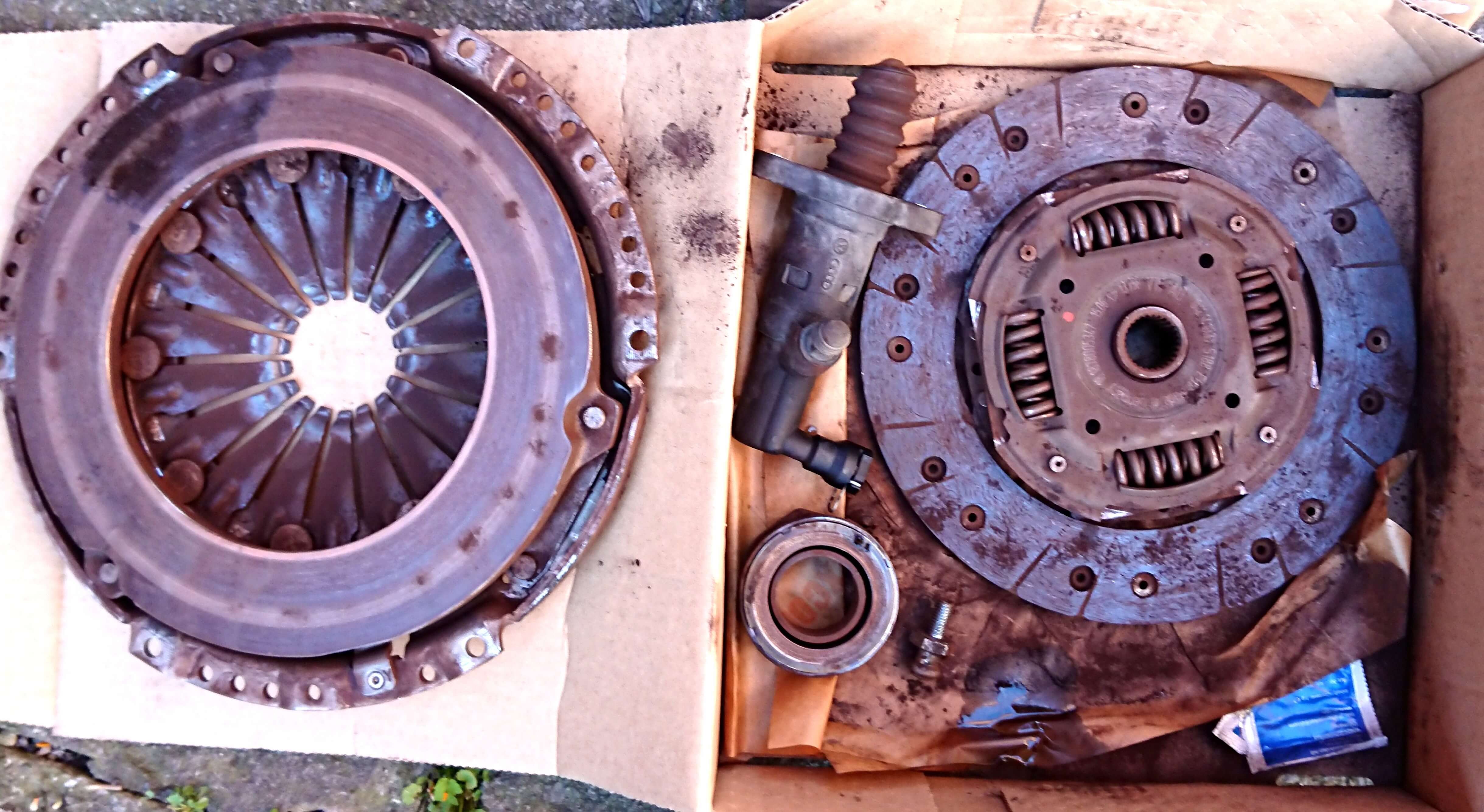

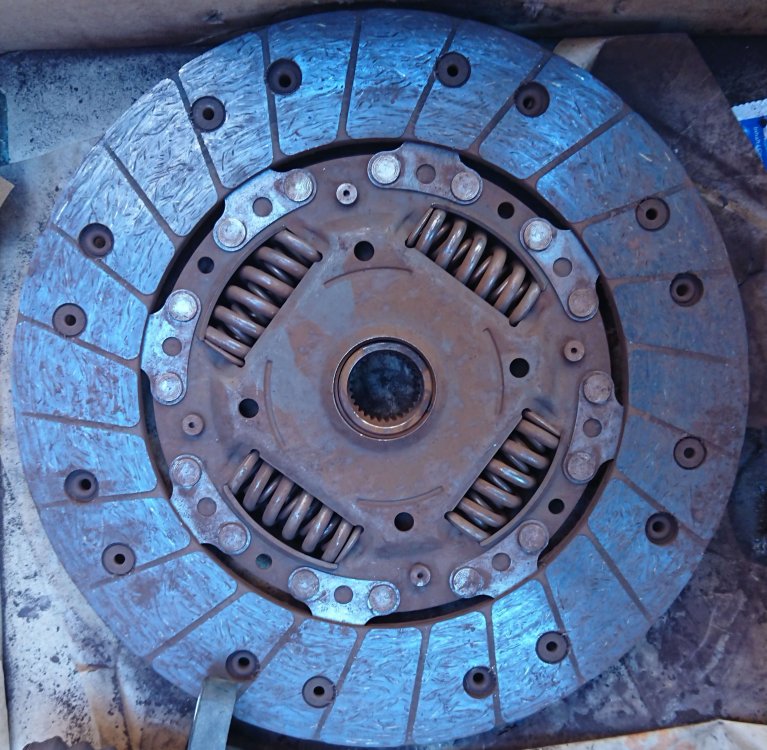

Ok, so, job done. Here's the promised follow-up. I've attached photos of the removed parts. My car is the 5-speed manual estate 1.6 diesel 5E5 model, CLHA engine code, MWW gearbox code. The flywheel is indeed solid as per the specs document attached to my previous post. (Amusingly, my mechanic's parts supplier, having told him definitively the flywheel is solid, initially sent him a dual mass specification LUK clutch! They had to swap it for the correct Sachs solid flywheel one. See image 01 for part number.)
The photos show all the removed parts, from both sides in the case of the clutch plates. I had the slave cylinder replaced while the job was being done, although the original had not failed. Seemed wise for minor extra expense.
You'll see from the detail of the friction plate that it was not quite totally worn out despite having done 228,000 miles, 5 years working as a taxi in a semi-urban environment with steep hills, loads of speed humps, narrow streets, sharp turns, etc. etc. - so you can take it my clutch works hard! Although I've never been a clutch-rider or otherwise treated clutches roughly, I've never previously had one last half this long! I haven’t driven this car differently from previous vehicles.
I think it's interesting/notable that the failure, when it came, wasn't classic clutch burn-out with no friction/traction, but a loss of adequate plate separation when de-clutching causing difficulty changing gear.

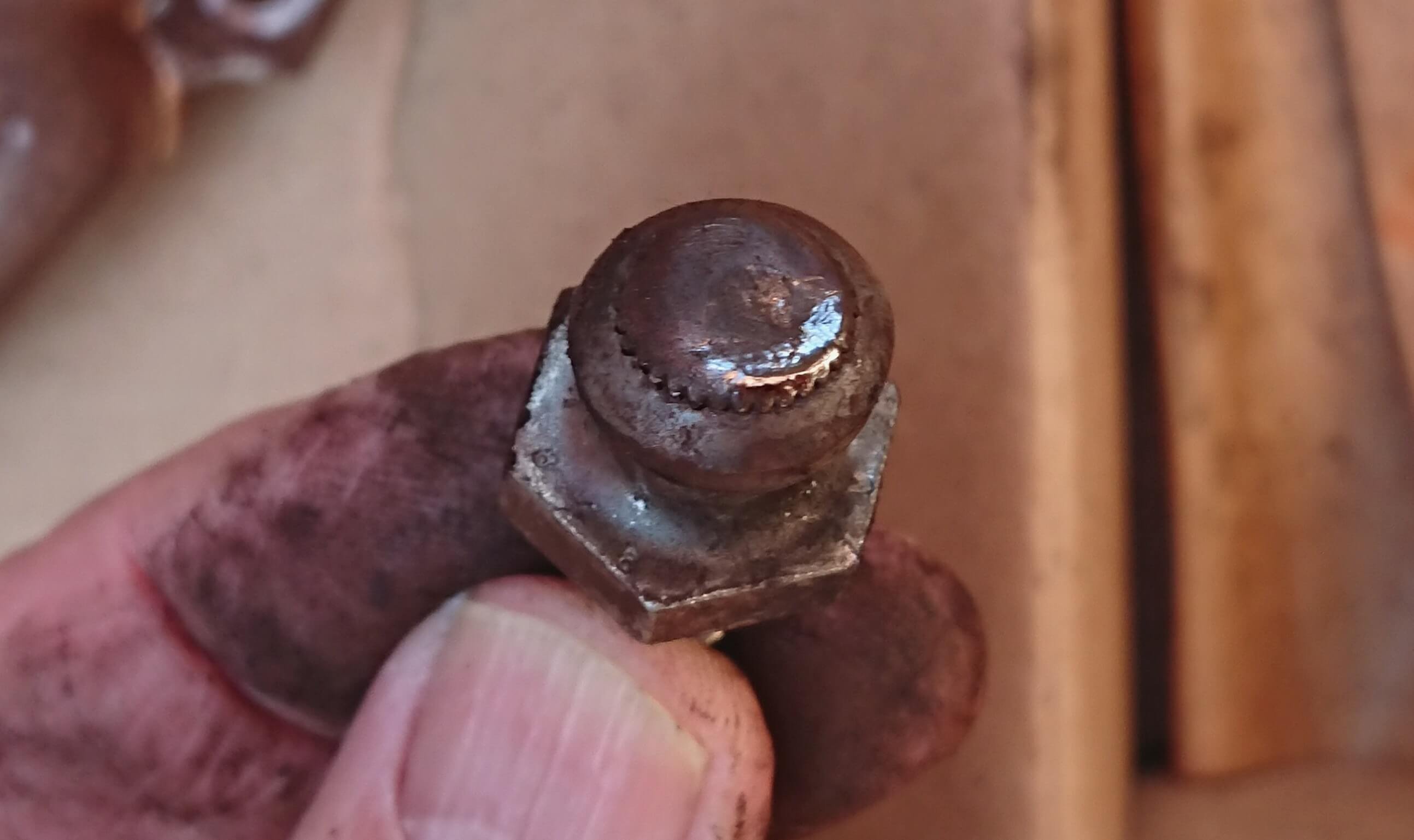

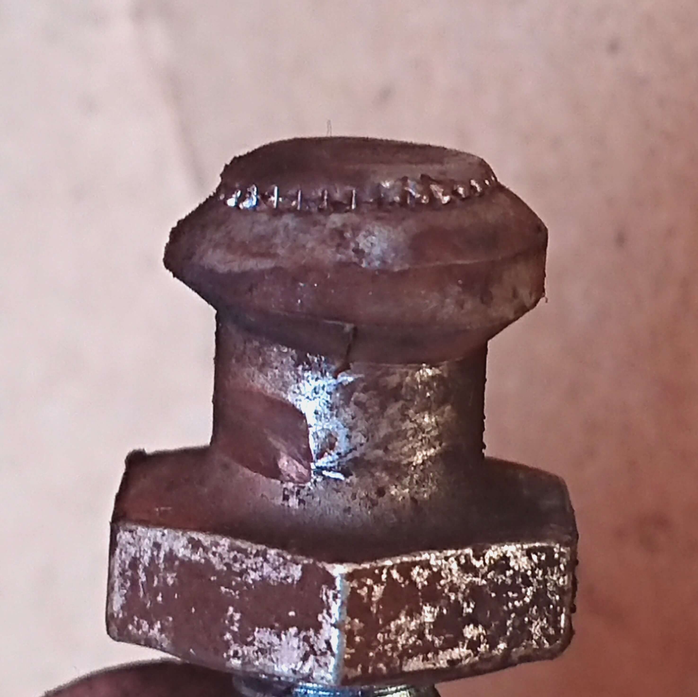

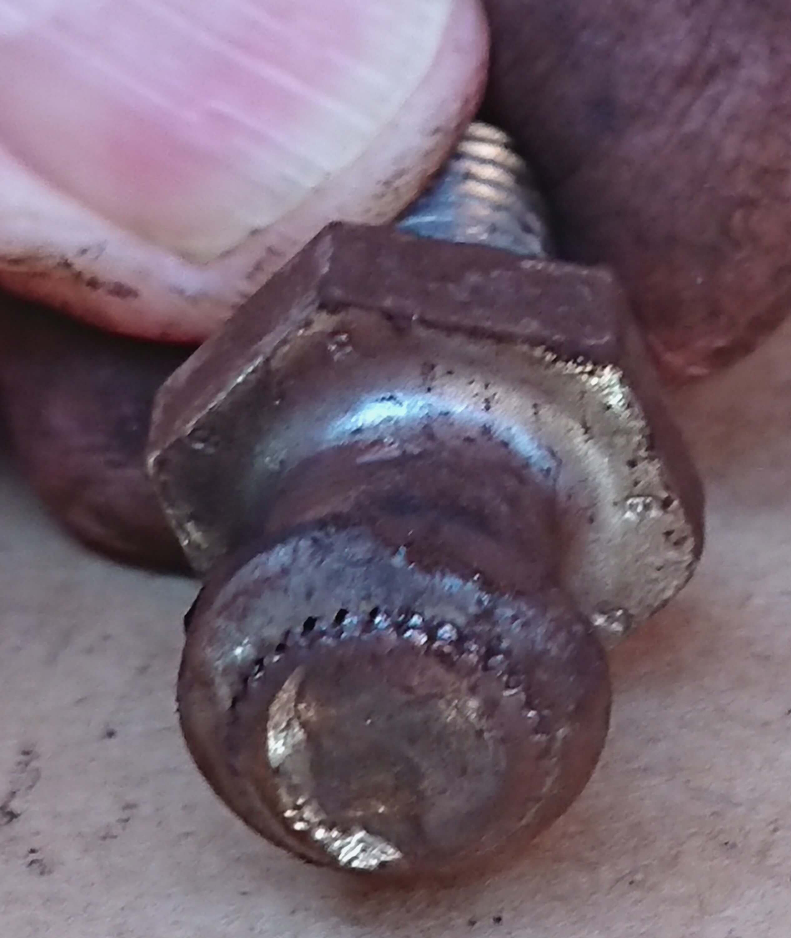

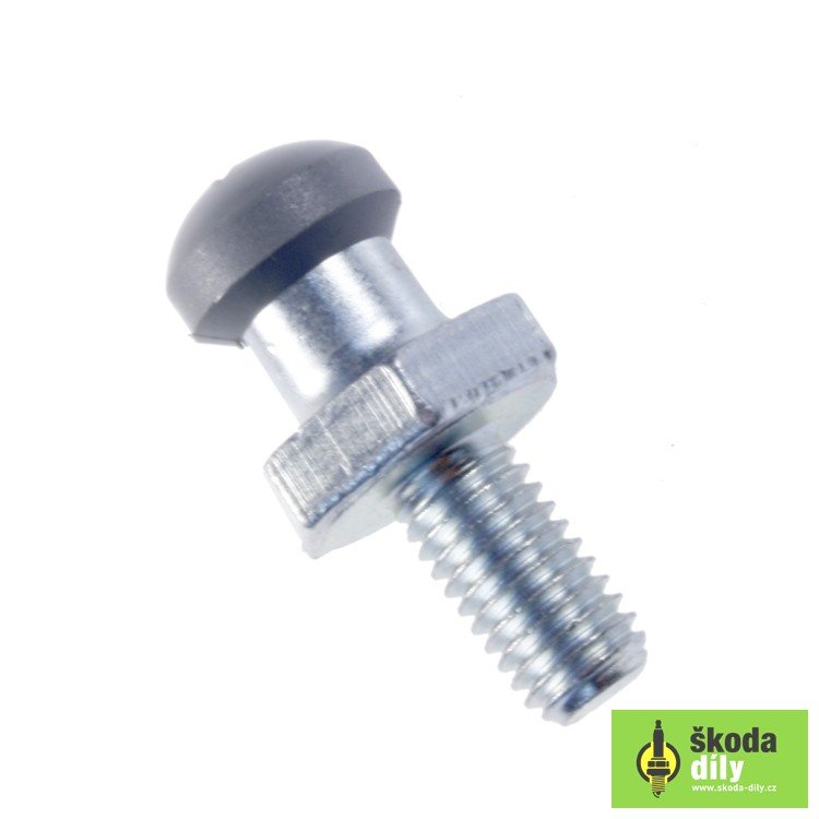

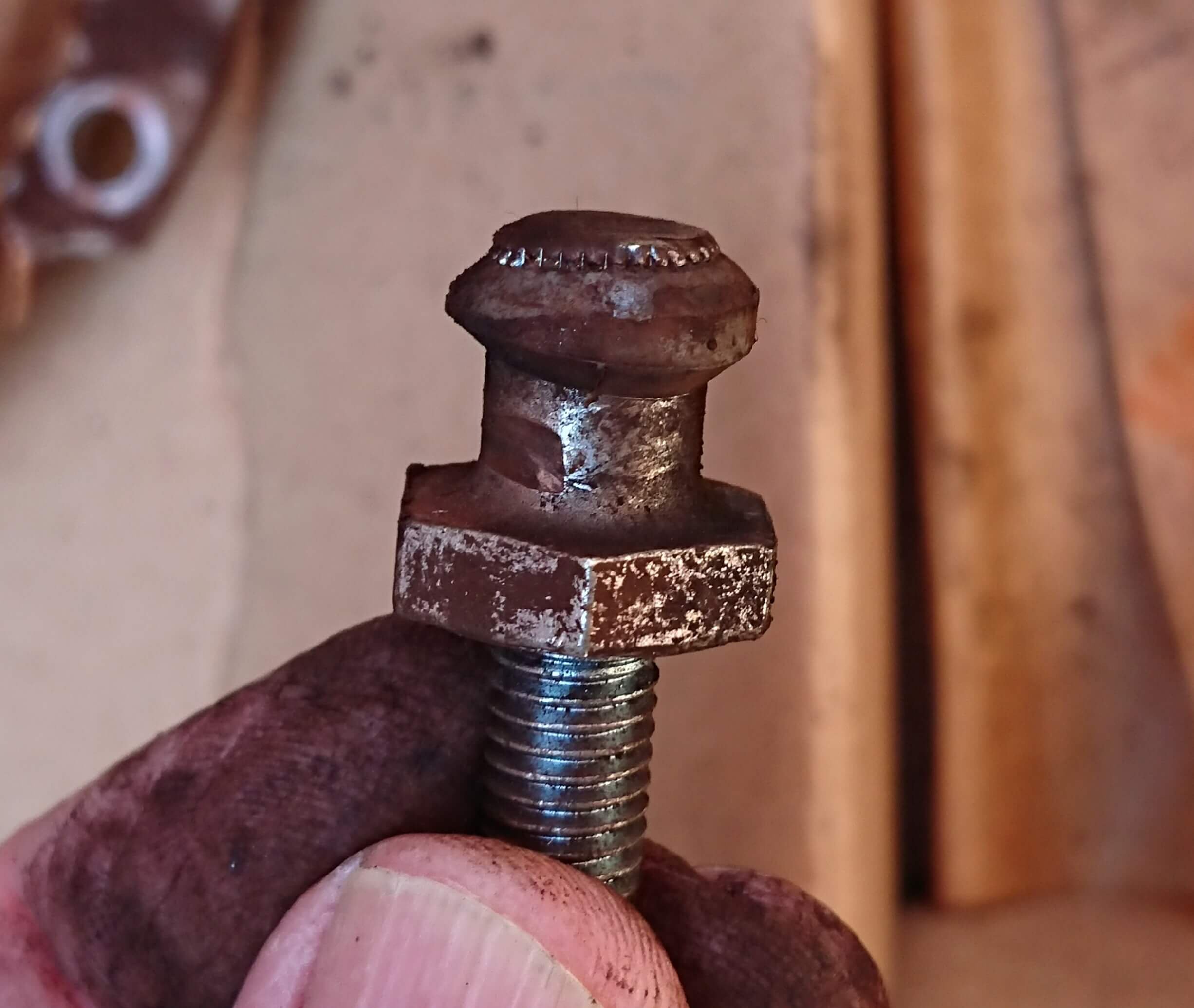

The worn-out fork release ball pin (see images, including of a new one) seems to be the most significant part failure, but was presumably the result of how thin the friction plate had become. Better, I suppose, not to lose traction completely and to be able to get home/to a garage driving clutchless than to be stranded immobile!
The good news - total cost via a friendly local small garage £520. Gear changes now deliciously light and smooth. :-)
