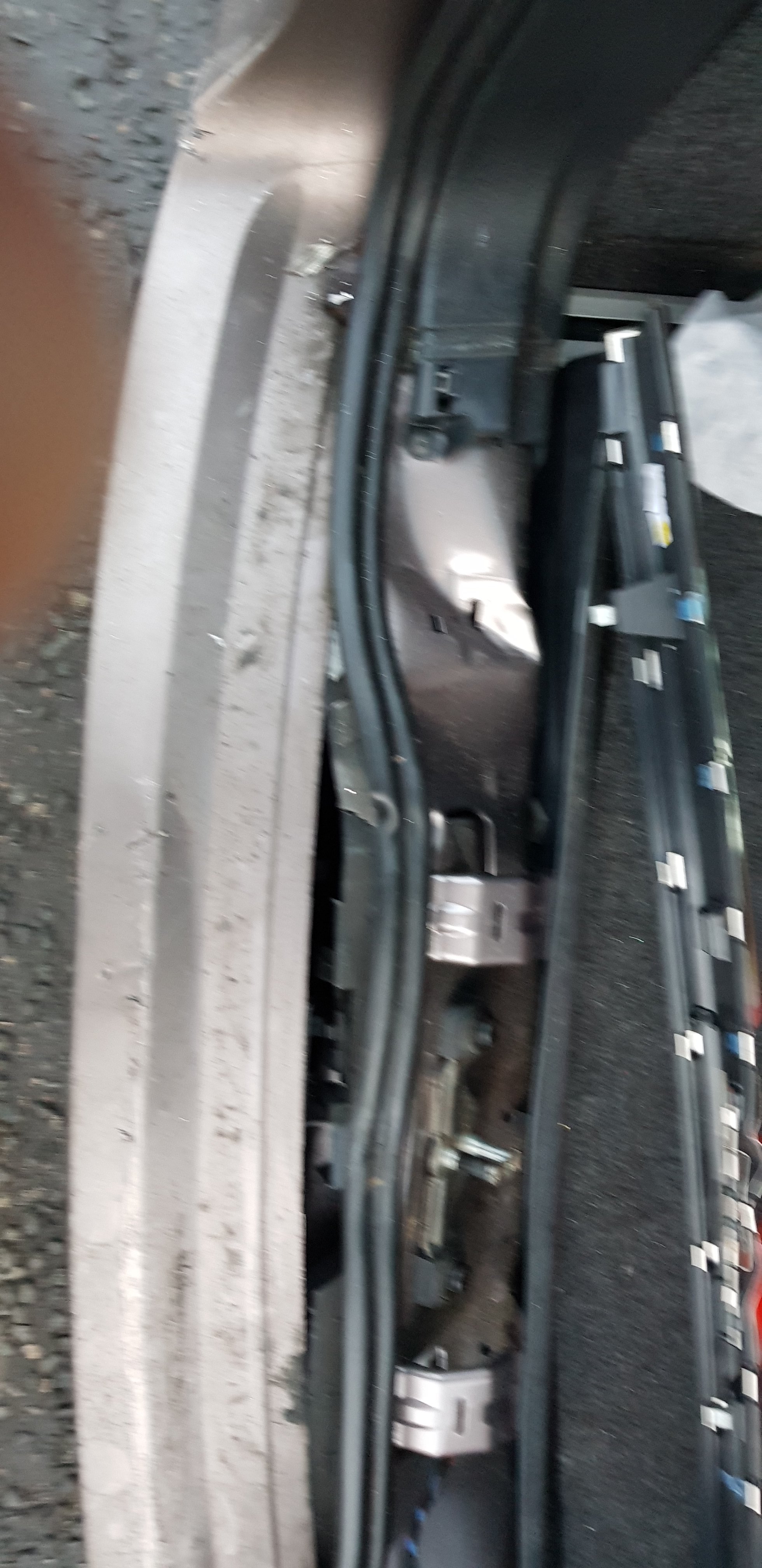

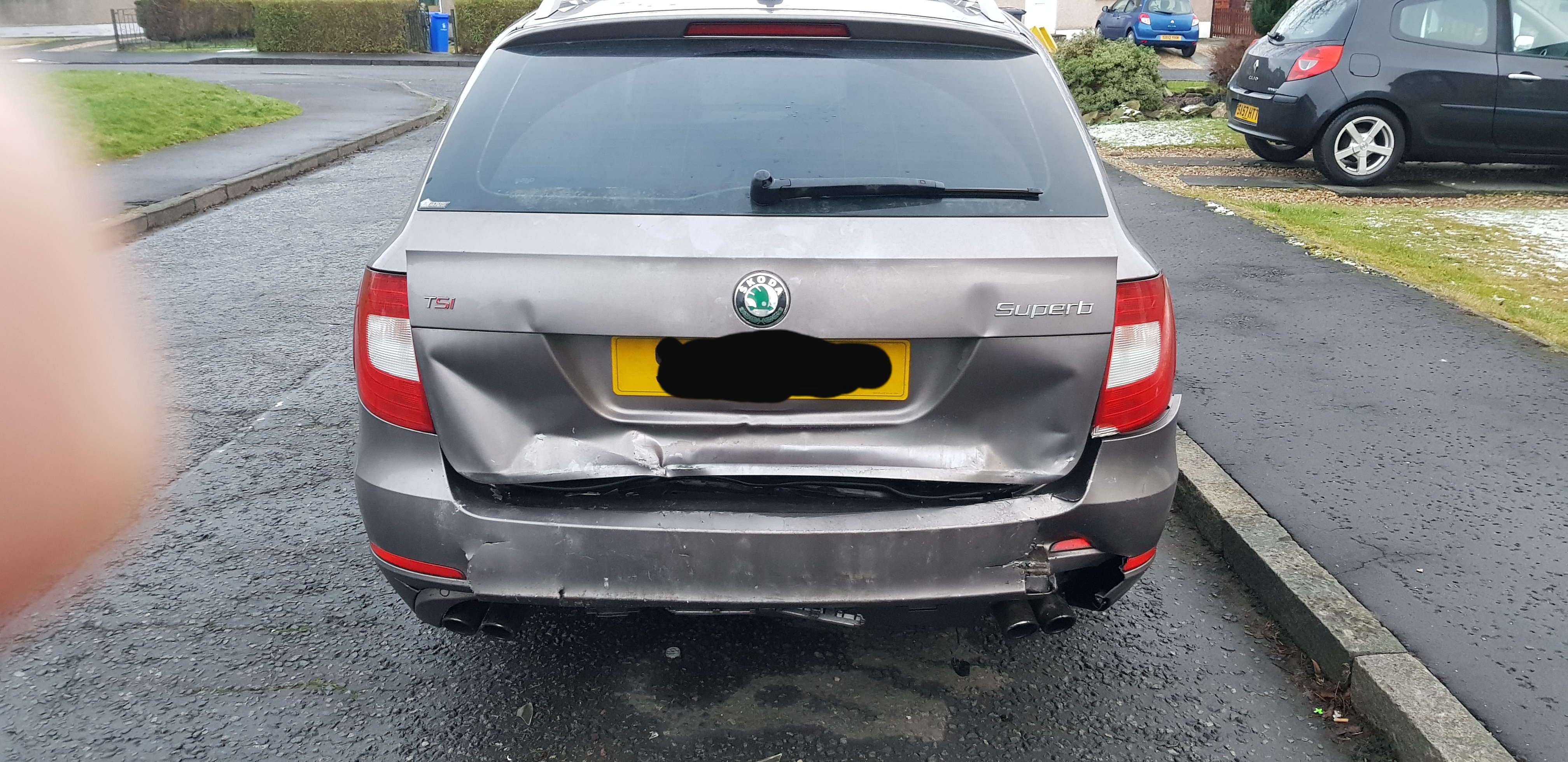

I got rear ended last week on motorway, insurance just confirmed its not economical  to repair:(.
They did however give a good price for me to keep the salvage.
As this looks to be a very rare car with lots of options im wondering if it's worth keeping to fix or sell on as damaged? Damage is classed as cat s , the panel behind the light inside boot is creased.

Pics

Check if any pyrotechnic devices have fired (airbags, seatbelt pretensioners, etc) - a VCDS scan will show this. When I crashed my first Superb (front end collision) the pyrotechnics alone added up to about €3k in replacement parts.
I don't know how it works in the UK, but here the insurance companies use a software package for working out repair cost that bases the repair on retail parts cost and book value for time. This inevitably prices the repair far above what it would actually cost to do it (which is why salvage companies buy Cat C/D writeoffs - there's enough margin to make money on repairing and selling it).
Find a competent repairer in your area and ask them to quote for the repair job and see where that leaves you. You may find that the bill will be smaller than the insurance payout.
It may not be an economical repair for the insurance company, but as already stated they will use brand new parts and be aiming for a repair standard to equal or better than before the collision.
If you know the cars history and had it not been written off you'd have kept it until it died, then I'd be buying if off the insurance company and getting it repaired locally.
You could even make some money out of the situation.
A good shout above though, check if the pre-tensioners on the seat belts have deployed. They sound expensive. Panels, plastics and paint should be relatively easy.
