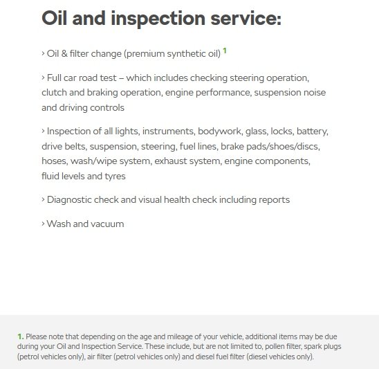

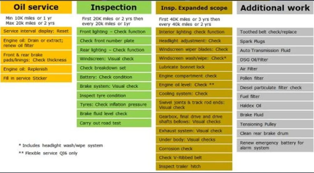

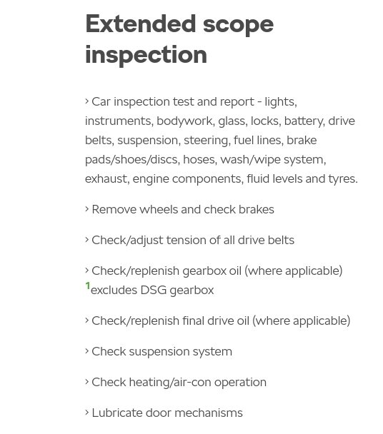

I've had an advisory that my sunroof is due for a service. L&K Kodiaq
@nigelrtaylorHave you asked them the price of them carrying out the sunroof service?
Maintenance is certainly required with sunroofs.
What are they saying about the AC, is that due a service as well @2 years, then the Oil & Inspection Service.
Could you service the sunroof yourself, maybe change the pollen filter as well and save yourself money?

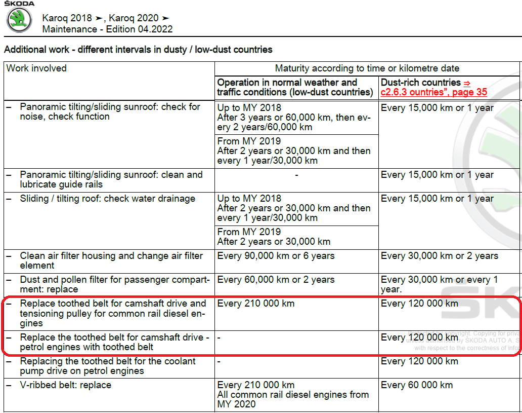

It is well past time that Main Dealerships were advising owners / keepers of Sun Roof Servicing.
They are usually trying to Up-sell on AC Services or Brakes which are supposedly 80% worn when not even 20% worn.
Karoq.
But as relevant for any model.
(Cambelt not so.)
