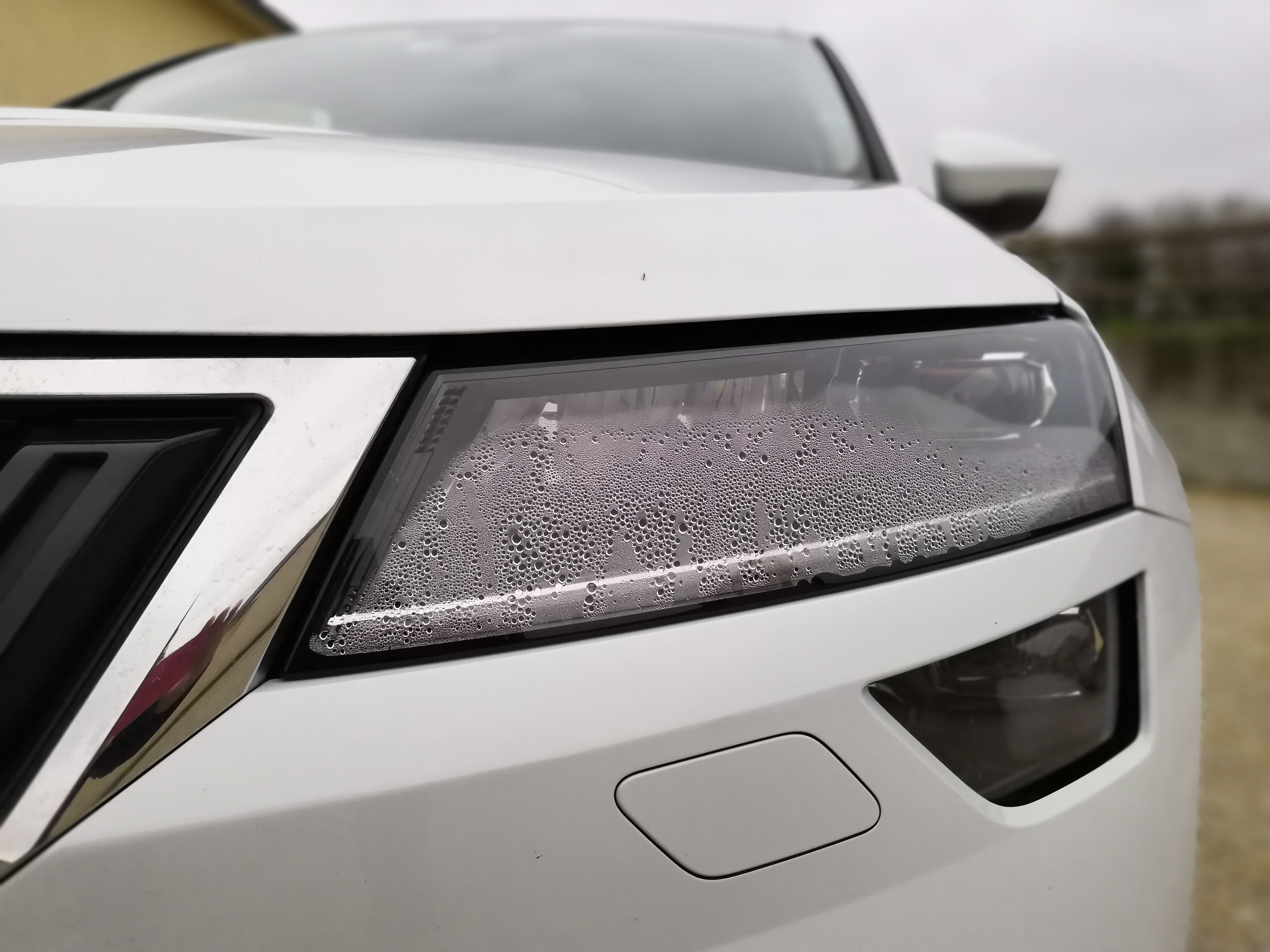

However, in the past few weeks, one of the "Full LED" headlamps became covered with water drops all over the inside of the outer protective plastic cover.  It never disappeared.  There was a lot of this water, so that the left hand headlamp blazed out a diffused but pretty useless light  - especially when we drove at night in the UK.  Looking for a cause, like a stone impact, I found cracks starting from the top outside of the headlamp and spreading into the centre of the part but there was no impact damage  Clearly there was a stress failure.  The other headlamp was clear ...but there, in the corresponding corner, were the start of small cracks.  I set up a visit to the dealer.
By the time I got to the dealer and to the person to whom my email had been directed, they must have had one or two other cars with the same issue because the tech manager had the papers already filled out and simply took a few photos before saying they would order lamps that day.  The entire headlamp units, that is.   The Lamp units took quite a few days to appear - from Czechoslovakia - but, two days ago, they replaced them, valetted the car and apologised for the inconvenience.   All of which was a bit different from one or two people's experiences in these pages, telling of dealers saying that folk should expect the lamps to evaporate any "condensation" and, essentially, to go away and not bother them.

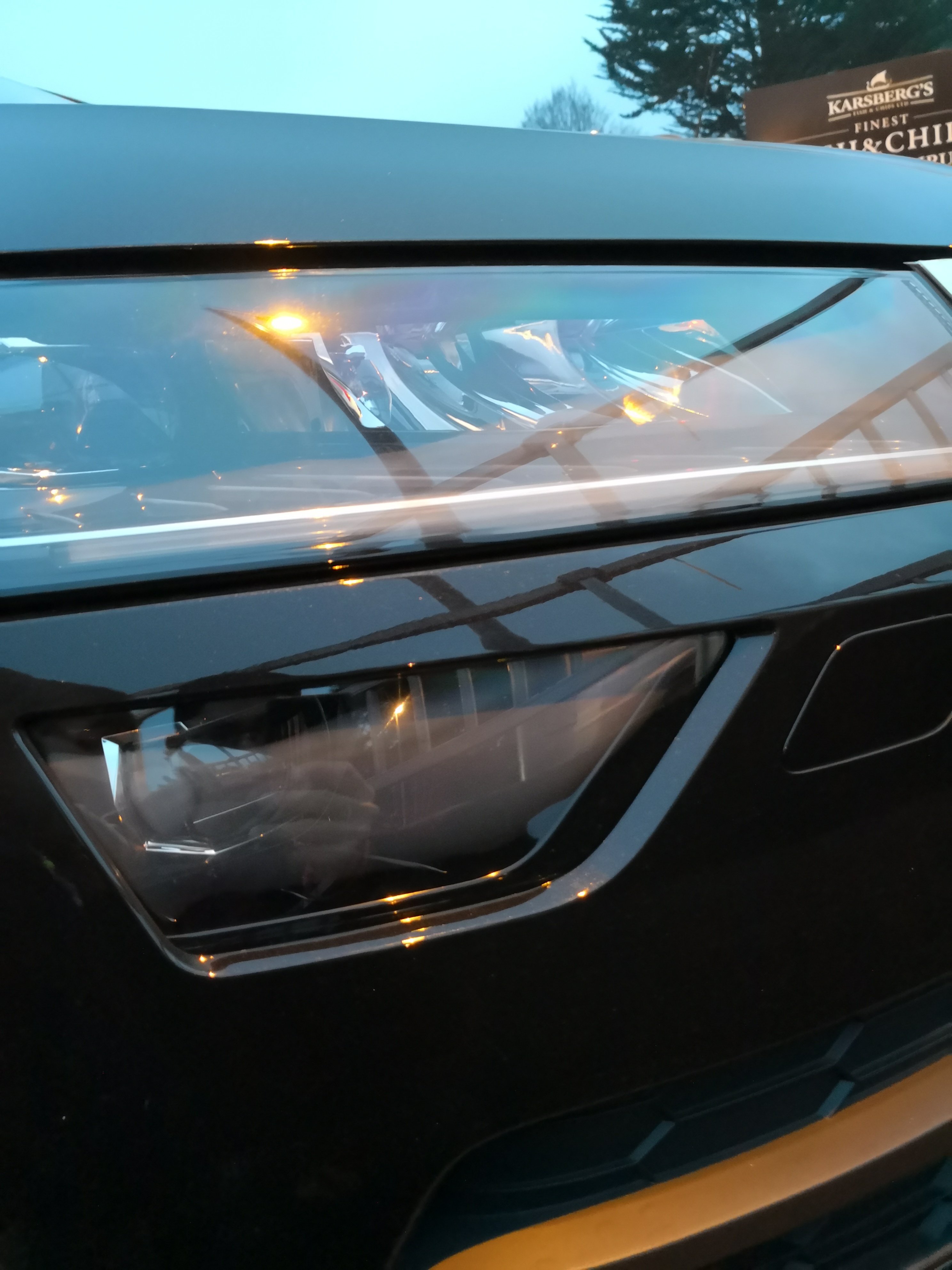

I noticed today my headlamps fog up. It cleared a bit while left parked up and then when I got back in and took it for another drive it came back. Both headlamps and fog lights are the same. Haven't noticed any cracks so possibly bad seals? But if it's happening to all of them it must mean most of the Karoqs are like that?
SP I imagine that some temporary fogging like on yours is expected and not indicative of a faulty seal. Unless the light unit was vacuum sealed it’s unavoidable surely?
The first photo in this this thread showed an unacceptable degree of condensate having formed whereas it is not particularly noticeable with yours. All cars be owned in the past, regardless of headlight type, have had some degree of transient fogging depending on environmental factors.

Hello, All.  Re "CONDENSATION" in our Karoqs...  I wrote my report on WATER in my left headlight because it was absolutely NOT condensation (which we've all had in the lights of previous cars and which the old, hot, bulbs got rid of after a bit) but great drops of water which did not diminish at all, no matter how long we drove or bumped over holes.  It never ran down the surface.  The inside of the lamp looked like someone had polished or greased the lens and then sprayed it with water.
The give-away was the 10 cm split and other small ones, starting from the outer top in the lens where Skoda confirmed the water entered.  I mentioned that the other headlamp had the beginning of the same stress cracking.  The Skoda guys approached the car to examine, it WITH THE LAMP-REPLACEMENT JOB ALREADY FILLED OUT on their pad, so clearly it's a bit of an epidemic.
I attached a photo in my topic in which the water shows.  It's thought that the water went in in storms, or car washes.

I appreciate your photo and that you’ve had your lens / unit replaced but what your photo showed was condensation. Heavy condensation, but condensation all the same.
Condensation IS WATER and you can see on your photo that in addition to large droplets of water, there is also a fogging effect, which is typical of the condensing process. Water vapour contacts the surface and condenses into a liquid. If it was just straight up water from a splash then it wouldn’t be up the lens like that it would be swilling about. The very fact that the cracks weren’t where the water was means that water has ingressed into the unit, turned to vapour and then condensed.
I do realise that for you it makes no difference because it’s wet and shouldn’t be in there but to capitalise that it was NOT condensation is simply inaccurate. Google image search “window condensation” and see for yourself. Images abound of condensation that looks nearly identical to what you had in your headlamp.

There are two separate causes here, but the symptoms are the same, they just differ in their severity.
The opening posters headlights have cracked, allowing in rain and road water. A clear manufacturing defect that is being rectified under warranty.
SizzlingPotato's headlights have the usual and regular moisture ingress, which is normal and explained in the owners manual.
Both issues are resulting in condensation, just of differing levels. A mist or fogging is acceptable. Droplets of water isn't.
