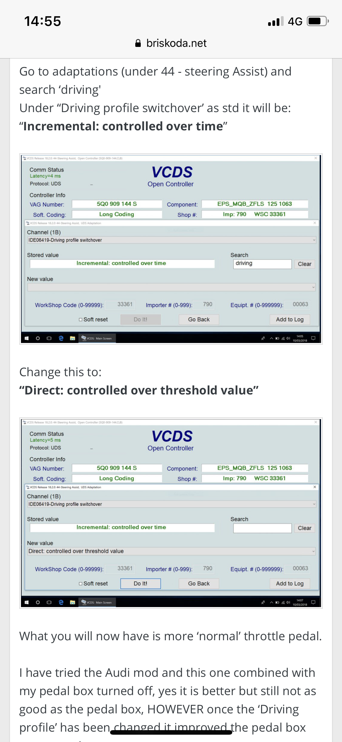

There is this one too
I have both applied to my 2.0tdi dsg and it's soooooo much better now. Not sure which had the most effect but the 'box holds gears much longer and is more sensitive to how hard to press the go pedal (progressively longer the more throttle you give).

I did this jut now (control over threshold) on my Octavia FL. 1.4 TSI. While indeed you a reduced lag, the car becomes a bit jerky. Did not really like it. I got use to the smoothness of the time increment and when I want the pedal to feel responsive I use SPORT from the driving mode button. And it’s better then this adaption.... just my thoughts...
