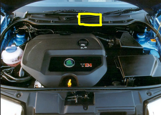

where is the location of the siren ?

I'm in this boat right now. Fairly easy to get to. You need to remove the wipers, the wiper cover panel, the plastic structural underpanel (egg-crate style) and it's then found just off-centre behind a black heavy metal shield that's riveted to the dashboard cowl panel.
I had to pull out the shield a bit to allow me to slide out the alarm.
